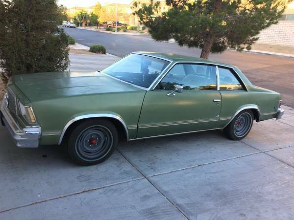

This is a '79 Malibu. It spent it's entire life in the California desert and Las Vegas. It has a 305 v8, & auto. 63k original miles. Factory AC, Power steering, power brakes, All original paint and original interior. It is still in Las Vegas, so I haven't seen it yet. A friend checked it out and bought it for me. He did give it a thorough "test drive" as seen below. It is parked at his house until we figure out how to get it home.

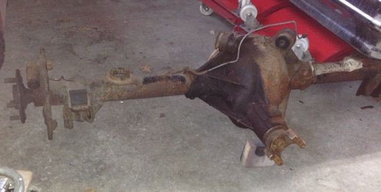

I rebuilt the front suspension using S-10 Blazer spindles and brakes. I cleaned up the rear suspension and installed an 8.5” 3.70:1 posi from a Buick National

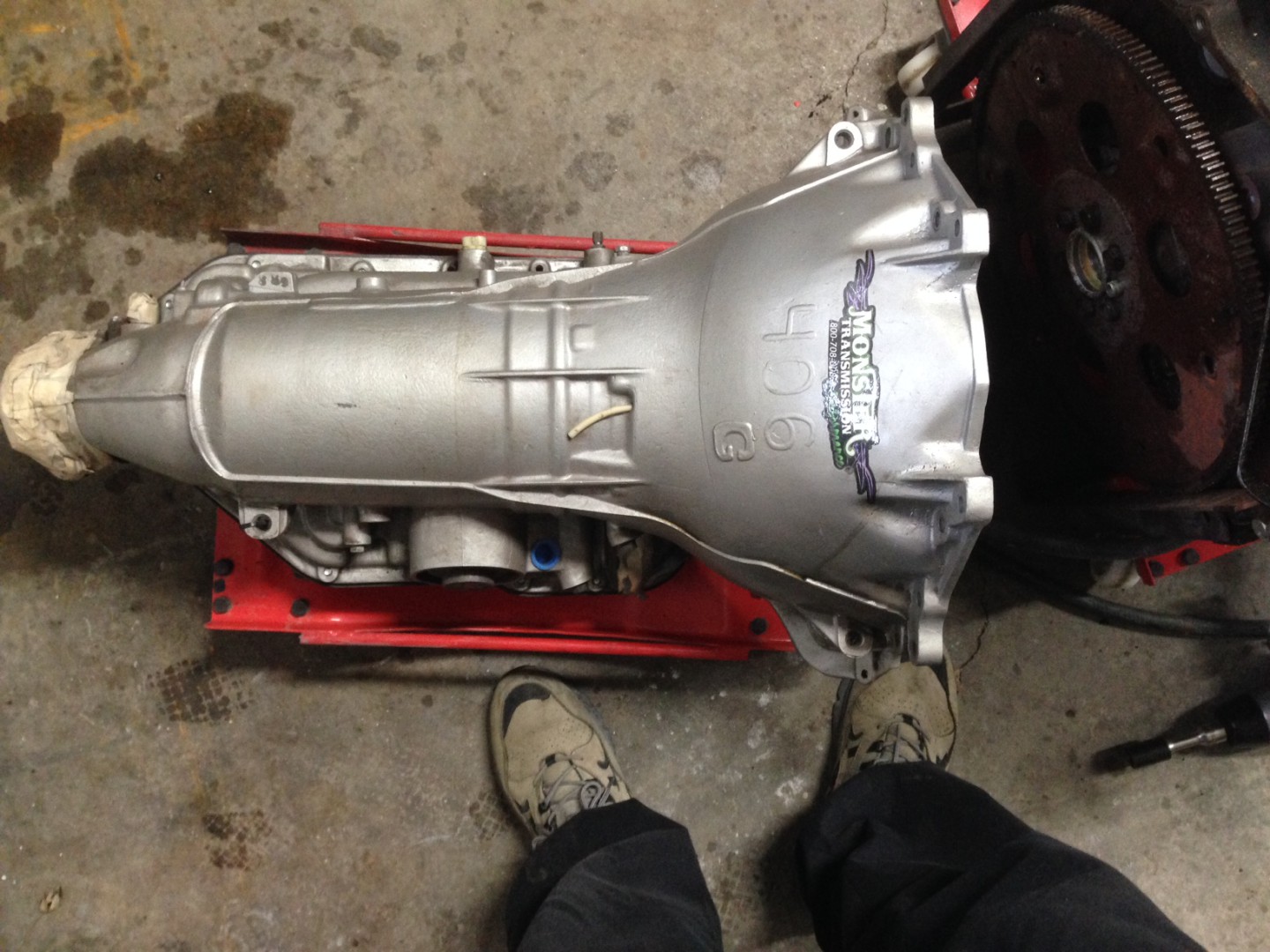

I bought a used Monster Transmission 22 4R and lock-up torque convertor with a 2500 RPM stall speed.

Rear end option
https://gbodyforum.com/threads/8-8-in-a-g-body-pretty-much-step-by-step-enjoy.17317/

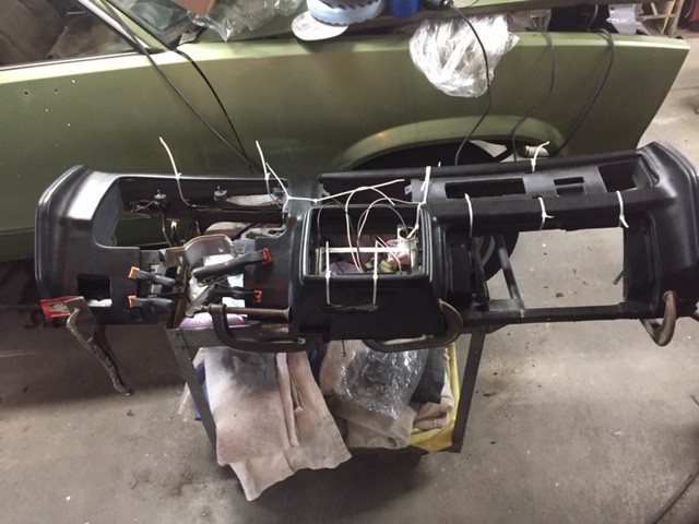

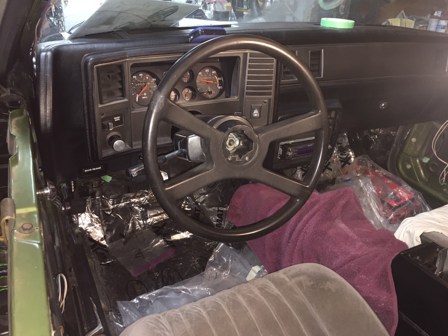

My dash was the standard “idiot light” one. Since I didn’t want to stick a gauge pod under the dash, I bought a complete Monte Carlo SS dash. I bought a dash cap and slipped it in place. And took it off and trimmed and sanded and heated and molded for hours to get it to fit. When I glued it on, I used just about every clamp I own, along with countless zip-ties, and got it to fit pretty well. For some reason, GM changed the pins between lights and gauges, so I had to move a bunch of wires in the connector. While I was doing all that, I cleaned and painted everything. The dash had been cut to install a radio, so I had to replace some metal. I think it is done now.

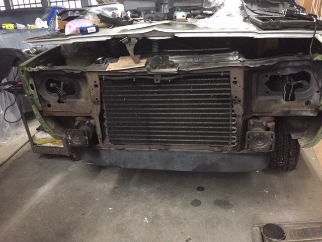

Since I wasn’t getting around very well, I put a stool in front of the car and started disassembling, cleaning, and repairing damage. The header panel was pretty nice, but had a few cracks, so out came the die grinder and JB Weld. I coiled up the wiring and cables, and tied them out of the way. Pretty soon the fenders were off, and the inner panels cleaned. I cleaned and painted the frame and firewall. I found cracks in the A/C housing, which I fixed. I used a lot of JB-Weld

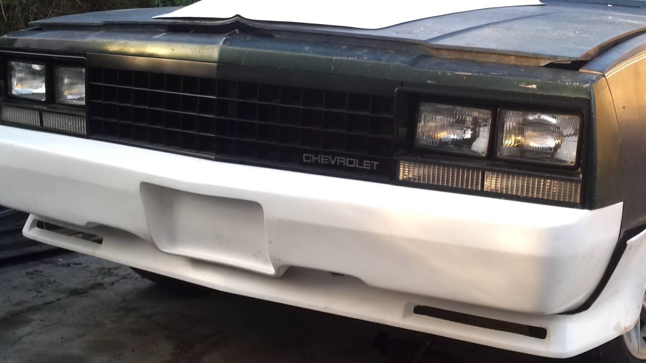

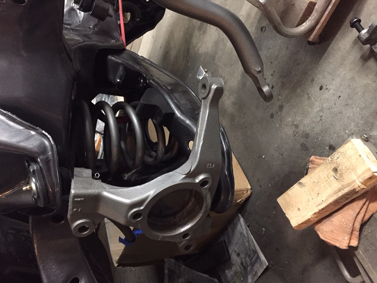

These are not bad looking cars except the bumpers and door handles. I bought fiberglass bumpers that match the fenders. They only come with mounts on the ends, so I will have to build structure under it. This is from the internet since I forgot to take pictures of mine. About all I can do with the door handles is sand them down so they don’t stick out so far. Enough of the mechanism is pot metal that it would take someone much more skilled than I am to re-make them.
