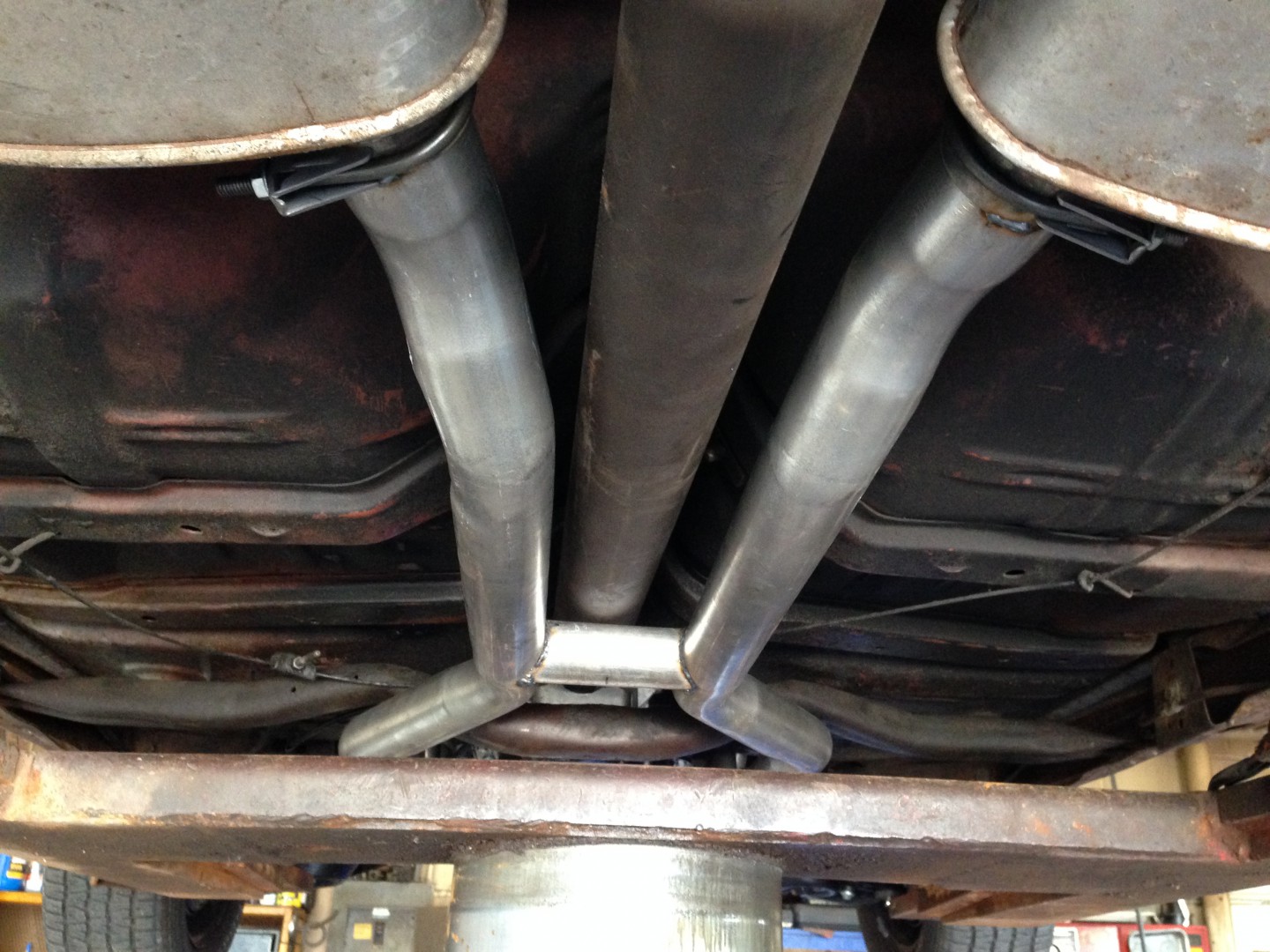

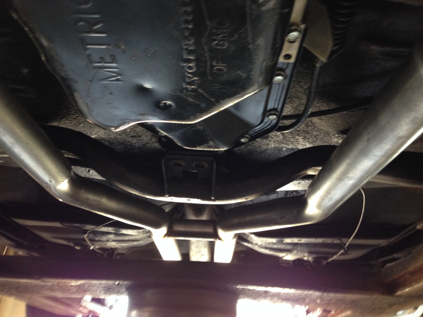

Moving the cross member back for Mikes transmission swapped caused the exhaust to not fit. So had to do some of my best exhaust work ever to make it fit. Thought this was worth posting a picture to get a laugh out of it.
Well, it gets the fumes out the back until he can get it to an exhaust shop...
Got the exhaust redone at Scott's Muffler and Welding in Pine City. Took the interstate their and back. Liking the OD. 2400 RPM at 70MPH. 200 RPM more for each 5MPH more up to 3000 at 80. Kicks down at 75.
I have a 10" Art Carr non-lockup torque convertor, 3.73 gears and 28" tall tires.
If you don't mind my asking, what did that cost ? I got a royal "lesson" at Bee Line in Forest Lake on the '38 a while back...
Won't be going back there for exhaust work.
Also, you are missing the link from the crossmember on the right side to the e-brake cable.
Welcome to the 200-4R club Mike. You'll never look back!
The two 2.5" pipes and H crossover from
mufflers to headers cost $210.
Thanks, that's about average.
