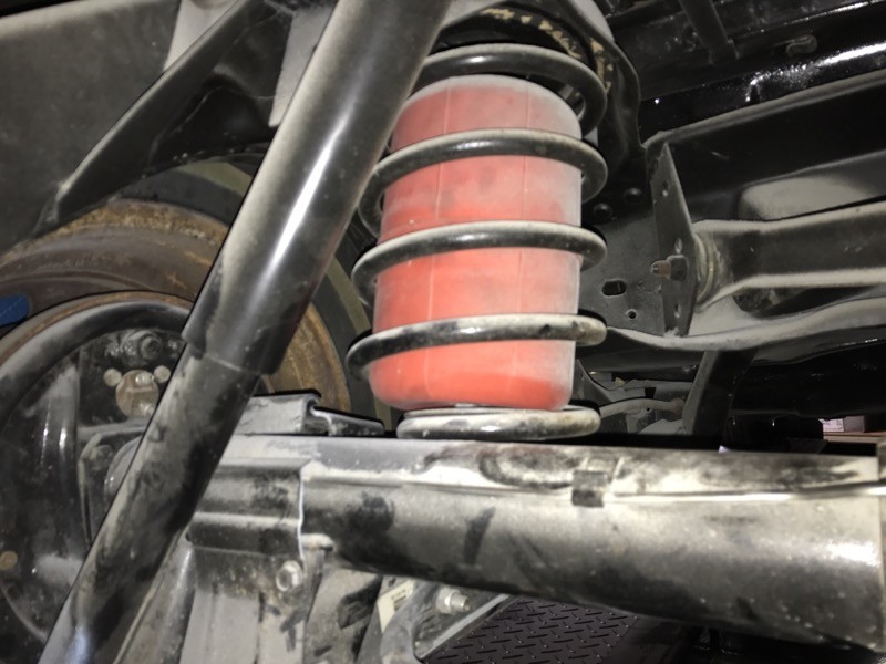

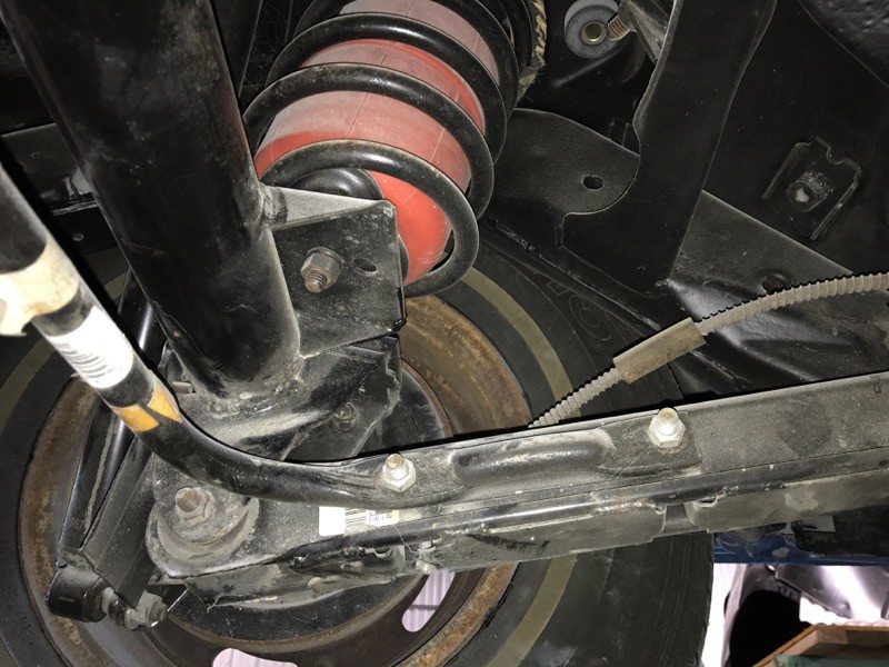

Have you though of getting a pair of Air Lift bags to put inside rear coils?
I bought a set for the Blue elky, as I am adding some weight in smugglers box.
Individual filler stems, just like tires, would work well for elevation and side to side leveling.
Have no idea how they might affect ride, however, I am adding weight.
Just a thought.
Domthing like this Karl?

Yes, but DON'T BUY ANYTHING from those people. They don't stock the parts and once they have your money, they start sending email notifications that it will takes weeks longer to get the part. I went thru this a few weeks back with them and finally was able to get my money back but will NEVER do business with them again.
Jegs and Summit both sell the air bags too and will match Auto Anythings price. Summit did on the gauges I initially ordered from AA.

I still have the box, somewhere!
https://www.summitracing.com/parts/hss-31750/overview/year/1966/make/chevrolet/model/chevelle

These guys look good, suppose to arrive in 3 days. Free Ship
Looks like them!
Kinda dusty under there.
Car was torn apart 22 years ago in February, I am very methodical in my efforts!
Wish there were black. Isn't there a plate that sits on the bottom so the bag doesn't ride on the bolt head and spring clip?
Bolt is recessed into cup.
Bag is really thick material.
Fill is on top.
Come on up someday, take a closer look.
