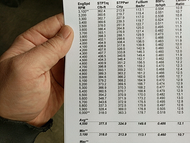

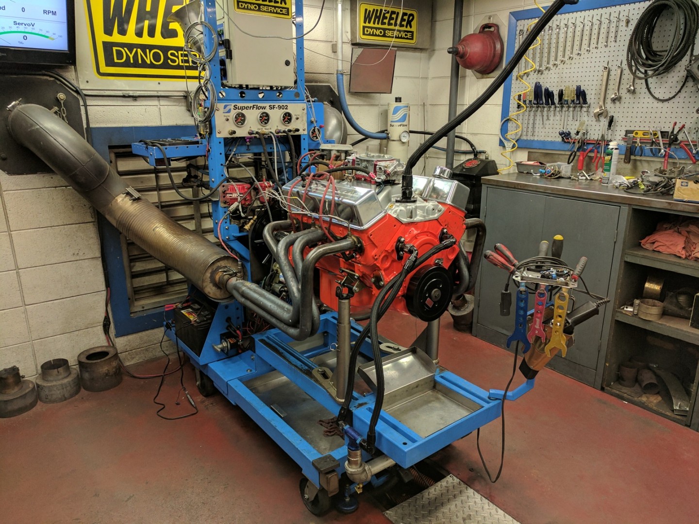

Went to Wheeler today and ran my engine on the dyno. Went well nothing came apart and made decent numbers. Was hoping for a little more HP but the torque was where I wanted and that will make it a nice street engine. Here are a couple pictures, I'll try and post the video in a bit.

That's almost identical to the vortec headed crate 350 you built for me that went into the convertible, other than the peak hp/tq rpm was a couple hundred rpm higher on mine. This should be a strong little engine on the street, with plenty of fun.
What carb size did they use on the dyno? Another 600 cfm?

Used a 650 that I had which made 10 hp less on the top end but same torque. Using dyno shop 750 it made the 375.

Nothing wrong with those numbers. Should be fun on the street.

Great torque numbers. Especially for a street engine.
