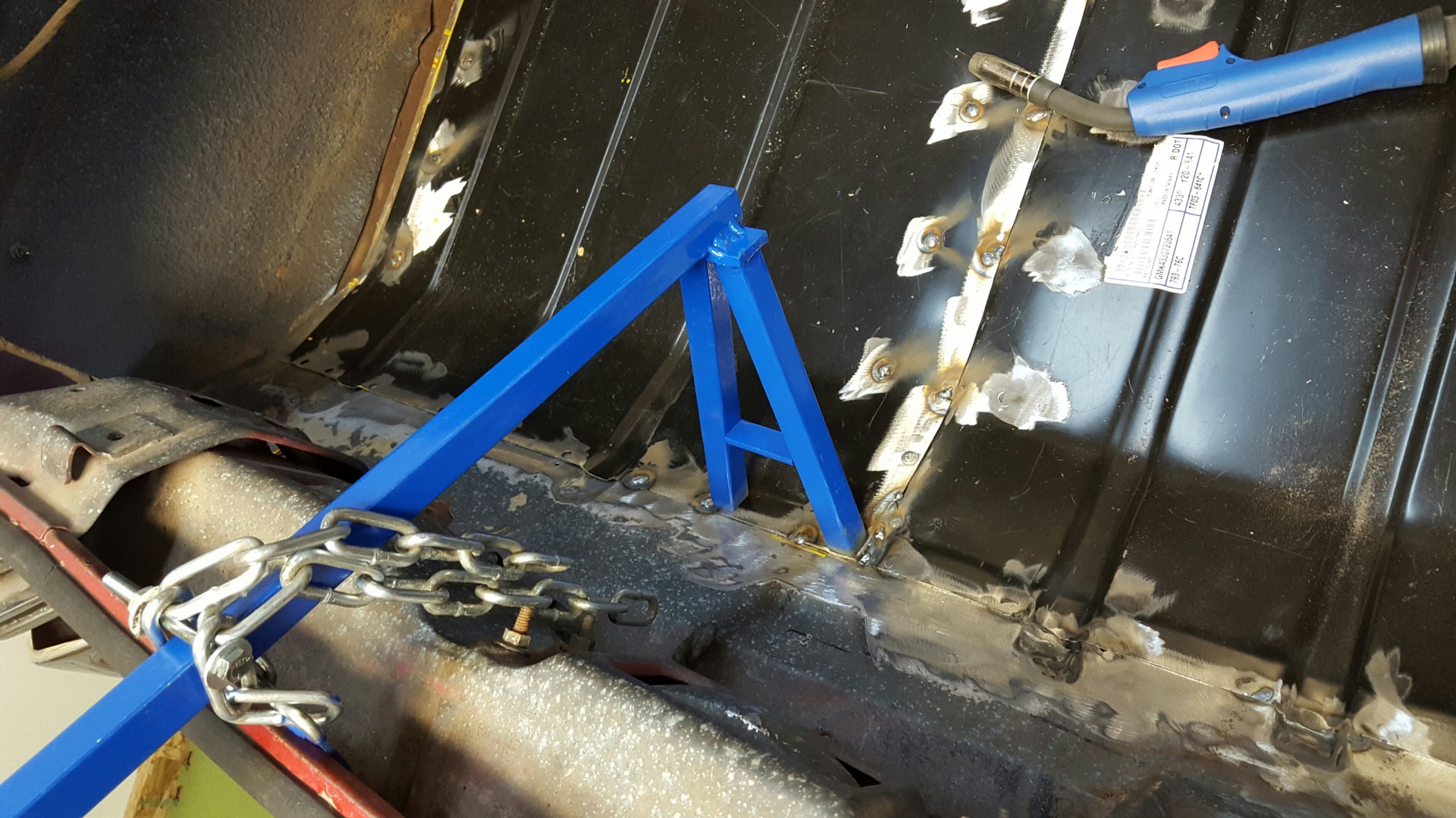

I've made another handy tool. For use when installing panels that need just a bit more force to bring together before screwing or welding. A pry bar of sorts* with a chain that can be set anywhere on the bar for leverage. For use in the trunk I manufactured a J hook that fastens to the trunk lid ledge. For use on floor pans I bolt the chain to the seat belt retainer nuts. Anywhere else you can usually find a 5/16" nut.
*Requires an assistant not included with tool.

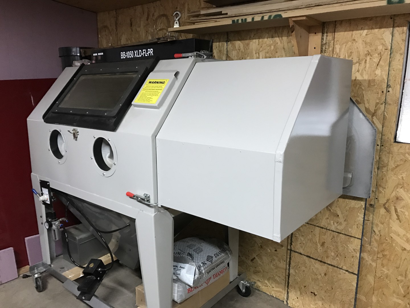

I need my blast cabinet to hold longer pieces so I'm building this two foot extension. I will be able to install and remove it quickly, it is held in place with four bolts and weights less than 20 lbs, when not in use it will stow on top of the cabinet.

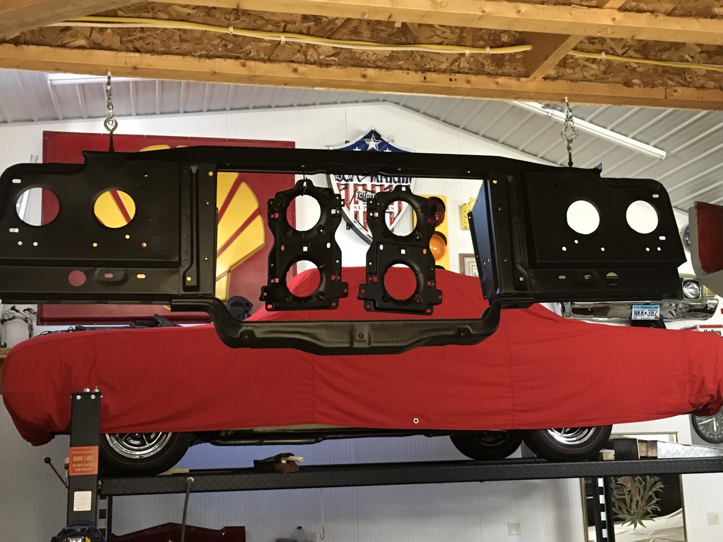

When complete I'll be able to blast a core support in it.
I'll work on the sheet metal tomorrow.

Remember the bend radius formula? One 90* and two 45* bends and the shell fits like a glove. Going to keep the door simple, just a cover like cap and bunggy cord. The floor is cut, I'll install it this week and I'm ready for blasting.

The blast cabinet is done and has been in use for some time, my core support is done. It works well and removes and stows easley after use.
