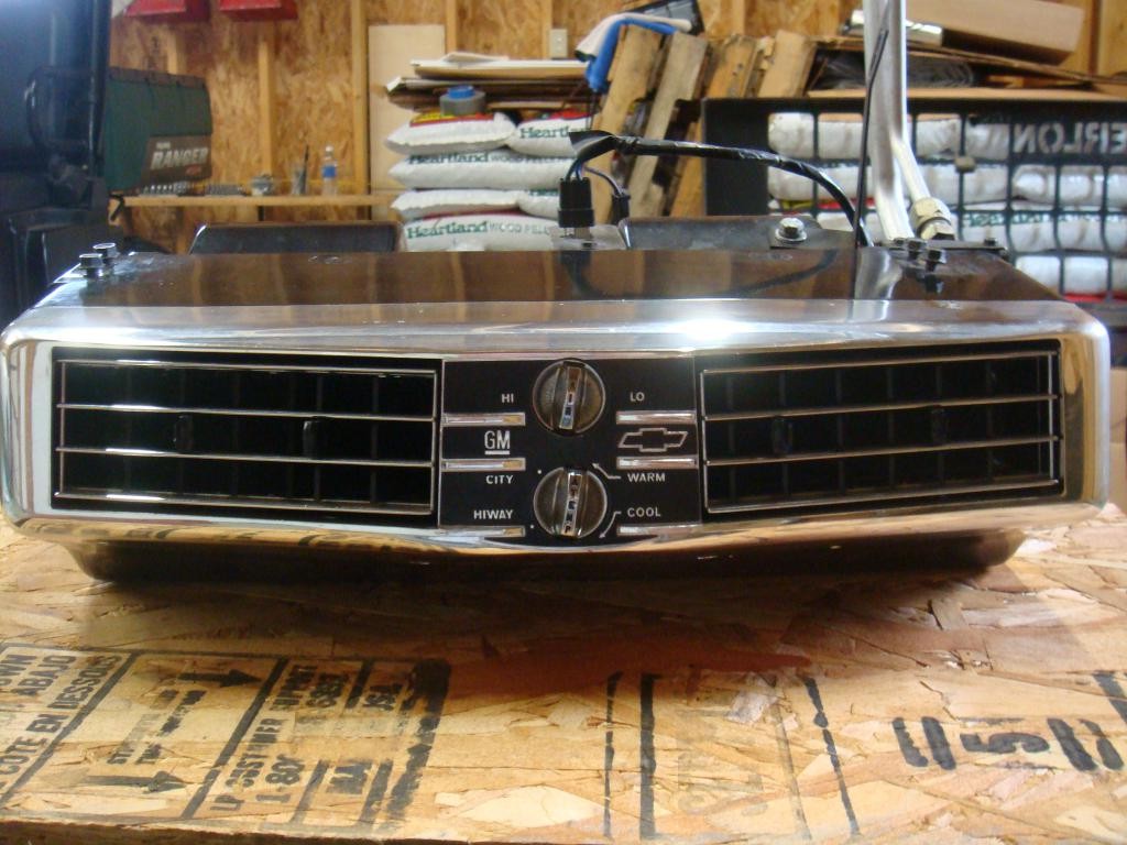

Thanks Bob, Not in a hurry, Thinking of a winter project and would like all the help I can get. I just got the under dash unit, etc yesterday. The compressor is a rebuild, the rear part has the casting number for a sixties corvette/camaro 6555302; but I think they used a center section from some mystery piece as the bolt holes for mounting on the front seem to be metric. I would like to use an original A6 unit designed for the chevelle; but who knows if I can fine one. The condenser is also odd as it appears to be for a later unit where the exits are on the top pass side, the 66 chevelle condenser has outlets on the top and rear, I think. I think it would be very similar to your 66 Impala. Do you have any photos of that unit you could share?

Well I just wanted to see how the unit fit and looked in the car.
Apparently it is for a car without a console.

Evidently my research was not good enough. I believe it is for 67-72 and thought it would work in a 66; but I guess without a console.
