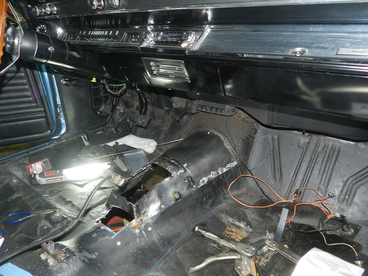

So it is. The photos that he sent me of the 6 speed installed are below. The sales rep (and they NEVER lie) tells me that the shifter pops out in exactly the right place for the console, and that the console will sit on the hump with little or no modification. Looking at the photos, that appears to be at least possible as most of that console is behind the shifter. I guess I'm going to find out. I have a repro console, so if there is a little grinding to do here or there it isn't the end of the world.

The pictures look like a 5 speed.

Hurst provides the tin and a template, but they do tell you that you have to cut and add material. Not such a big deal as I just did the floor pans, I don't really mind the cut and patch program as long as the fit is guaranteed. Everyone's complaint about this project is the tunnel mods, which seem to me like the easiest part of the job. I'd much rather cut and weld tin than crawl around on a cold concrete floor with a 150 pound transmission on my chest.
Those could be pics of a 5-speed, I don't know - they're the ones that the rep sent to gaue the amount of chop-and-weld that needs to happen to make the install work. He assured me that the factory console would fit - like I say, I guess I'm gonna find out. To my eye, at least the passenger side in the shifter area is not going to fit if the mods are like those in the photos.
