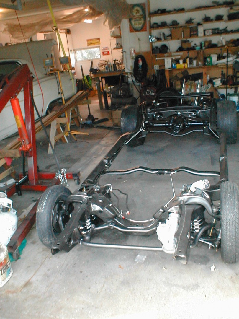

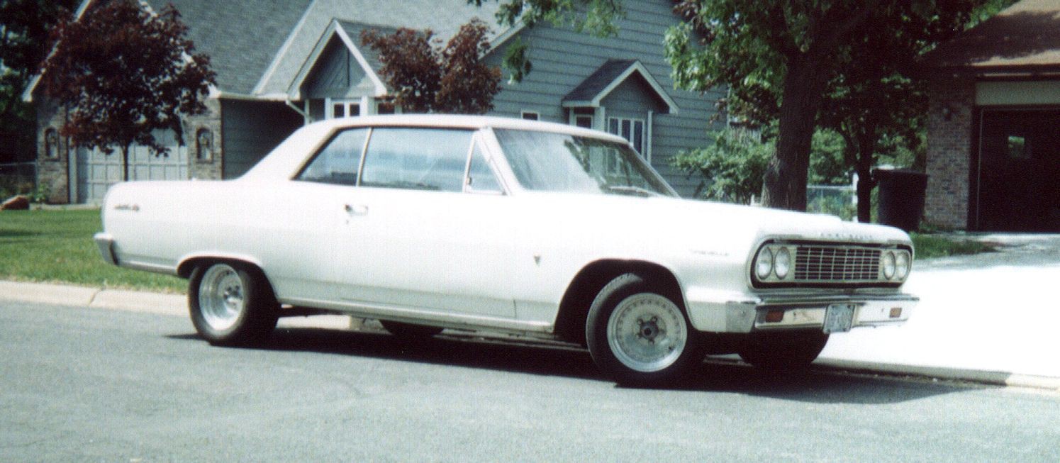

This is the beginning of the story of building my 64 Malibu SS. I bought it in 1998 and worked on it a bit for a couple years, then put it away. I am now able to work a little harder, so am making progress.

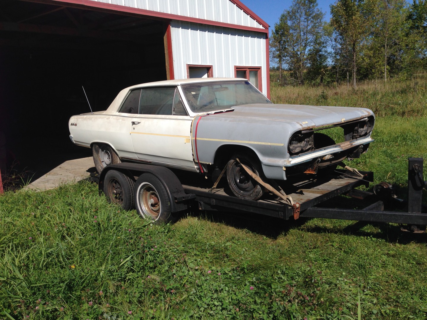

I bought my Chevelle in 1998.It was a California desert car so had no rust.It had only a few door dings and no sign of having been hit and fixed in the past.It did have a bad enamel paint job.It leaked every kind of fluid.I wasn’t sure I wanted to drive it, so part of the deal was that the owner had to deliver it.
When I got it home, I drove it around the block a few times, and tried my best to get the tires to spin even a little bit.Then I took the body off.The frame has scratches on it from the dies when it was formed.I had it sandblasted, painted it, and added dropped front spindles, slightly stiffer springs, and big roll bars.

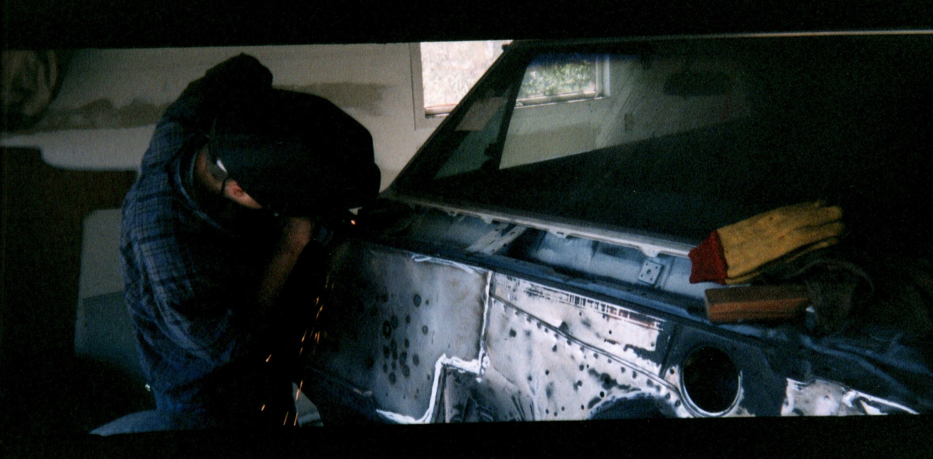

After putting the body back on the frame, we cut out the A/C firewall, and welded in smooth sheet metal.In this case the “we” is my son-in-law Jason.

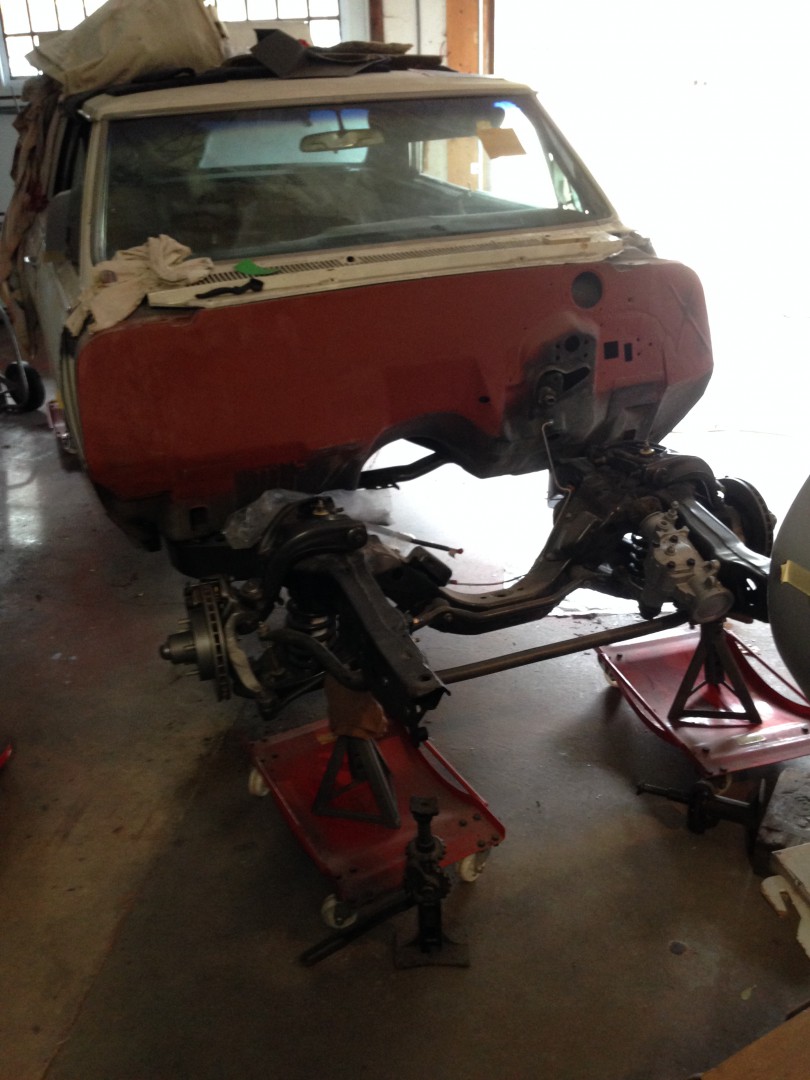

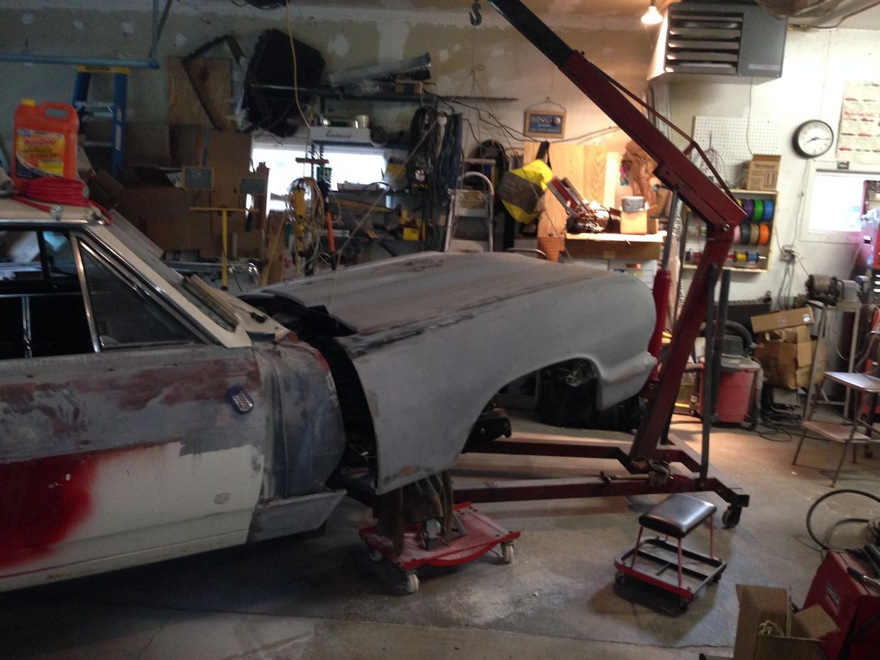

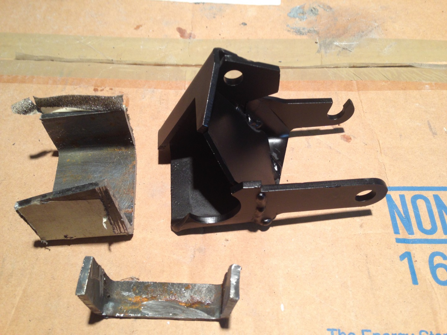

Then I made the mounts for the bottoms of the fenders.This is an “in progress” picture, followed by the finished piece.

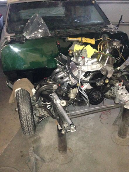

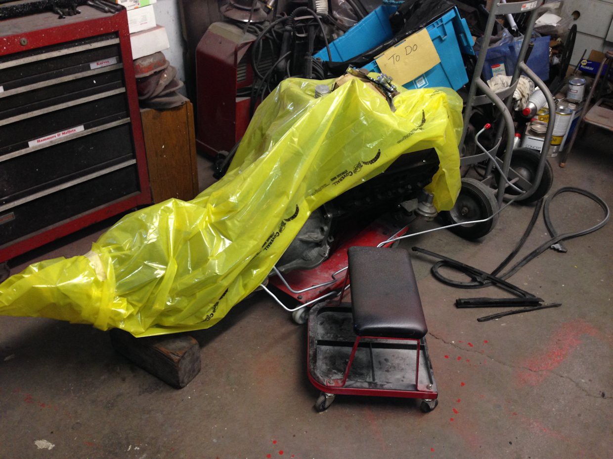

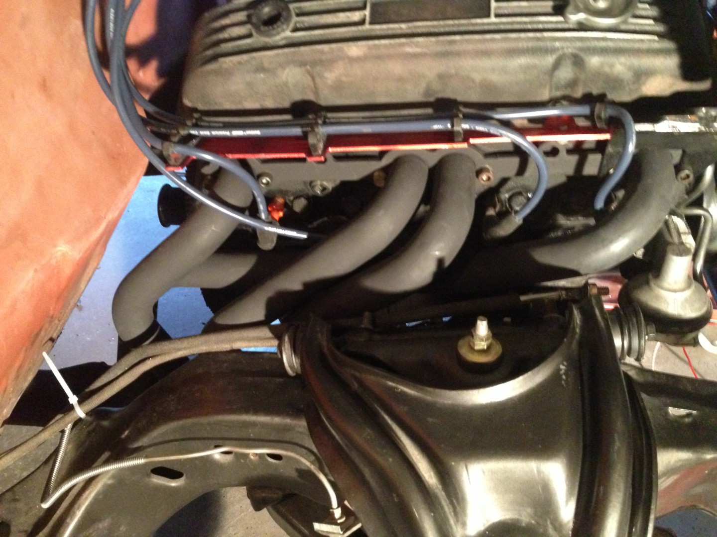

I thought it would be a good idea to install the engine just to confirm everything fit.I am using an engine out of a ’77 Corvette that we bought for parts.Before we took it apart, we squirted gas in the carb and ran it for a few seconds.It should run well enough for shakedown.First I had to clean it.I used two cans of engine degreaser, then a quart of lacquer thinner and a scrub brush to get it clean enough to spray it spray-can black.In hindsight, I should have used a lighter color, because everything kind of disappears in the black.
Now it should just bolt together, right?Wrong!The headers I thought were Chevelle were actually Corvette, so I ordered a new set.A Corvette power steering pump mount fit the engine, but not in the car.So I bought a set of correct Chevelle mount brackets.I have a later model steering gear box, so the Chevelle mount didn’t work either.I ended up taking 2 ¾ inches out of the middle of the bracket.Now it fits, although it doesn’t have a lot of adjustability.I will have to find exactly the right size belt.

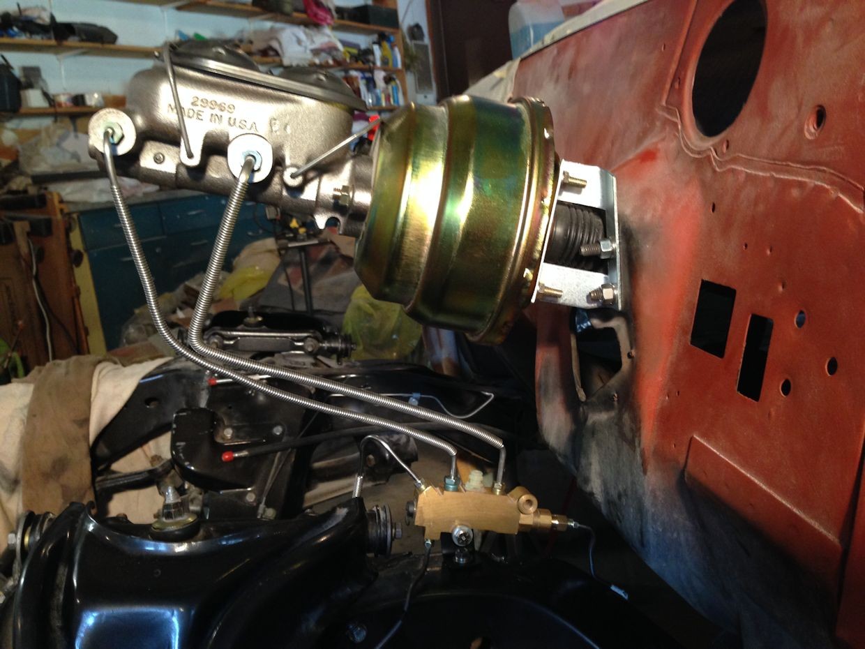

I also made brackets to mount the radiator.It needs to stand by itself as the core support tilts away from it.I started with a ’70 Corvette radiator, which exactly fits between the tilt actuator, and between the frame and hood.I had the drain moved and a different outlet installed.Twin Flex-a-Lite fans exactly cover the core, and bolt on to the reinforcements across the top and bottom of the radiator.
It appears the PS belt is touching the steering gear. I looked at Allan Grove and they have a set-up that may move the pump closer to the balancer for more clearance with the gear. The link is to a re-seller with a dimensional pic to measure yours and see if it would help. The part is less expensive from other sources.
I have Allan Grove brackets for all the accessories on my '38 and they are well built.
May 7, 2016
That picture was with a belt that is too long. With the correct belt, there is about 1/2" clearance. The link you posted is for long water pump, and I have short.
Thanks
May 7, 2016
OK, I wasn't sure which pump set-up you were running. The one pic I saw of the engine had a long pump on it. They have brackets for short too, but if you can get it to work as is, all the better.

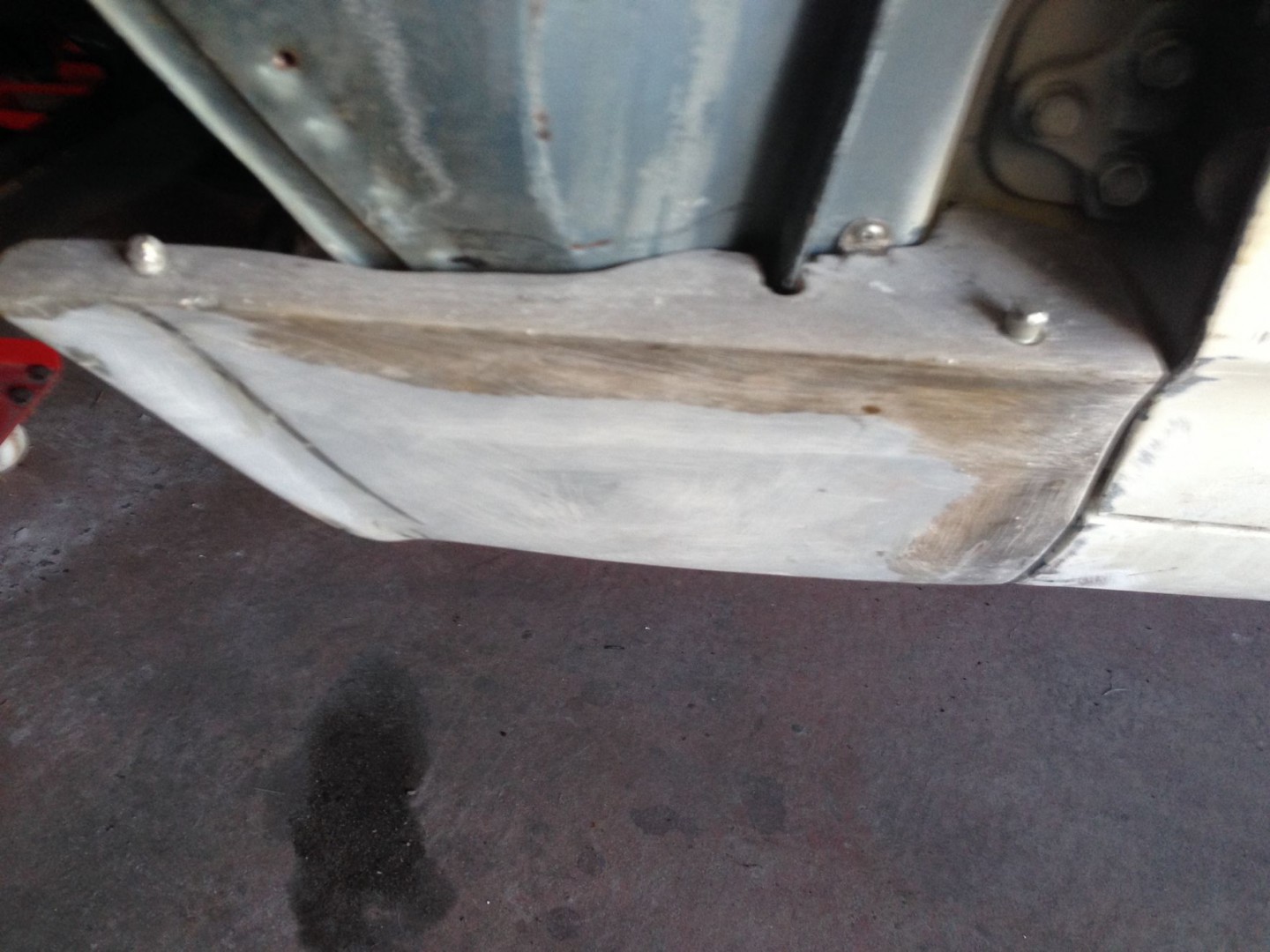

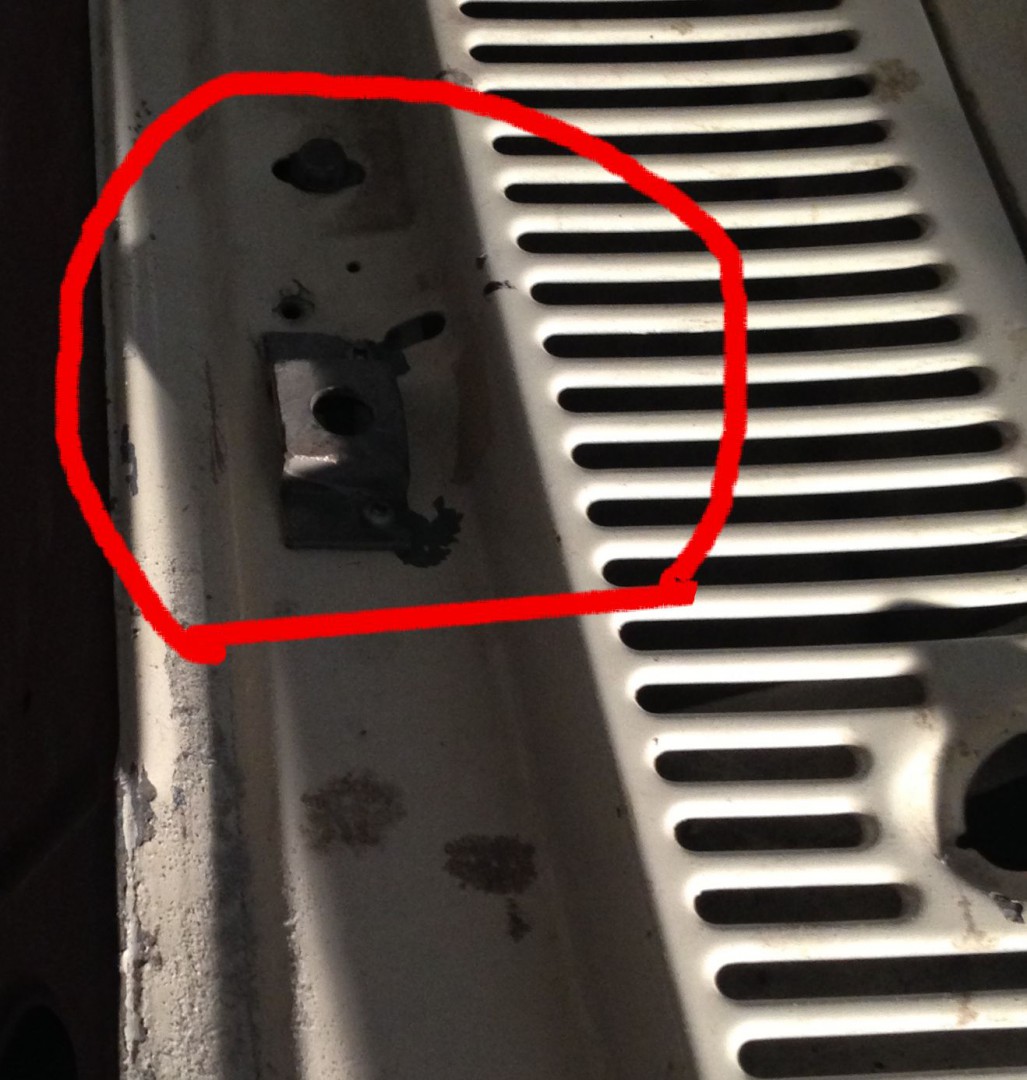

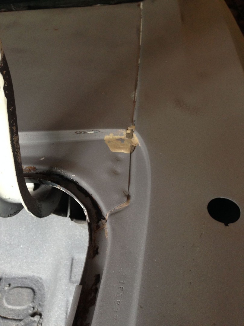

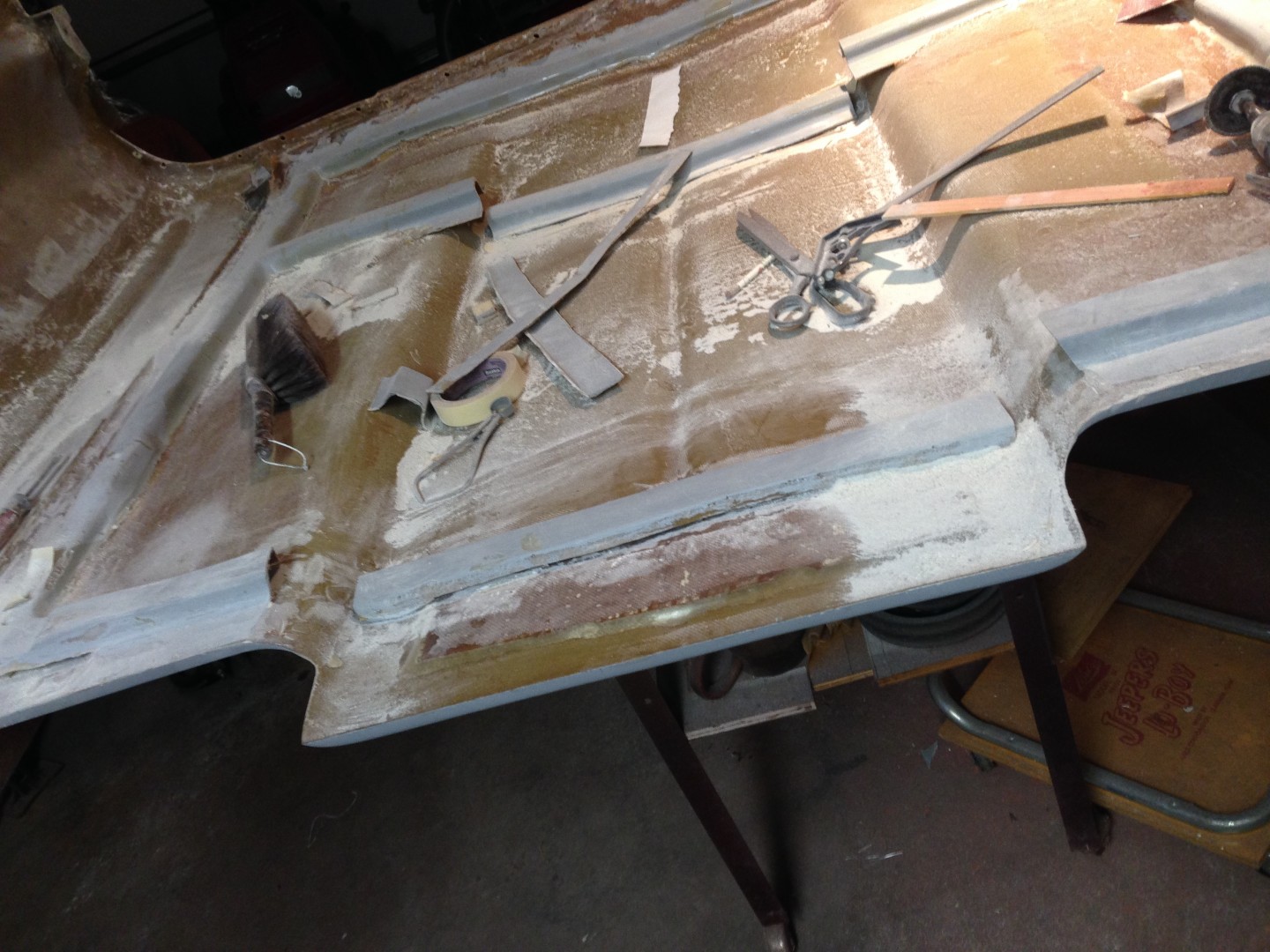

There were alignment notches where the body joins the firewall that catch the fiberglass when the front opens.While I am certainly not up to Mitch’s ability, I did manage to weld in patches.

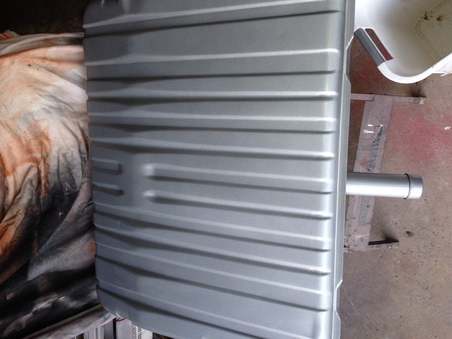

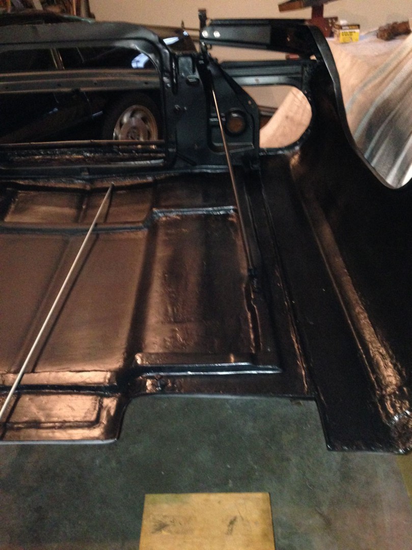

When I needed a break from applying and sanding fiberglass, I cleaned and painted the trunk.
And filled it with parts ready for final assembly.And a trunk mounted battery box, which so far is just sitting there.

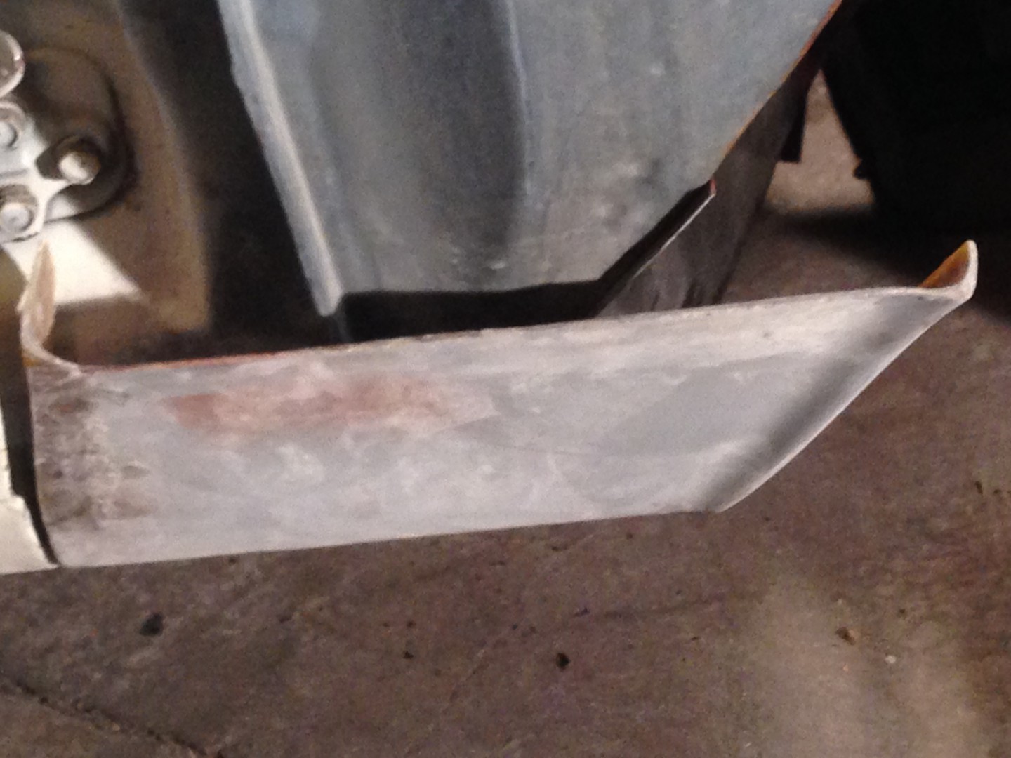

The last brackets are made for the bottoms of the front fenders to attach to the body.Then I just have to get everything to fit just right before removing the front to work on the firewall and engine wiring and accessories.

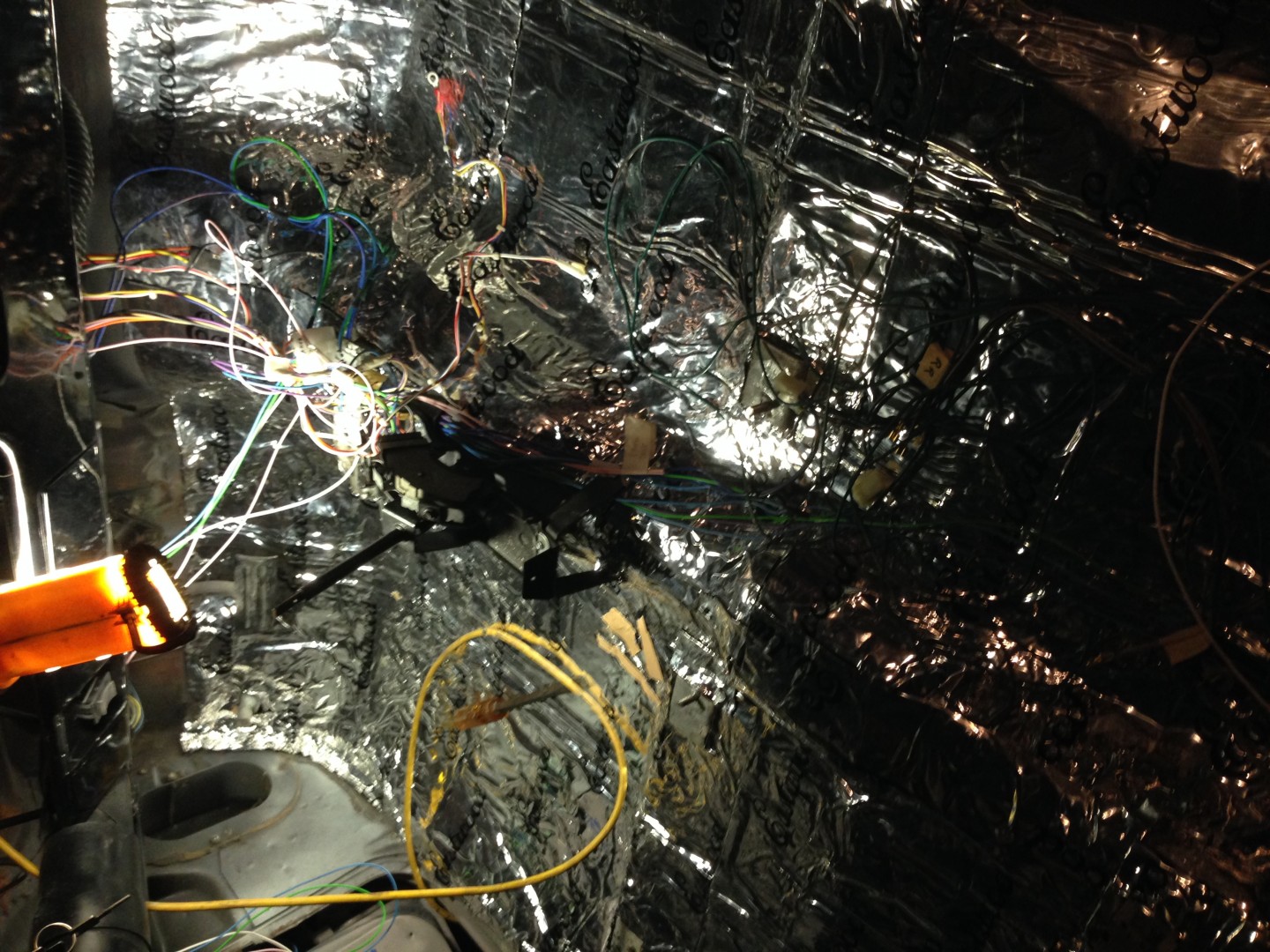

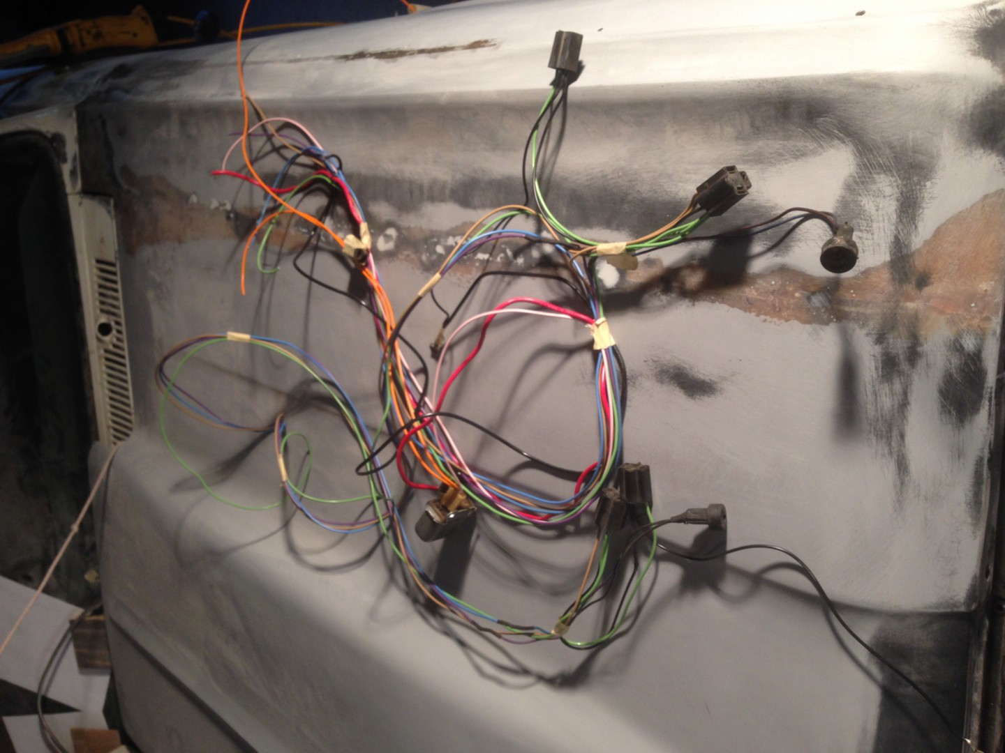

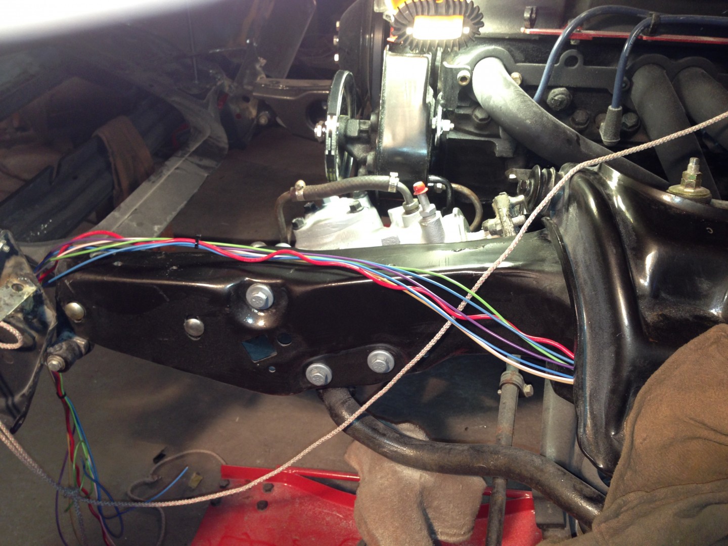

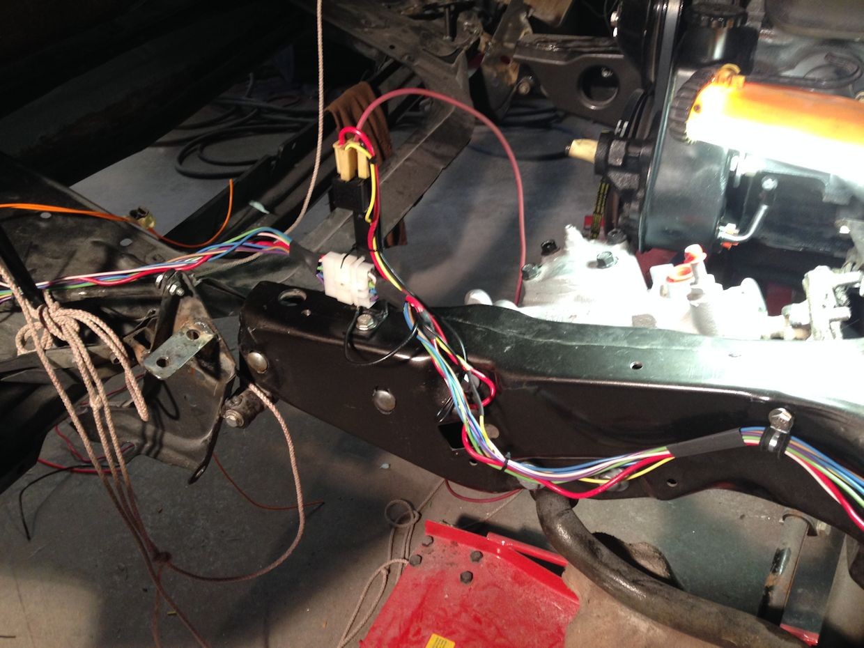

In anticipation of rewiring most of the car, I bought an assortment of wires.Then I made a new front lighting harness.It is much like the original except for later wiring colors and a quick disconnect.The wires need to be much longer from the firewall to the core support because they used to run down the inner fender, and now they will go down to the frame and forward to the disconnect, then up to where they used to run.I can’t remember where the horns mount so I will have to find a place where they are not in the way of the actuators or the wider radiator.When I finalize all of that, I will wrap everything in original black wrap.

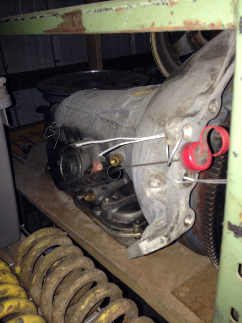

I found a TH200-R4 on a shelf in a pole barn. And then spent more than I paid for the transmission buying everything needed to make it work in an old car.

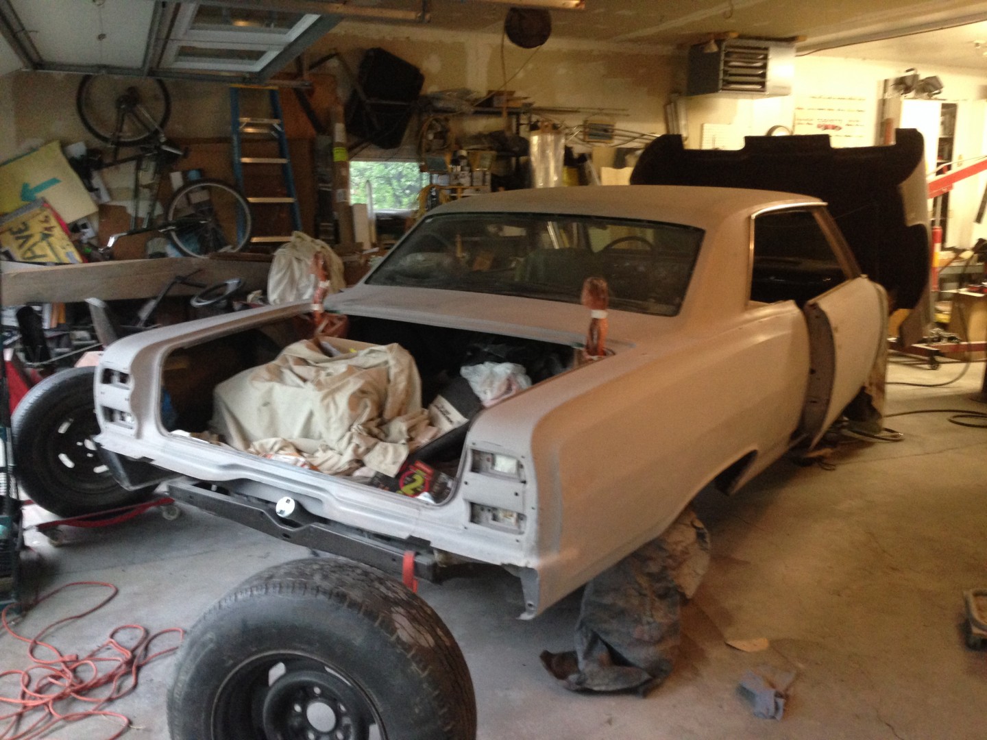

Even though I haven’t posted any updates, I have been working.I finished the bodywork on the tilt front and fender extensions, and on the smooth firewall.When I was satisfied with the fit, I removed the whole front, painted the underside, and put it on a rolling tool cart.The small parts are inside the car waiting for their turn for paint.
I assembled the drive train using the 350 I had used in mock-up, then covered it up until needed.

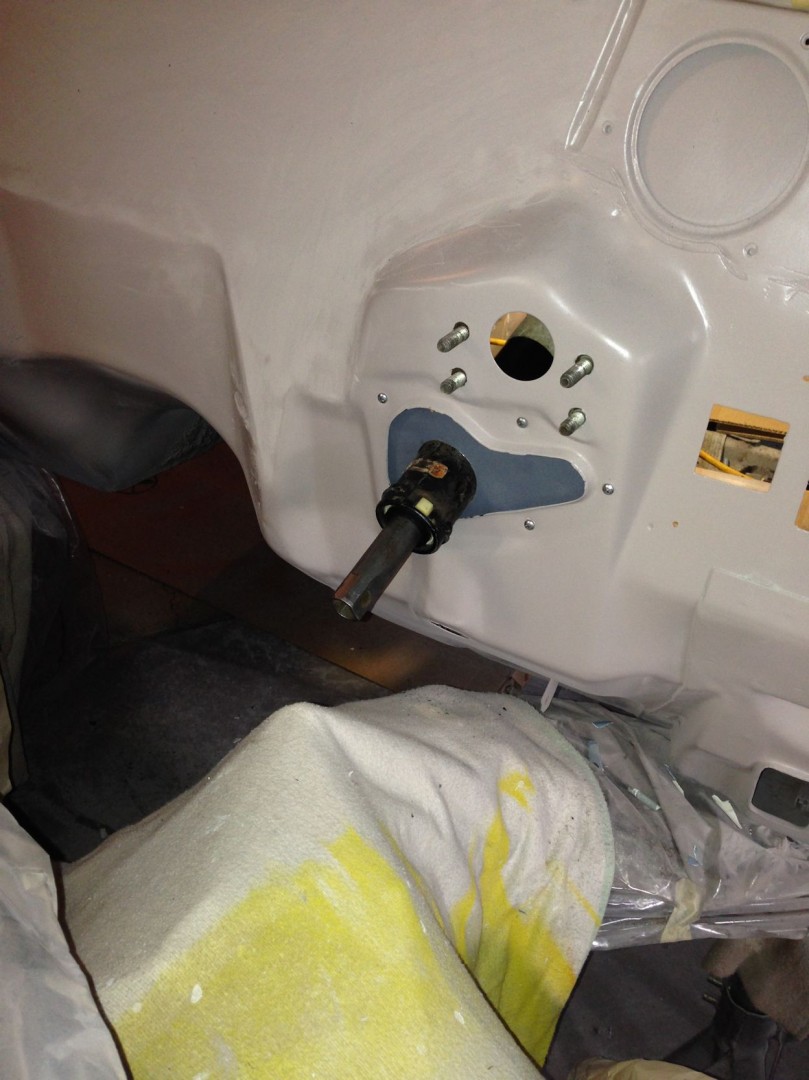

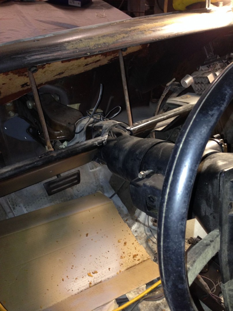

I had bought a tilt-steering column from an 80s Camaro.I had Vanz Auto rebuilt it and made a mounting plate to match the factory opening.Van made it the right diameter to fit nicely into the curve of the bottom of the dash.I had to modify the pedal bracket a bit to make it all fit.

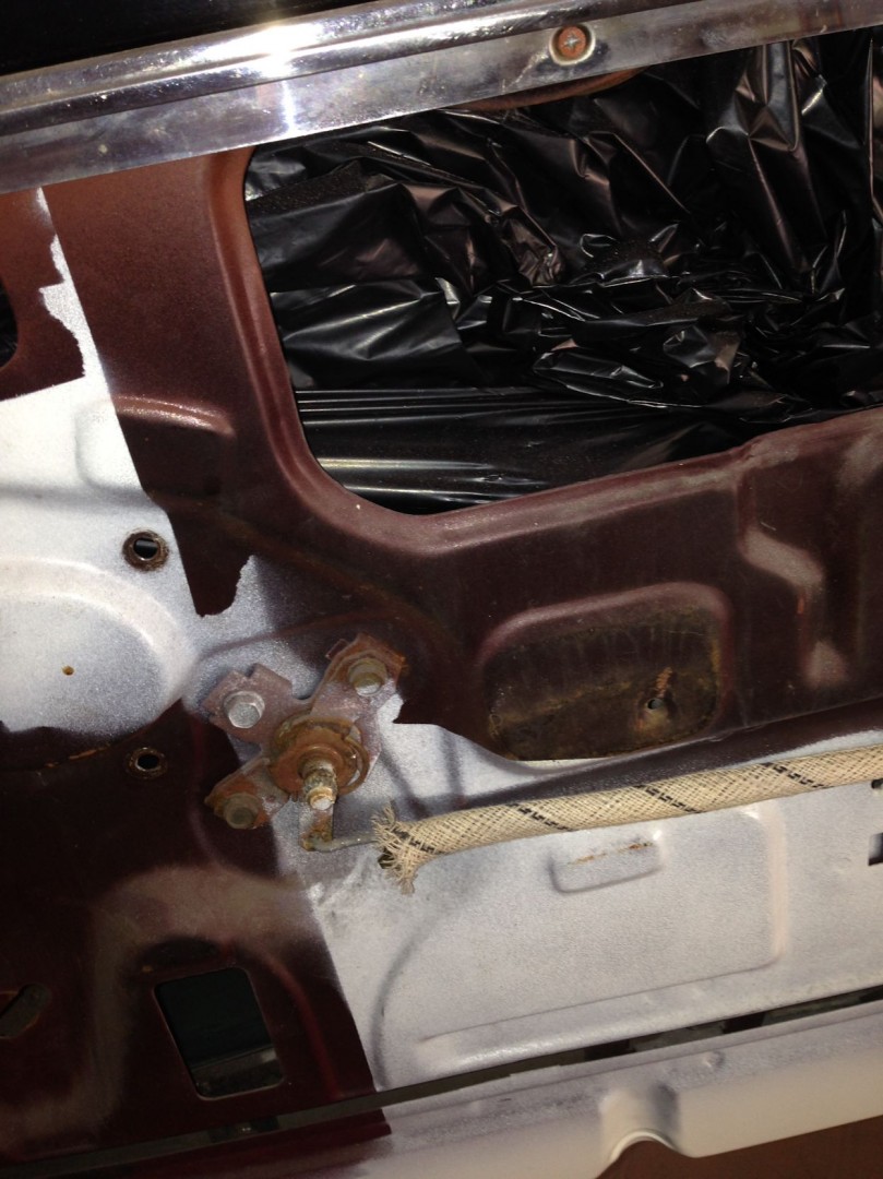

The sheet metal appears to all be original except the passenger door, which is a different color inside.This must have been done early, as the outside of the door was painted blue under the white.

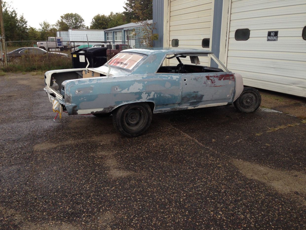

My grandsons spent hours scraping the white paint off.But the rest was really hard.I tried chemical stripper that I had used before.After 30 minutes, the paint was barely soft; and only the top couple of layers.I tried sanding and could barely see any progress.So I took it to the sandblaster.
It came back mostly paint-free, although the back glass had damage from the sand.He promised to make it right, and I assume he will if I keep after him.There were a couple of spots where he didn’t blast off all the filler, but it was thin enough to only take a few minutes.I found several places where a factory joint had been brazed.It looked like factory work.I had never seen that before.

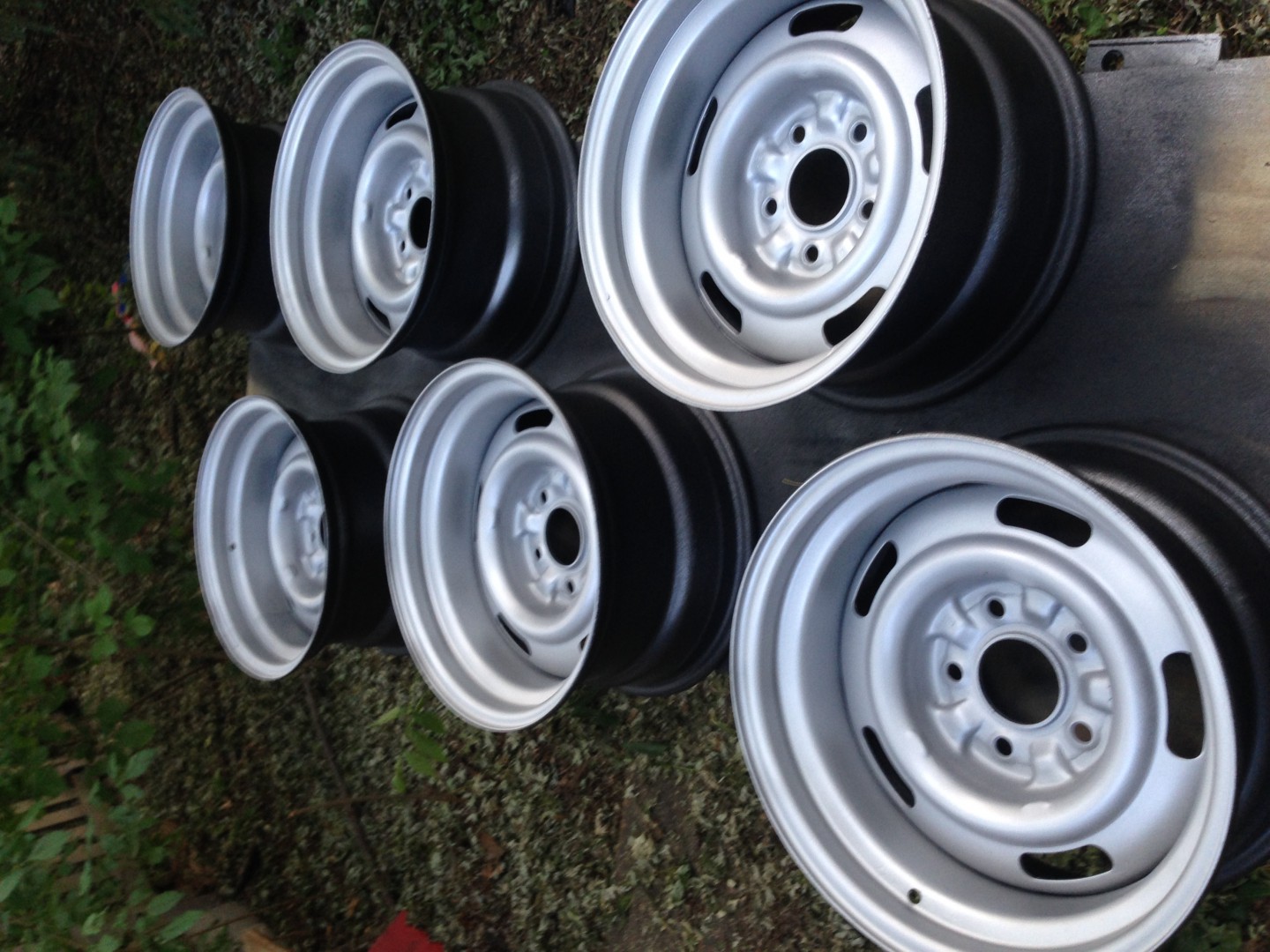

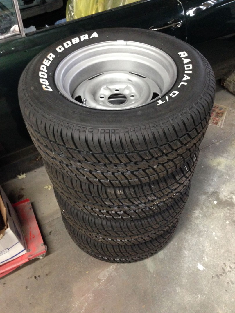

I bought some used wheels from a member, had them sandblasted, and painted them. Chevelle Argent Silver is different from my 70 Corvette, which used a three-year-only formula.

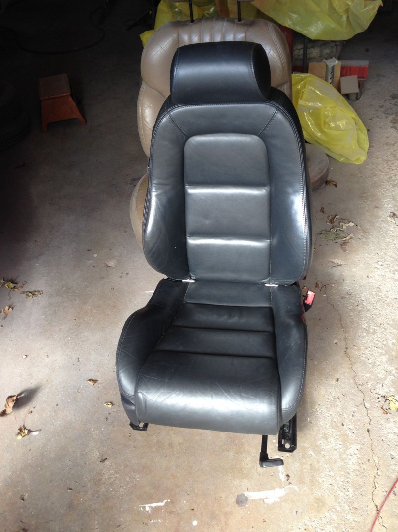

I bought a set of leather seats from an Audi TT. Fred at Convertible Tops and Interiors by Fred will make upholstery for the back seat to match this material and stitching. He will do the same on the door panels.

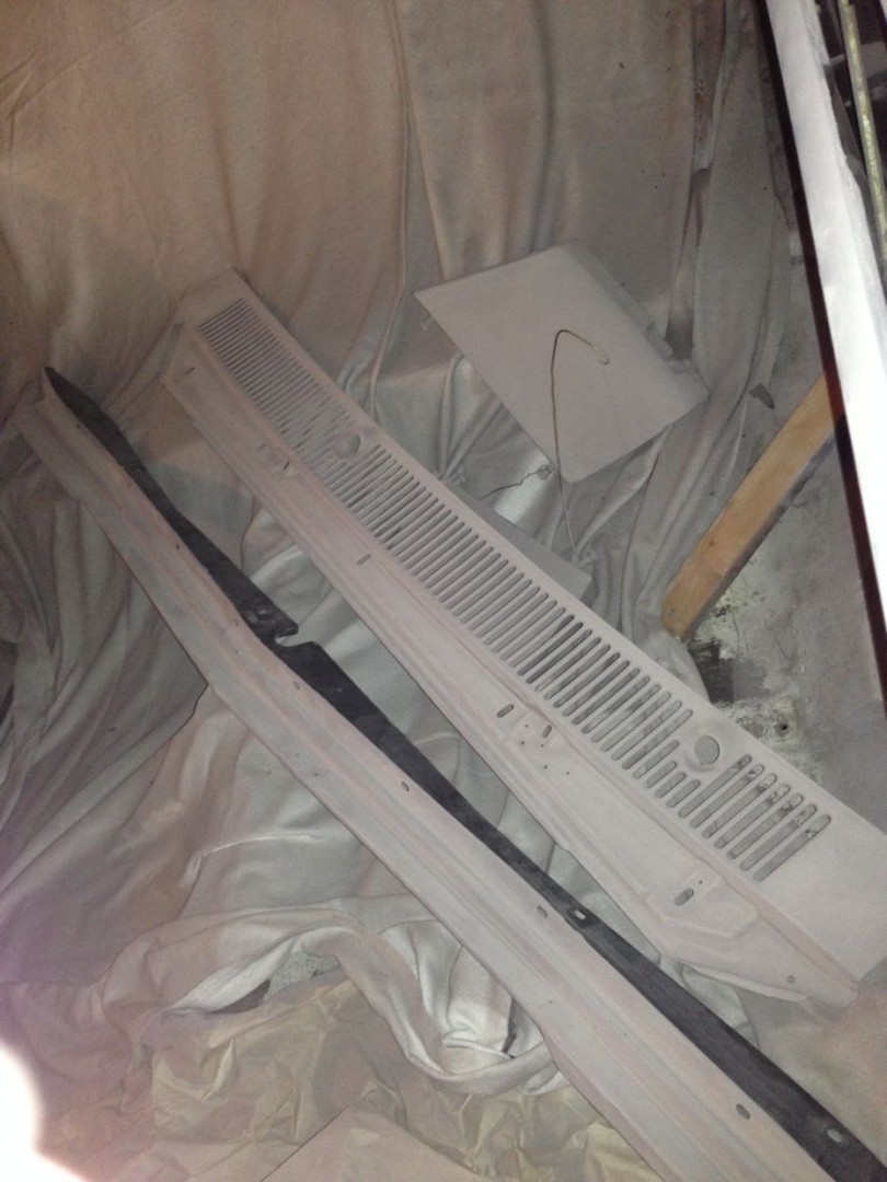

The firewall is ready for paint.

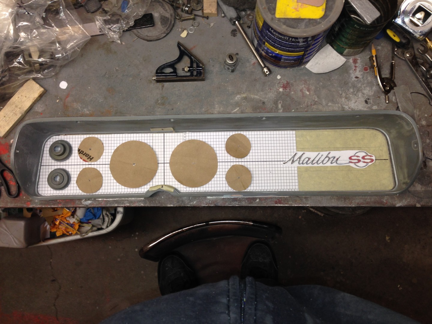

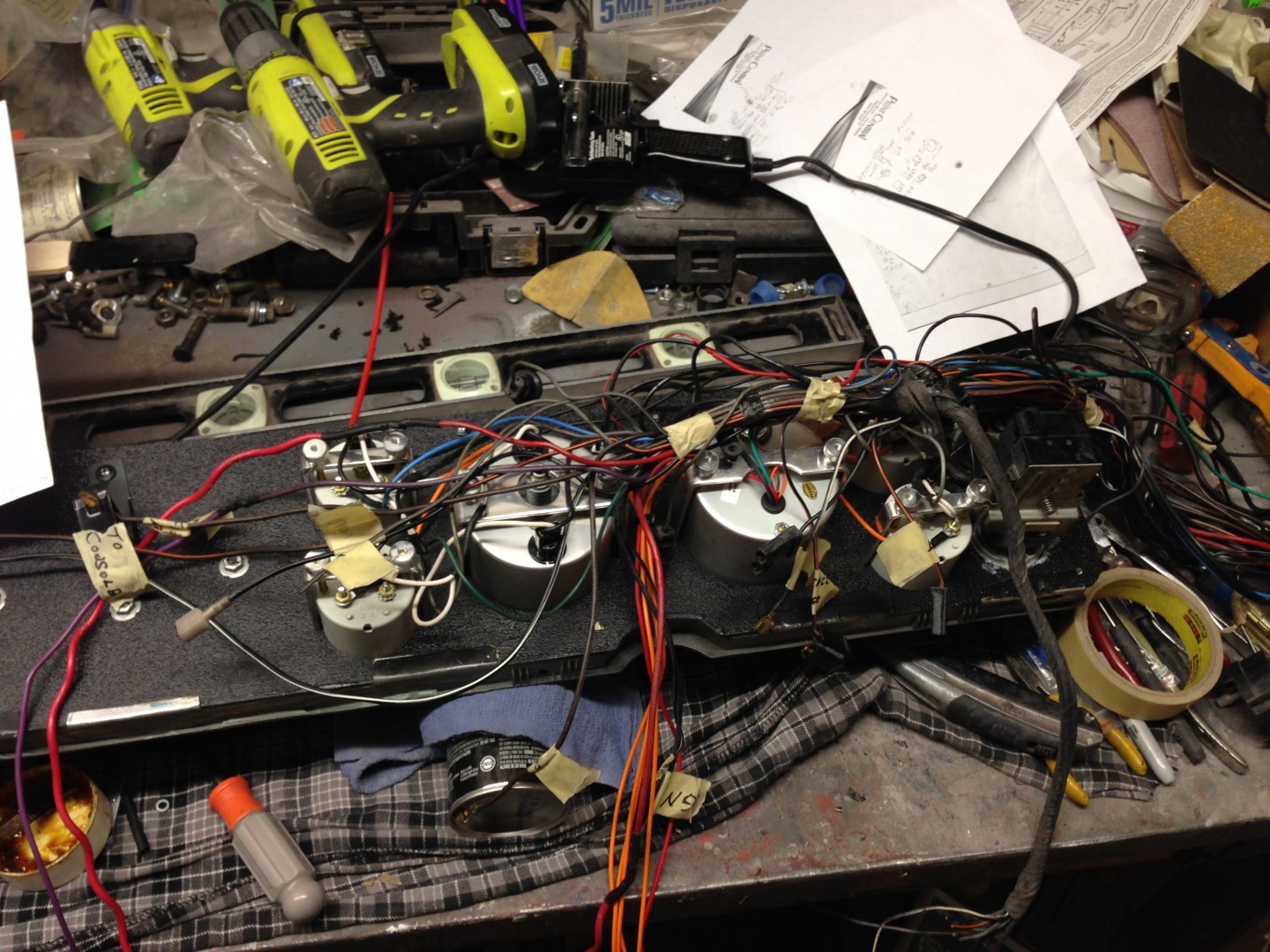

Laying out the new instrument cluster.
The finished dash.
Wiring the new gauges.

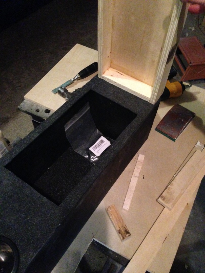

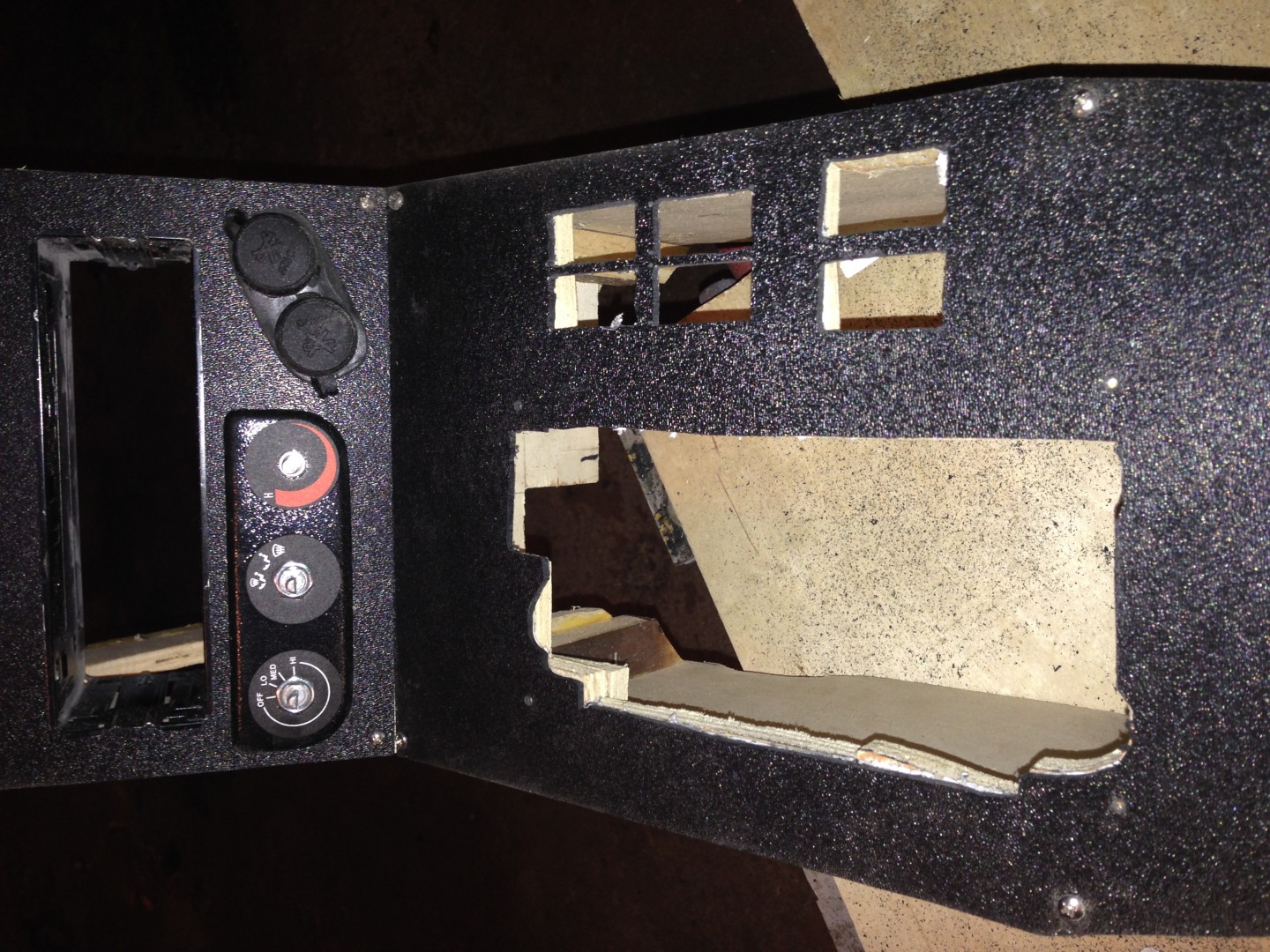

The storage compartment in my console.

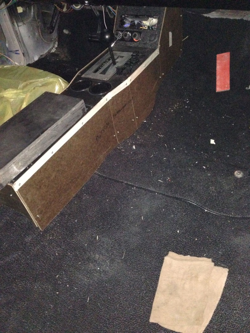

One of the many trial-fittings of the console, including the mock-up of the shifter and switches. I will have power windows, door locks, and trunk release.

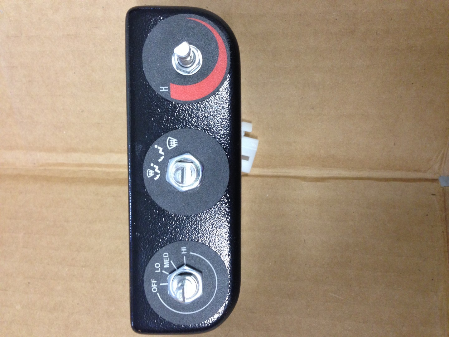

Heater controls.
And a couple more progress pictures of teh console.

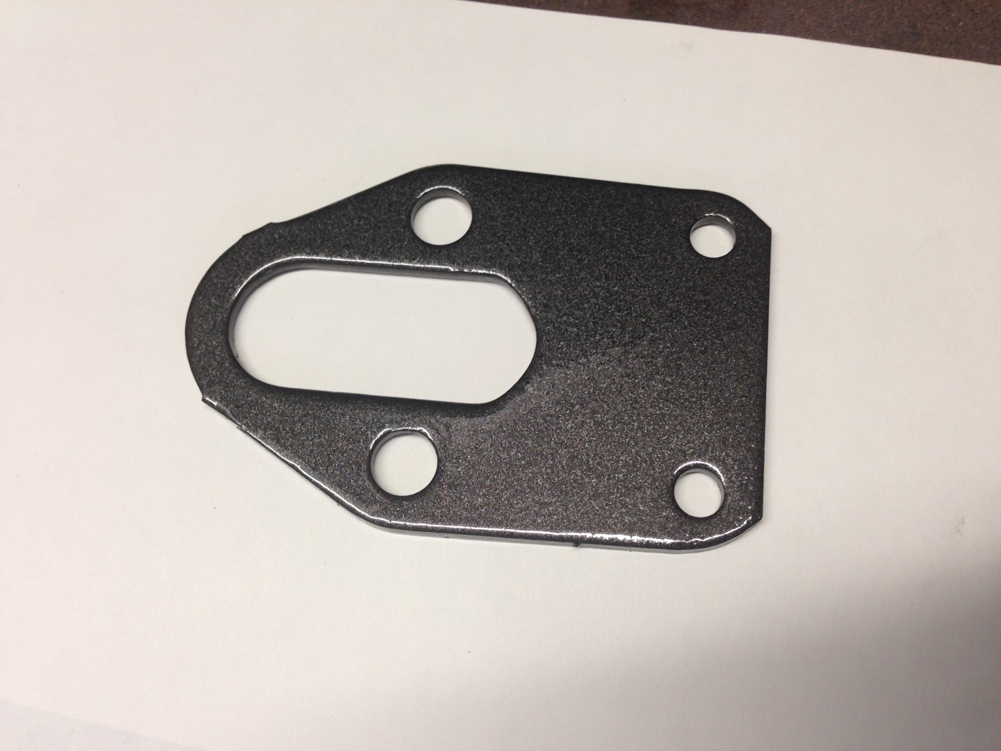

My engine was done before I remembered I was supposed to order the Performer RPM Air Gap manifold, so we broke it in and dynoed it with an old style Performer. It made 488 ft lbs of torque, but only 440 HP. Jeff at Wheeler says from his experience, it will make 500 HP with the new manifold, which is due Friday. I have a video, but can't get it to post, so here is a picture of it sitting in place.

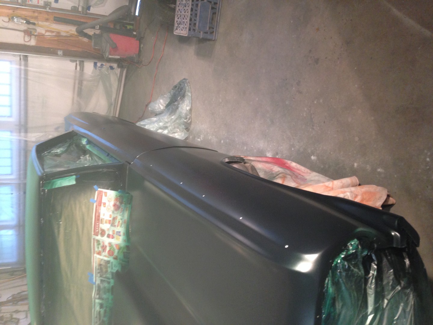

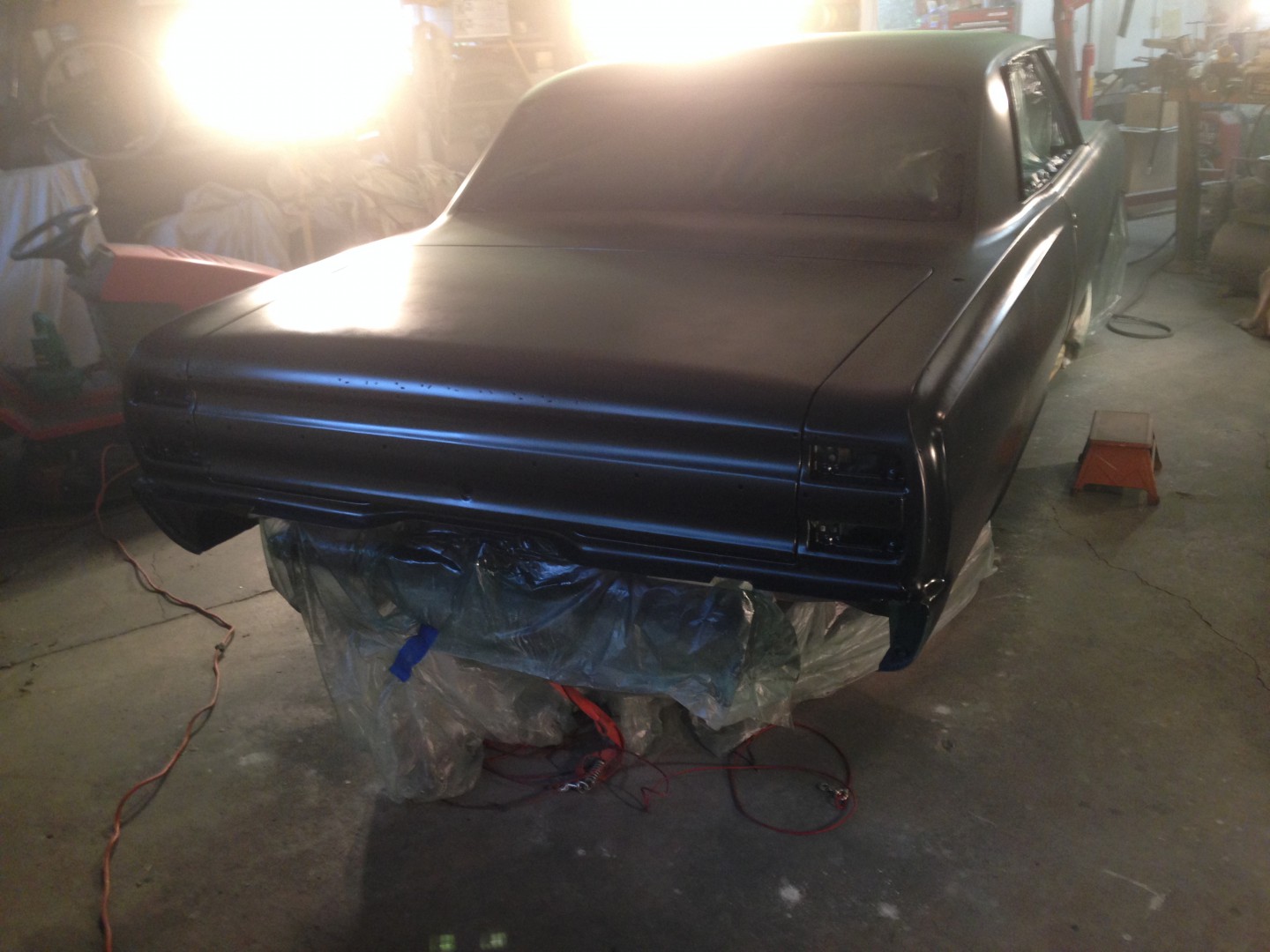

Since then I have been working on the body. If I posted a picture every couple of weeks, they would all look about the same, but I really was making progress.
I used a laser to get the style lines straight, and blocked for hours. Finally it was time for sealer. GM used black sealer.

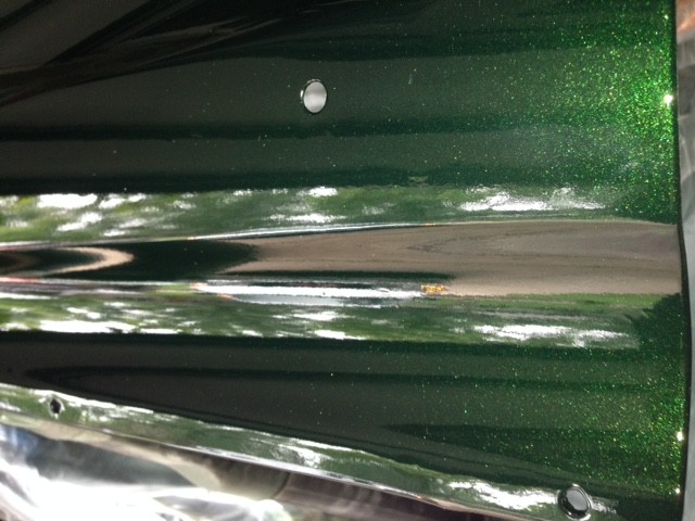

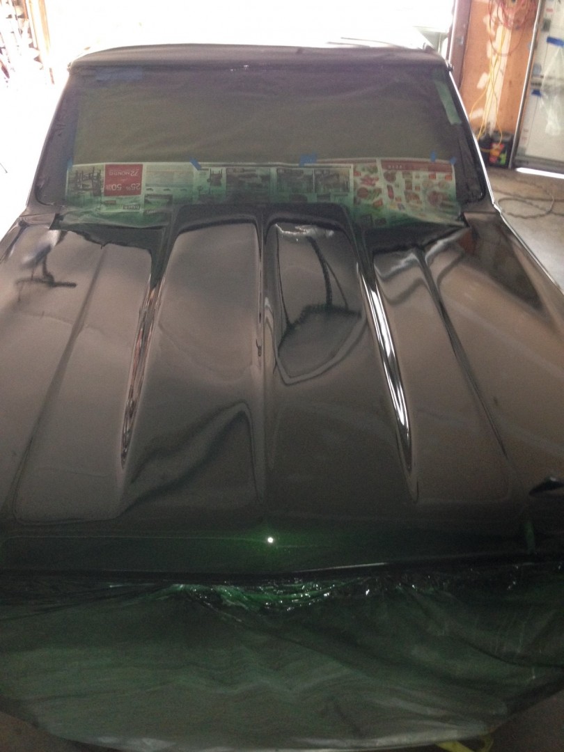

The color is PPG Unripened Green. Corvette called it Lime Rock Green. I put on two coats of base coat, and one of clear. By then I was too worn out to do any more, so I let it dry, wet sanded it, and put on two more coats of clear. The car needs to be in bright light for the true color to show, so these are shots in my gloomy garage.
This little guy settled in the last coat of clear. I let it dry, then blasted him away with 100 PSI of air. I was able to dab a tiny bit of clear in the hole he left, and I think it will be ok.
Here is a close-up of the trunk lid showing the green, and how it flops to a smoky gray.
Now just endless hours of color sanding and buffing. Fred, the upholsterer says he will be ready in a couple of weeks, so I better get going.

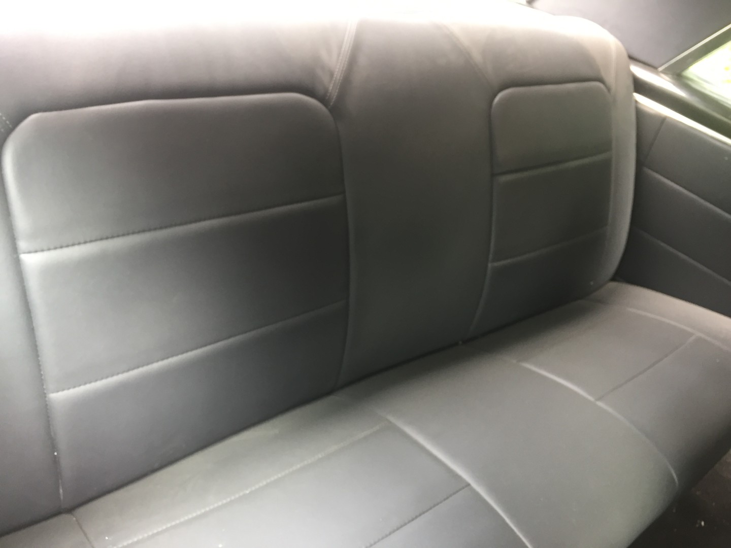

Fred the upholsterer will be here in a week or two. He is doing everything in a contemporary version of the original. The seats and door panels will complement the Audi TT buckets I bought. He will upholster the console, and make a new package tray with hidden speakers.
And then, except for all the "punch list" things I find, it will be DONE!

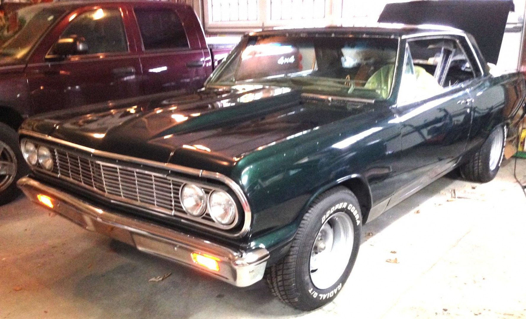

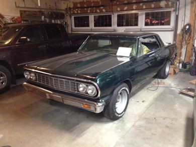

It is 99% done. I have a short punch list to take care of. When I sent it to a shop I trusted for exhaust, I told them not to drive it, as it didn't yet have a TV cable. Now, a couple years later, when I drove it for the first time, It didn't seem to pull very hard, and the fluid smells a little burned. I will wait and drive it a little before deciding anything.

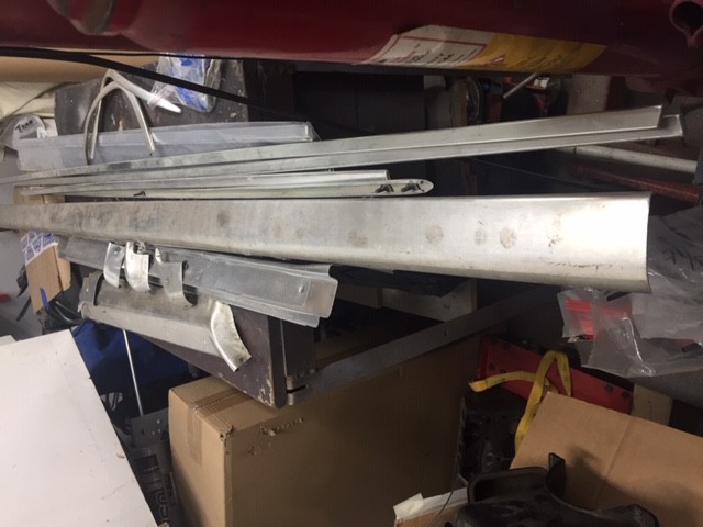

I will post a few pictures soon. But in the meantime I am sorting leftovers. Today's offering is all of the SS side trim. It is pretty decent, but not as shiny as it should be. It is all there: SS side trim, rocker moldings, and sill plates. If anyone wants it, I will put it in a shipping tube and set it outside when you are coming.
Is there the rear corner piece for the passenger side that goes from the rocker panel to the rear wheel well trim?
Dec 19, 2020
I would be interested in the door sill plates.
Dec 19, 2020
John; Look at the second picture. Is that the piece you are looking for? I have all four of them.

I thought it would be a good idea to install the engine just to confirm everything fit. I am using an engine out of a ’77 Corvette that we bought for parts. Before we took it apart, we squirted gas in the carb and ran it for a few seconds. It should run well enough for shakedown. First I had to clean it. I used two cans of engine degreaser, then a quart of lacquer thinner and a scrub brush to get it clean enough to spray it spray-can black. In hindsight, I should have used a lighter color, because everything kind of disappears in the black.
Now it should just bolt together, right? Wrong! The headers I thought were Chevelle were actually Corvette, so I ordered a new set. A Corvette power steering pump mount fit the engine, but not in the car. So I bought a set of correct Chevelle mount brackets. I have a later model steering gear box, so the Chevelle mount didn’t work either. I ended up taking 2 ¾ inches out of the middle of the bracket. Now it fits, although it doesn’t have a lot of adjustability. I will have to find exactly the right size belt.
I also made brackets to mount the radiator. It needs to stand by itself as the core support tilts away from it. I started with a ’70 Corvette radiator, which exactly fits between the tilt actuator, and between the frame and hood. I had the drain moved and a different outlet installed. Twin Flex-a-Lite fans exactly cover the core, and bolt on to the reinforcements across the top and bottom of the radiator.
Finally everything related to the engine seems to fit.

There were alignment notches where the body joins the firewall that catch the fiberglass when the front opens. While I am certainly not up to Mitch’s ability, I did manage to weld in patches.

The last brackets are made for the bottoms of the front fenders to attach to the body. Then I just have to get everything to fit just right before removing the front to work on the firewall and engine wiring and accessories.
In anticipation of rewiring most of the car, I bought an assortment of wires. Then I made a new front lighting harness. It is much like the original except for later wiring colors and a quick disconnect. The wires need to be much longer from the firewall to the core support because they used to run down the inner fender, and now they will go down to the frame and forward to the disconnect, then up to where they used to run. I can’t remember where the horns mount so I will have to find a place where they are not in the way of the actuators or the wider radiator. When I finalize all of that, I will wrap everything in original black wrap.

Even though I haven’t posted any updates, I have been working. I finished the bodywork on the tilt front and fender extensions, and on the smooth firewall. When I was satisfied with the fit, I removed the whole front, painted the underside, and put it on a rolling tool cart. The small parts are inside the car waiting for their turn for paint.

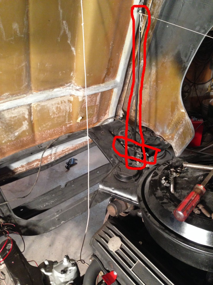

Running the front wiring.
I mounted the new brake booster and master cylinder. When I took this picture, I didn’t have the lines parallel, but they are now.
I had bought a tilt-steering column from an 80s Camaro. I had Vanz Auto rebuilt it and made a mounting plate to match the factory opening. Van made it the right diameter to fit nicely into the curve of the bottom of the dash. I had to modify the pedal bracket a bit to make it all fit.
The sheet metal appears to all be original except the passenger door, which is a different color inside. This must have been done early, as the outside of the door was painted blue under the white.

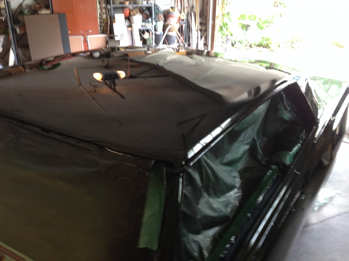

My grandsons spent hours scraping the white paint off. But the rest was really hard. I tried chemical stripper that I had used before. After 30 minutes, the paint was barely soft; and only the top couple of layers. I tried sanding and could barely see any progress. So I took it to the sandblaster.
It came back mostly paint-free, although the back glass had damage from the sand. He promised to make it right, and I assume he will if I keep after him. There were a couple of spots where he didn’t blast off all the filler, but it was thin enough to only take a few minutes. I found several places where a factory joint had been brazed. It looked like factory work. I had never seen that before.
You've been making steady progress. The braze is factory, but I've never seen a naked '64, and there is more than on the '66's.
The finished dash.
Heater controls.
Then it was finally time for color!

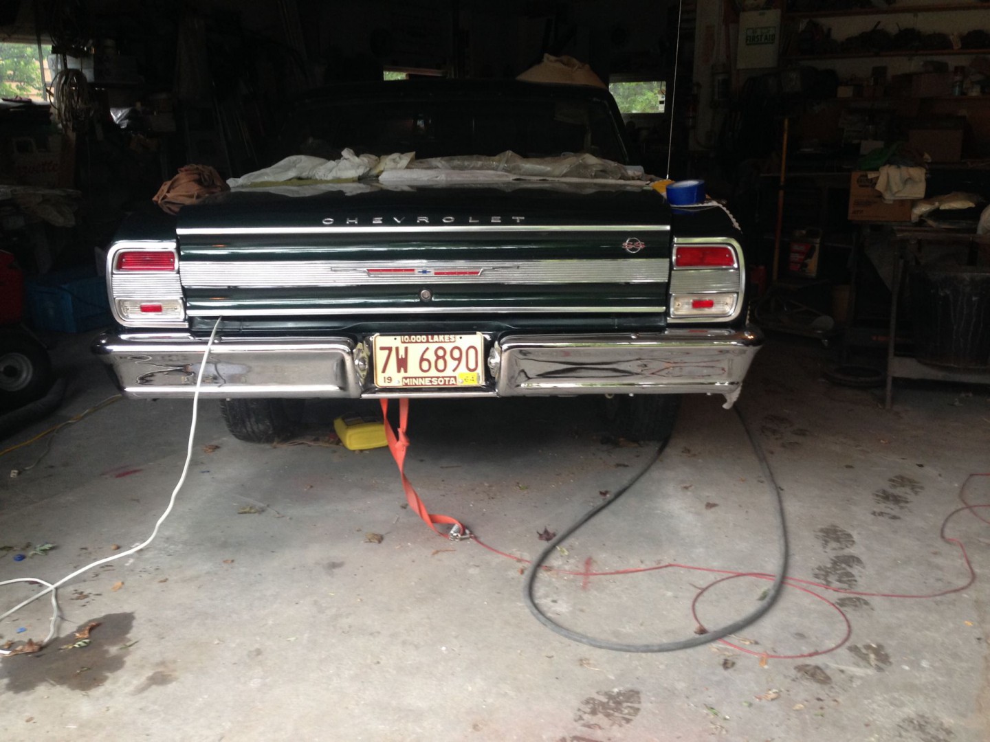

Chris; Just let me know when to put them out for you.
Both of you; We are practicing complete isolation so can't meet with in person, but could open the garage door and let you look at what is there.
