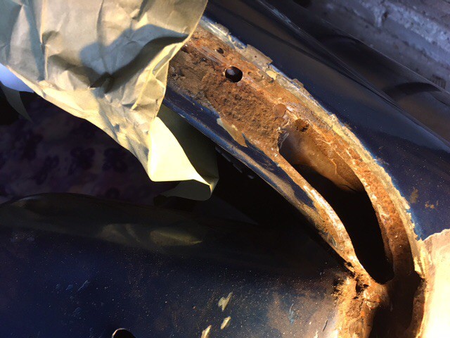

I've been worried about the windshield channel on my '66 for some time, and today decided to tackle the cracked windshield and whatever else lurked under the surface. Unfortunately, much was lurking. The glass had been "gooped" in, with both the urethane sealant holding in the glass and about a tube of silicone on top of that, presumably to remedy leaks. It was an obvious mess. Once I got everything cut away and scraped off, it became clear that the two corner areas of the lower channel were rusted through, and a 3 inch section of the driver's side post had been patched with fiberglass over a gaping hole. Worse, the upper steel bar across the top of the windshield (this is a convertible) has a significant rust hole on the driver's side behind the chrome stip. Looks like a fair bit of welding in my future, which is not something I am looking forward to. I think I have added photos of the carnage below. Any ingenious tricks for this repair would be welcomed.
Very common problem. I used a rust converter and welded a patch over this.
On the rear, I cut out the rust and made a patch to fit flush.

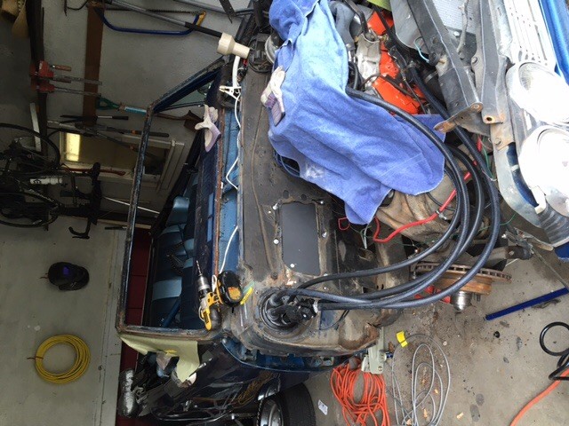

Ugh. I think I have just met the qualifications for membership in the Cars Apart Club. Once I started getting the lower channel off, it became clear that I would also need to replace Lucy's a-pillar covers, which means taking off the front fenders, hood, etc. to get at the lower screws. Who knew a windshield replacement was so involved? Below is a photo of the car this afternoon - missing most of the front clip.
Anyway, I ground out the questionable metal in the pillar itself, made a patch, and TIg welded it in place.(photos below) Of course, just as I had it ready to weld, I dropped the patch inside the door pillar and had to run to O'Reilley's for a magnet stick to fish it out. Some choice words in the garage.
The AMD replacement channel arrived today, and I've got the old one completely removed after MUCH spot weld drilling and grinding. Can't fault the General for under-welding the thing, that's for certain. Unfortunately, the new channel doesn't come with the trim clip studs welded on. I figure if I can locate them, I'll have to drill holes and weld them on from below, which means I can't install the new channel just yet. If anyone has another idea, I'm all ears.

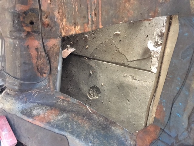

Odd Discovery of the day: at some point, someone replaced an entire square section of the passenger side front fender. Not just the skin - they actually cut the skin and the stamped inner brace together and welded a new section in. Not the greatest work over the years on the old girl, but that one's downright weird.

I got the new lower channel welded in this afternoon, using the "Mitch method" of securing it with a handful of sheet metal screws first and then welding up one hole at a time. I also discovered a couple of thin spots on the dash itself, and patched them up before putting on the channel. Pillar covers should be here tomorrow, and I can start assembling again instead of dis-assembling. Fingers crossed, not as horrible a job as I had feared. Getting the fenders and hood all shimmed up and bolted back on may be the bigger hassle.

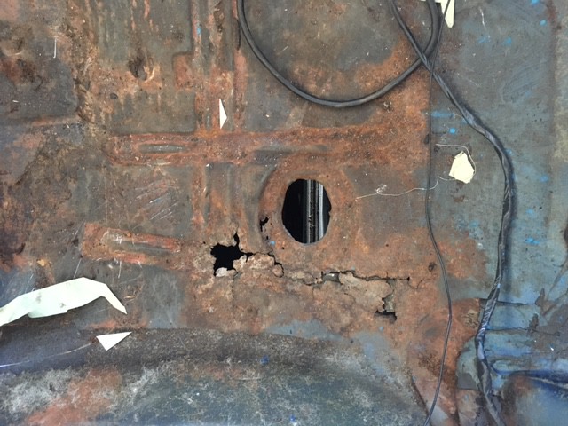

I had a whole day to work on the car today, which is a pretty nice treat. I cut out the rusty areas in the floors with a cutoff wheel, cut the new panels down to roughly an inch wider than the holes on all sides, and welded everything up. I used the Mitch Method again with the lath screws, this time putting them only into the old metal with the heads overlapping the edge of the new metal. This makes for a little more adjustability of the panel before welding.
I had picked up a teeny little TIG from Eastwood last year, which worked great for welding the panels in (I don't have a MIG and I've never been a big fan of them anyway). I tacked all the way around, and then followed with beads around about 80% of the seam area. I contemplated cutting perfect replacement panels and butt-welding, but as this is never going to be a show car, I wound up just welding in an overlapping panel. I'd really rather drive it than have someone crawling around under it anyway.

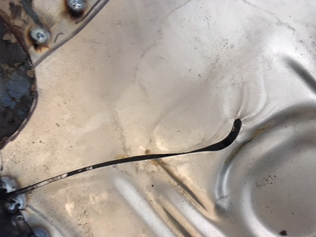

One irksome thing (and perhaps why the panels were inexpensive) was that the new panels had an elongated hole in them where the most severe bends are. I suspect that this is required to get the bend, but I really wasn't prepared to have to weld patch panels onto my patch panels.
I finished the day by gloppoing it up with seamsealer (or, actually, Loc-Tite urethane adhesive sealant in a caulk gun, which is as close as I can get my hands on). Photos below. PS if someone can school me on how to get the big photos on here, I'd be grateful.
I've never seen pans like that before either !! Those look like the bargain basement replacement.
Here's a pic of the passenger front I got from Summit.
I use photobucket to load pics on here. You can turn your phone pics the right way on the bucket editor too.

My front looked like that , but both the rears had the gap - I got them from Summit as well, and did not see any alternative on their website that might be a better piece. I made a little cap for the gap and welded it on, but what an un-necessary pain in the neck. I will look into Photobucket.
I picked up some original bucket seats and a re-upholstery kit for them, and Summit supplied two installation brackets. Unfortunately, they don't tell you how many seats one set covers. I had assumed (!) that the outboard holes were the same, and one bracket would be required for each seat; two brackets = both seats. Unfortunately, two of the brackets are required for each seat, and the brackets that Summit had really aren't the same as the factory mounts. ss396 has the correct kit, and it includes enough for both seats, so it is now on the way. The final welding will have to wait for a few days.

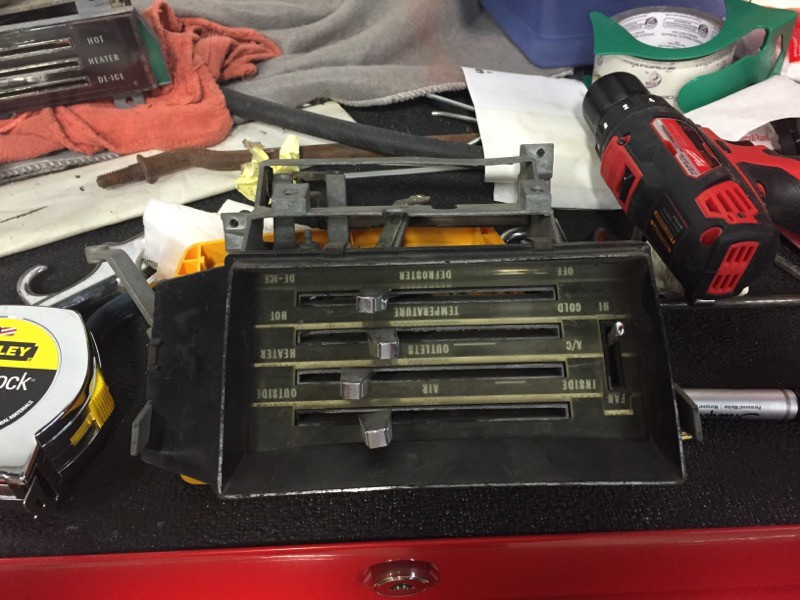

Your picture showed an A/C dash, isn't the hole different size for the non air control? I think the a/c controller needs a larger hole. I do have both.

Your picture showed an A/C dash, isn't the hole different size for the non air control? I think the a/c controller needs a larger hole. I do have both. Karl
Yep, A/C hole is wider. Vintage should be able to use existing A/C controls and convert the levers to solenoid. If you have a broken lever, replacements are available, or Karl may have a control.
Quite the selection! I have a non-as dash, it just looks av because I cut the holes for the vintage air vents ( which are trash, by the way, so if you have a couple good originals I would be interested in taking a look at those too)

First, I found out the the A-pillar covers are different on Convertibles and hardtops. The convertible ones have a shorter top, with a tab sticking out to tuck under the chrome topping trim. Fortunately, there is enough material on the AMD replacement covers that you can trim them down to work, which is what I did. I'm pretty sure that's what the General did, too.
Second, the replacement covers come pre-drilled for the lower mounting screws, but not counter-sunk to get the screws flush, which is essential because the chrome weatherstrip channel screws to the underside of it. I didn't want to cut a countersink in the tin, because by the time you are done the screw doesn't have any metal left to bite. The factory ones were punched into a cone shape by some kind of press, but the replacements were flat. I came up with a solution of putting a wood screw through the material and a 1/4" socket on the other side, and pressing the screw into the sheetmetal with a vise grip. The result was a dimpled hole very similar to the factory one, and the screw sits perfectly flush in it now.
Finally, the covers sound tinny and rattle when tapped, and rattles are a big pet peeve of mine. So I got a tube of Loc-Tite urethane adhesive/sealant and ran a couple of beads up the inside of the covers before final attachment, in addition to a big glob at the top like the factory did. This made a huge difference, even without curing. The covers feel solid and don't make any noise at all.
Anyhoo, the whole business is now welded, screwed, and primed. If we get some good weather in the next couple of days, I should be painting.

Today the fenders are back on, the new AMD radiator support installed (Old one was so bent that I had 8 washers shimming out the grille bracket). I got the upper steel part of the doors and rear area prepped for paint, as well as the newly stripped and primed dash and the dash top and A-pillars. I pulled out the carpet and LO AND BEHOLD 3 out of 4 of the damn floorpans are rotted through (curiously, the passenger front was intact). I don't care to waste my dynamat and new carpet on weak and leaky floors, but I am thinking that I should have bought stock in Summit before tearing into this project - another $167 for three patch panels goes to Ohio.
As for the A-pillar replacements from AMD- Don't. Not if you can help it, don't. They are not exact reproductions, and particularly the driver's side is not a good fit. I pulled, pushed, cajoled, clamped and massaged, and I am going to have a gap there that is fully 1/16" wider than the rest of the adjacent gaps. Plus, the front corner doesn't line up with the line of the fender because the riser on the original was not reproduced on the replacement. In retrospect, I should have re-used the old ones and welded in a patch. Now I have the new ones glued and screwed in, and the fenders on them, so I will have to live with them, but if you are thinking about buying these parts, your factory ones had better be well beyond repair.

I improvised on the dash fastener with a speed nut, but I am in need of a good non-AC heater control to use with the Vintage Air setup that is now in the car. One of the levers in mine had been "repaired" at some point with Jb-weld. Needless to say, it didn't hold. I also have a radiator overflow tank bracket, good windshield trim, and a wiper motor on my wish list, in case any of those happen to be taking up room in your shop.
Mitch, I never even looked at that option, which was probably foolish of me. As it stands, the Tremec kit is being delivered tomorrow, so I guess I am committed. I'm with you in the hydraulic clutch, but the effort required and the inevitable chatter associated with a mechanical setup make it an alternative attractive for a guy who is now pulling 50. My knees ain't what they once was. And, I could never get the squeak out of the pedal, which annoyed me no end.
