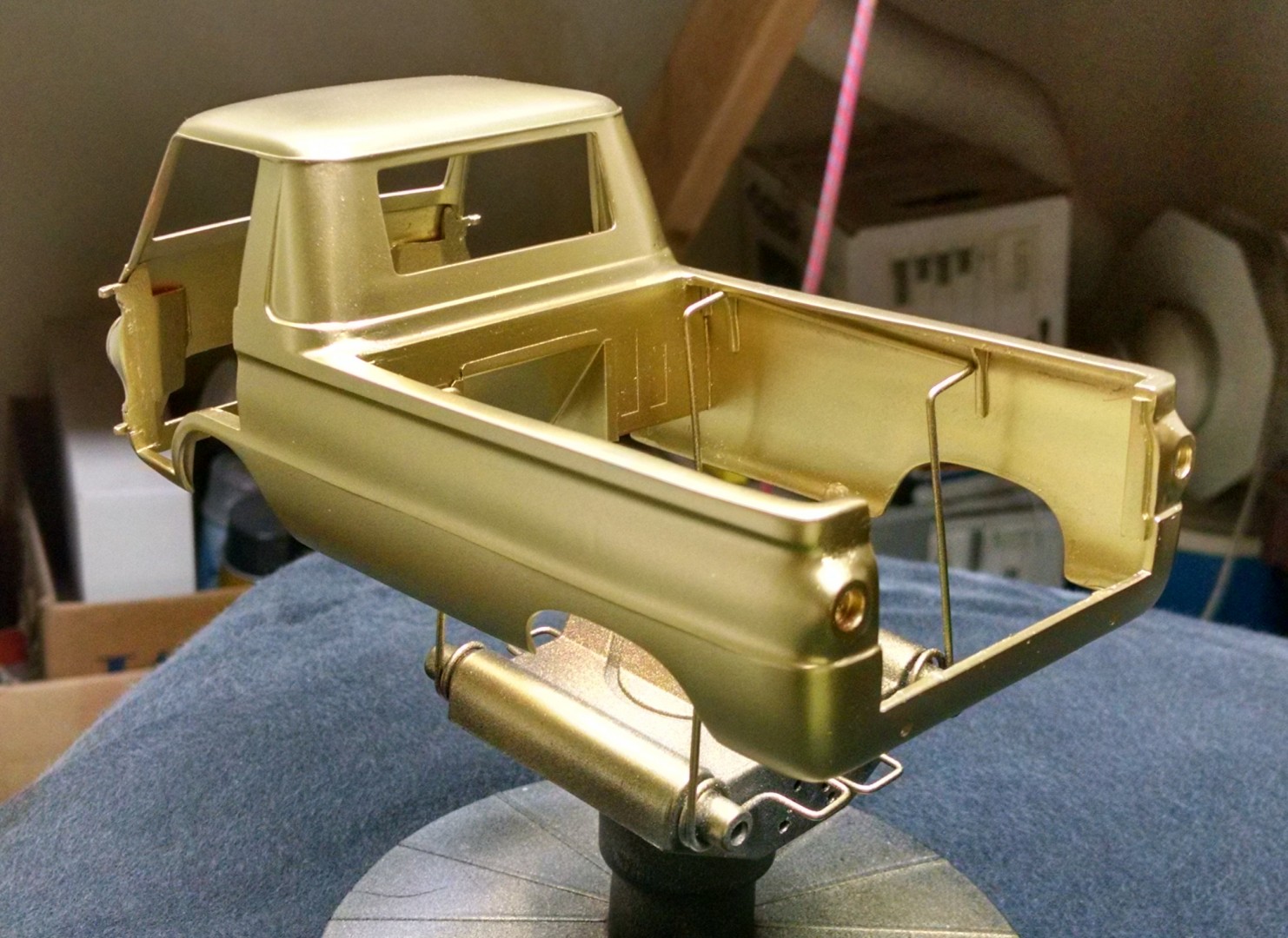

Been doing some painting and test panels.
I decided to build the "LRW" in its later years, when it was painted in more of a deep-red/burgundy "candy" color. Difficulty is that there aren't too many choices available (in modelling paint) for candy/transparent colors... and, I've never done a model in a basecoat/topcoat paint scheme.
I chose AlClad's Ruby Red. They strongly recommend applying their topcoats over their own Aluminum/Chrome basecoat... So I bought a jar of each, and did a few test-panels on an old kit I wasn't going to build. Didn't like the results. Color was too "pinky", with shades of purple. Regroup. Shot the other side with basecoats of Testor's gold enamel, then Model Masters (Testors) "Metalizer" non-buff Brass. (Metalizer recommends topcoating with their sealer. I did this on 1/2 of the area. It tends to dull the effect).
Shot the AlClad red over the gold/brass... YES!
The final result was 3 coats. Two full-coverage (but "mist" coats) 10 minutes apart, then a final "wet" coat. This stuff flowed out really nice, I'll have very little cleanup & buffing after the decals and clear are on! (The interior, jambs and underside were the sacrificial lambs. As in painting a real car, I did those first, then installed the doors & tailgate for the final color coats on the exterior)

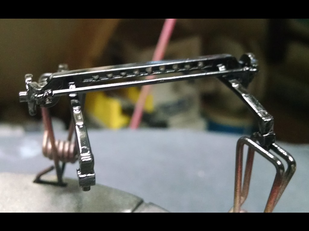

The front suspension is chromed on the real LRW, but not in the kit. "Foiling" isn't really an option, as there are too many angles and curves. Might need to try AlClad's chrome paint system...

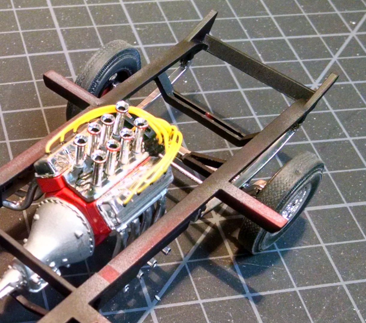

Engine detail is pretty basic. Added plug wires (in the correct B/RB firing order btw), and I'll add fuel delivery once the tank is in the bed.

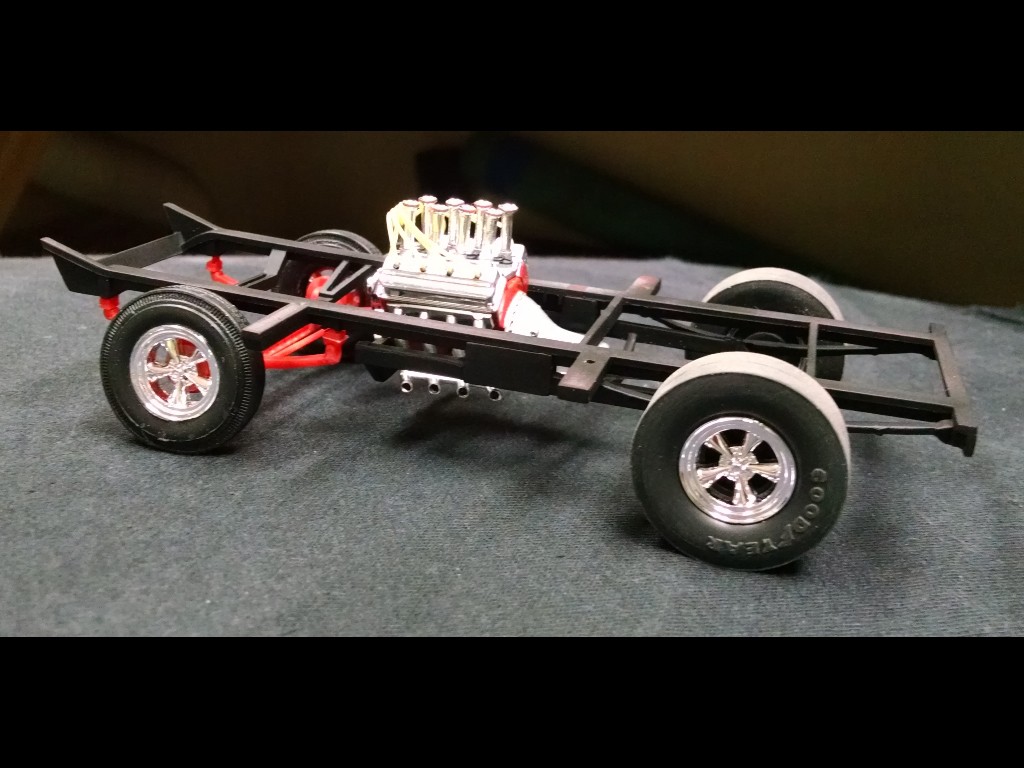

The wheels were a bytch. The kit is designed for the box-stock A100 truck - with 4wh drums and steelies. The LRW has NO front brakes (just spindles & hubs) so adapting the kit's wheel mounting to accurate means a lot of fabrication. The kit also features "steerable front wheels", which also make assembly "clunky". My LRW won't have steerable fronts... they're locked.

Bit the bullet and went with AlClad's Chrome paint. Not for the faint of heart or light of wallet.
It's a two-part system. What you want to "chrome" is 1st finished to perfection, then sprayed with their gloss black (??!!). Allow to dry at least 24 hours. Then you come back and spray 2 to 3 very light wet - but "mist" - coats of the chrome paint over the black...
It's amazing. The "chrome" must be translucent or something. The high-gloss properties of the black base-coat are imparted on or through the chrome/silver topcoat, and it really looks like chromed plastic.

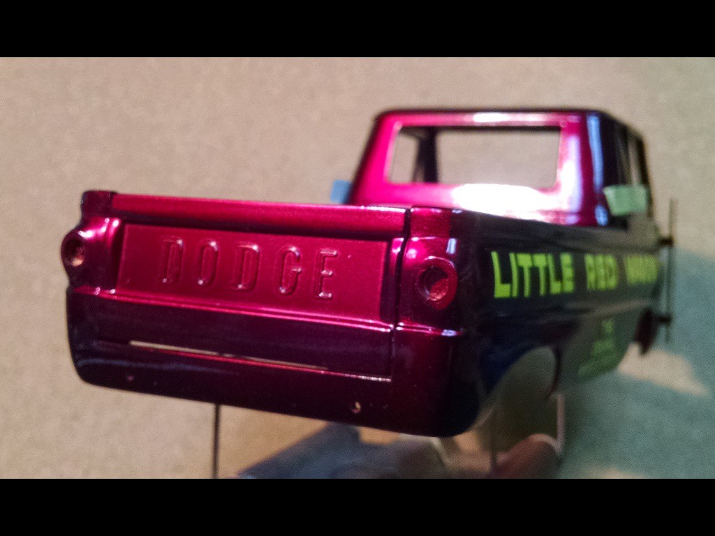

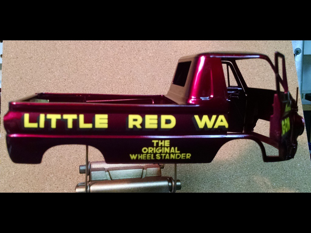

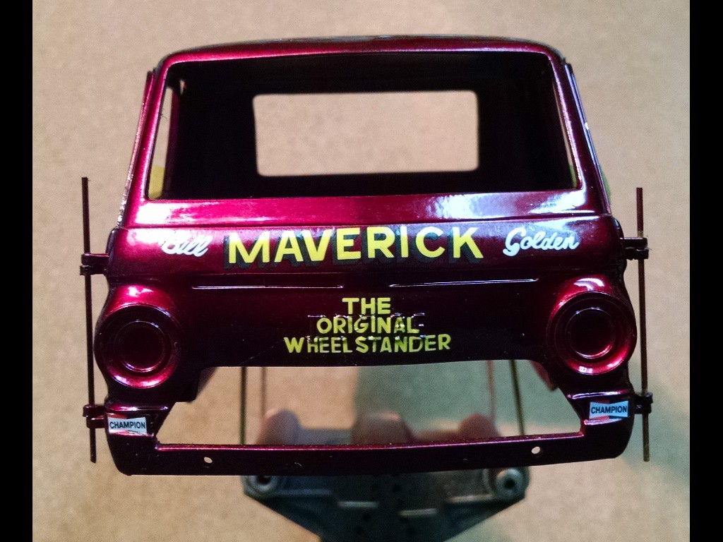

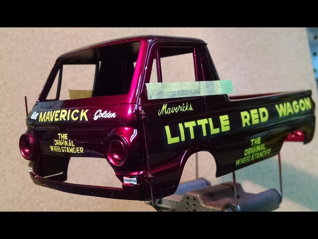

This morning was the "point of no return". Time for the decals on the LRW. Gotta cover up my beautiful paint job...
It actually went well. I use two products just for model decals - MicroScale Industries "Micro-Set" and "Micro-Sol".
MicroSet is a wetting & bonding solution, that allows you to slide the decal around much longer than with just the plain water used to free it from the sheet. It also softens the decal slightly to allow it to conform to gentle curves. MicroSol is a pretty aggressive solution that nearly dissolves the carrier film. It's scary stuff to watch. You get the decal where you want it with the Micro-Set, blot it, etc. and let it dry a bit. Then GENTLY over coat it with the Micro-Sol. Within a few minutes your perfectly placed decal will wrinkle up!! Then as the solution dries, it just sucks into all the nooks & crannies that it would never had adhered to before. The nose of the LRW is an example. The word "Dodge" (which I should have sanded off too late now...) is raised. There was NO way the decal would have settled in without the MicroSol.
Next step is thoroughly clean the body, and shoot a few coats of clear. This will bond the decals to the paint, give them the correct "painted on" gloss, and get rid of the carrier film edges.

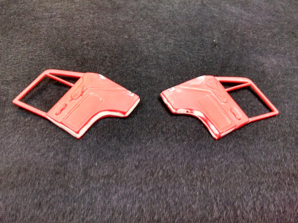

Hanging the doors... Probably the most difficult part of the build. - The hinges are not molded into the body or outer door skins. They are 4 separate pieces per door (like the OEM/prototype). The body 1/2 of the hinge has a molded hole, the door 1/2 has a molded-in pin (about 3/32" in dia.) that is totally useless. - I wound up cutting off the plastic hinge pin, then clamping each respective hinge assy together in the closed position. - Using the molded-in hole in the body half of the hinge as a guide, I drilled through the door half with a #68 (.032) drill. - When each set of hinges (for a door) was done, a length of .030 brass rod was slid through the parts. (you can see this in some of the pics) - The door assemblies were taped in place into the body shell, and the hinge assemblies slid into the slots on the door & body. - When everything with the hinges and body was square/level/perpendicular a dot of ACC (crazy-glue) was applied to the door & body hinge sockets. - The brass rod hinge pin was VERY CAREFULLY slid out of the hinges - The hinge parts were final glued in place on the body and doors, and more filler/sand/filler/sand sessions. - After final paint the excess rod was snipped off, and a dot of ACC applied to the body half to secure the pin(s) (The tailgate was a similar story, but just pinned in place permanently)

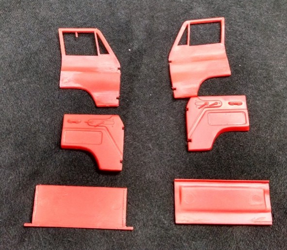

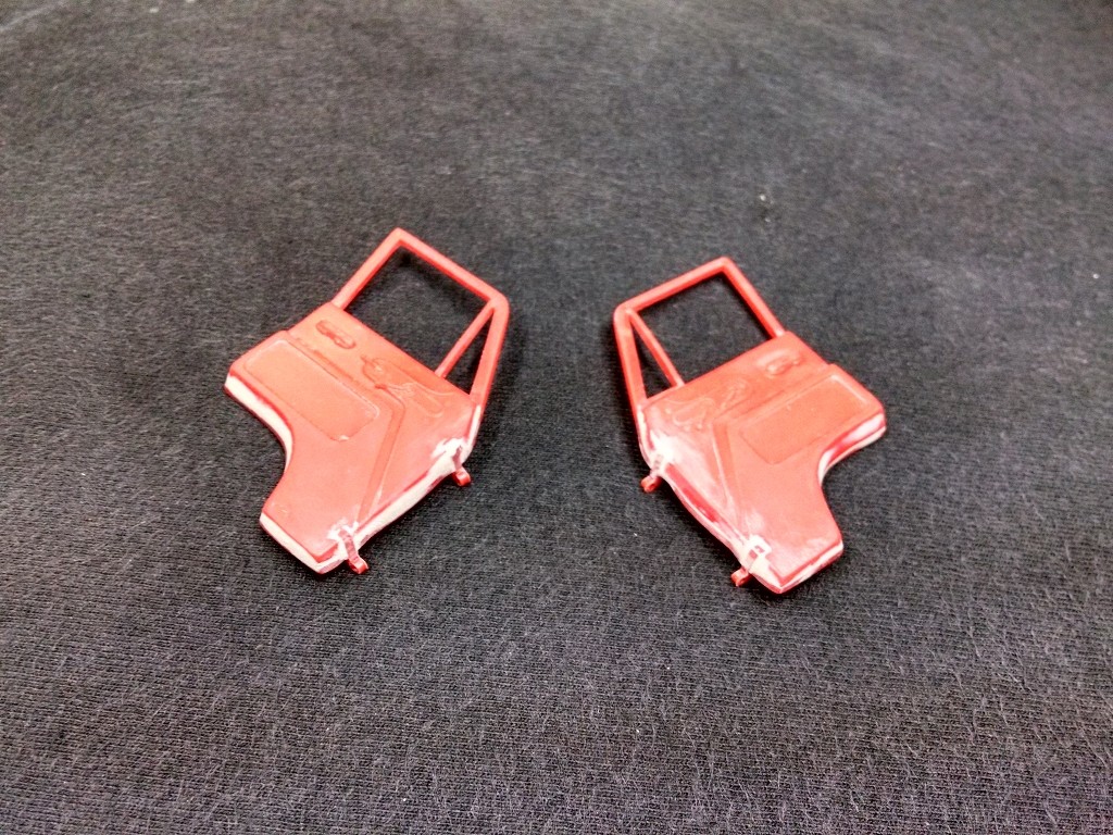

- The multi-piece door skins and tailgate require a LOT of sanding/grinding/cutting to get them CLOSE to fitting together
- After fitting & glue-up, the door skins & tailgate required many filler & sanding sessions
