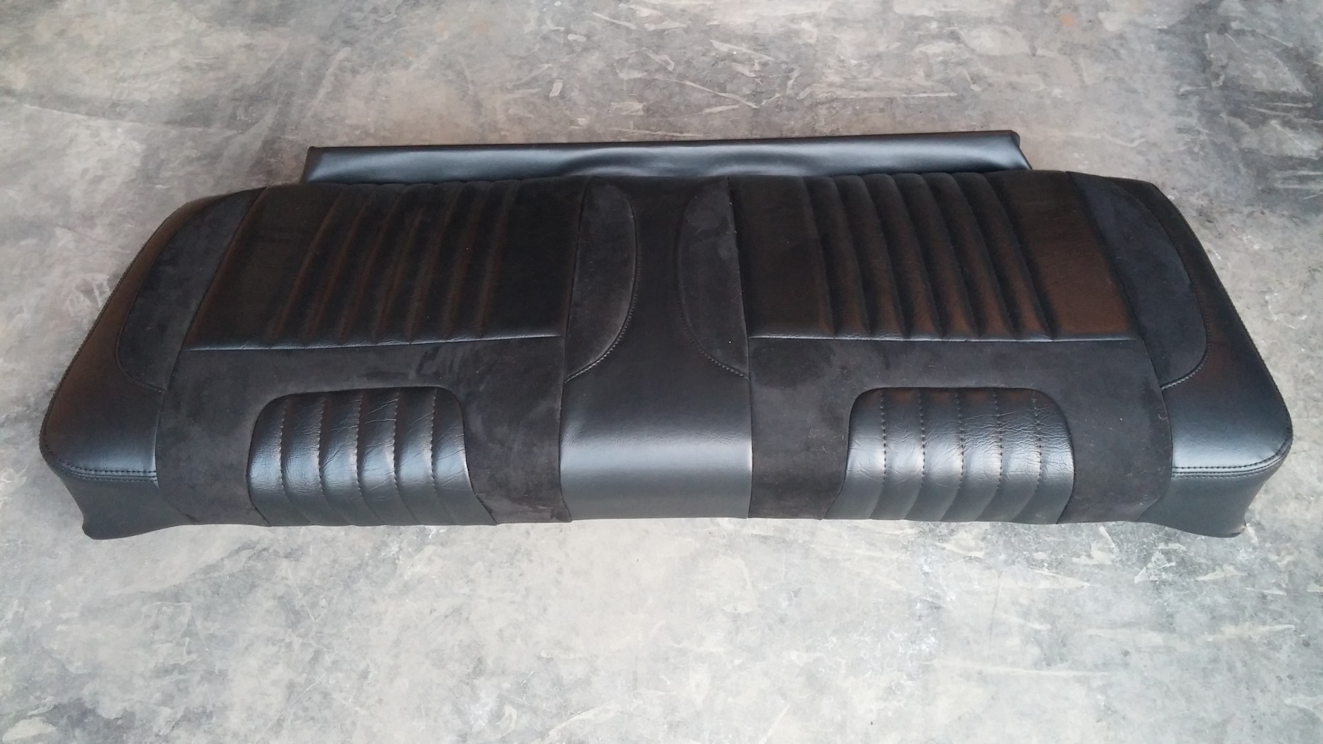

Picked up the passenger bucket seat and rear bottom cushion tonight, and I love it! OPGI backordered the foam for the drivers seat, and it just arrived today so I'm supposed to have the drivers seat back tomorrow after work in time for a cruise on Sat. in the mid 60 degree weather.
The upholstery for the rear upper cushion is just a little shy in width, so the upholstery guy is going to call TMI in the morning and talk to them. I'm guessing they will need to ship another one out.
The upholstery guy cleaned up and painted the frames and springs and reassembled everything, so all I have to do is bolt them back in. I have a feeling it's going to be a huge difference in ride quality!
They look great Stan! Are there cloth inserts or is that just lighting?
Mar 4, 2016
Thanks Kevin! I think we're really going to like them.
The inserts are a suede like material.

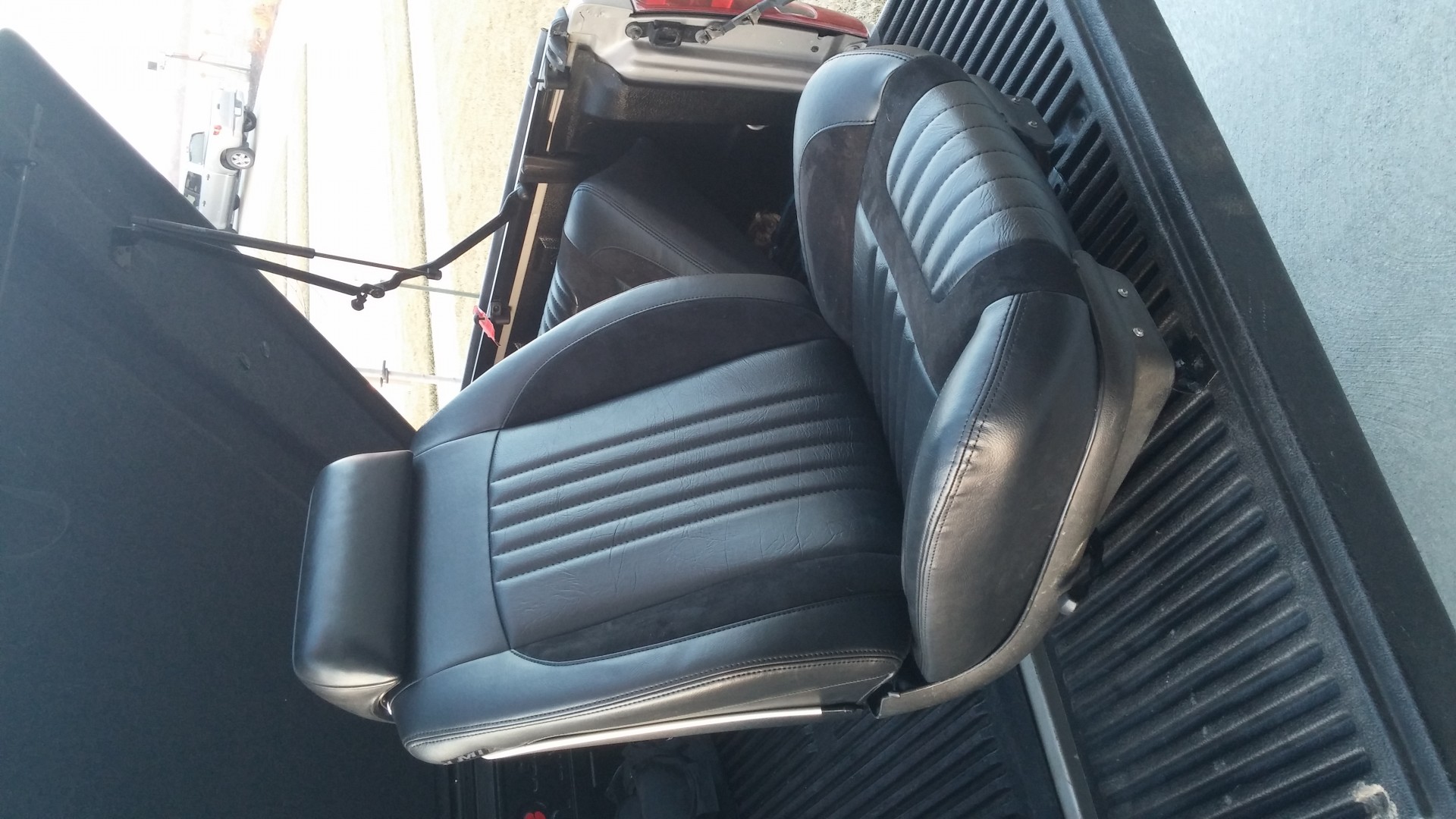

Got the fronts in today and went for a cruise since it was 65 degrees and an awesome day. The upholsterer is working with TMI to figure out what to do on the back seat cover that's a little too narrow.
The seats are a LOT firmer and I sit higher, but they seemed a lot more comfortable.
-- Edited by Lost in the 60s on Saturday 5th of March 2016 09:58:05 PM
Mar 6, 2016
I get dizzy leaning over that far...
Thanks Mitch for flipping it. It's the darn Android photo bug kicking in again...
Mar 6, 2016
Yep, every pic I see from a phone is sideways or upside down. They should include an editor to remedy that on the phone. As it is, you need to forward the pics to an editor to turn them. It's handy having cameras on phones but not so handy when you can't flip them.
