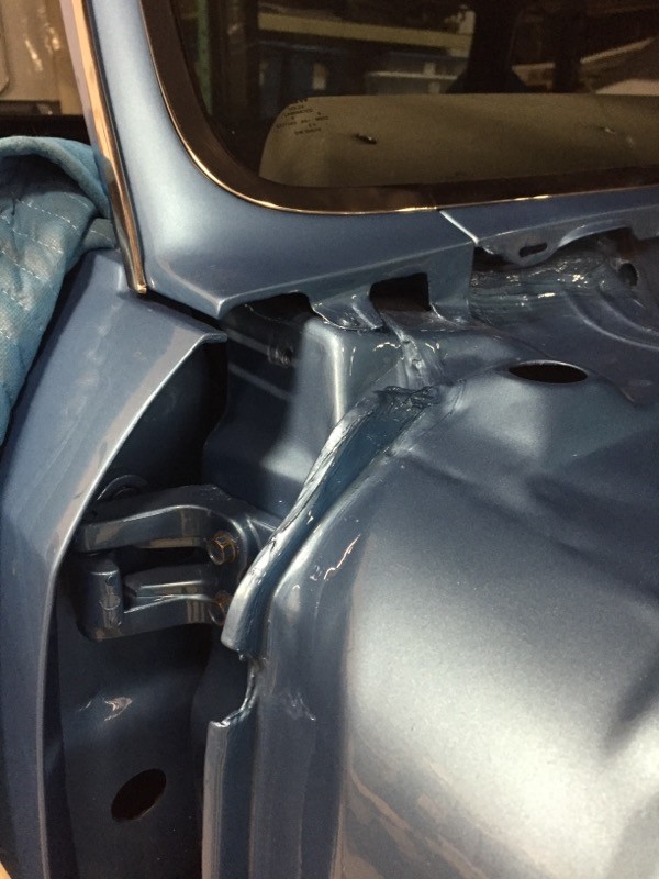

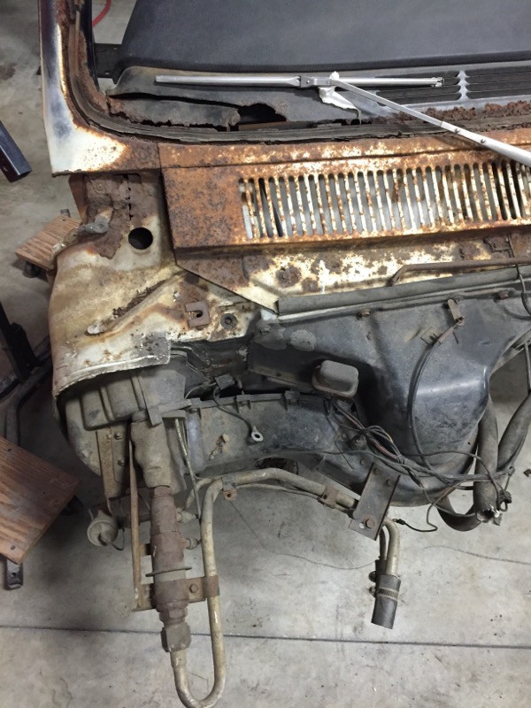

I would suggest removing the trim and evaluating from there. It may be you could seal up the leak without replacing any metal. If the lower windshield channel is rusted out, it gets to be a project. If the forward edge of the dash panel is rusted out too, it's a big project to rebuild that to look good and have the windshield fit properly again. The upper metal dash is welded in and as such may need to be cut out of the car for repair.
Jan 29, 2016
Proper repair is no small thing. See the dash being welded in the "pair of Elcaminos" post. There is an aftermarket part made that fits on the outside, below the glass, also a patch piece for the front, w/s area of upper dash. Both my cars have had the outer A/M part replaced and the complete upper dash installed from donor cars. I have a cowl with the glass out, will add picture later. This can be a major project. Karl

The green one with the tan dash is original, virgin, other than brushed caulking and paint.
The Blue one is the Big block Elky.
Black epoxy one is White 66 small block Elky.
Upper dash panels and outer cowl piece replaced in both.
LOT of work.

The white cowl is actually a remainder of a 4Dr. ht. car I parted out.
Saved it for the green Car- a/c dash etc. Black dash pad will go on the Big Block Elky.
It is really scary, however after 50 years these cars can get rough and be subjected to a multitude of "cover ups"
Both the ElCaminos were rusty, not as bad, but neither one looked terrible, until disassembled.

Both the ElCaminos were rusty, not as bad, but neither one looked terrible, until disassembled. Caution is advised.
And THAT is the understatement of the week. Most people have no idea how deep or bad their rust issue is from looking at a patched up car. I've learned thru some VERY expensive lessons, to assume the worst and be happy if it isn't.
You've got the right approach, John. Be ready for whatever surfaces and deal with it correctly once and for all.
