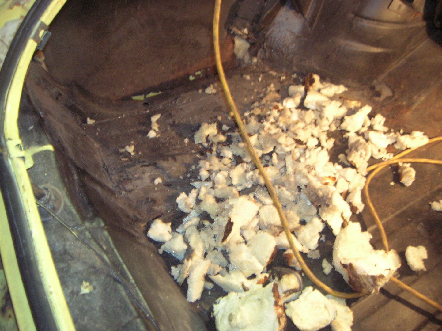

Here are a few pics of the inital areas i have delved into so far
1 Starting point, holes in the lower panel
2 The "great stuff" covered with some sore of undercoating on the opposite side
3 The area with the bondo removes and a patch panel (Yes i know i can buy new parts. Trying to get good at making then so i can do it on cars that they are not available for in the future. if it is a dud all that is lost is some time and something will have hopefully been learned)
4 Part of the pile of stuff i removed
5 The leaky gas tanks and Stan's old one that will go in once i decide what to do with the trunk. the reality is the all the metal (floor, supports, wheel houses and fenders) should probably be replaced. the good news the hinges seen solid

Still doing the assessment, and I'm sure that it is possible to get by with less. The point to ponder for me is where to draw the line, as this winters plan is to primarily just address functional issues. Mitch's point on the cost of getting it in one price to your door for ~2850 is a good question.
Perhaps they may charge more for the labor that we do for our own.
it would be the way to go, except i need the parts on top of the floor too
Jan 6, 2016
If the floor needs ~50% replaced, go the 1 piece route. You will spend 4 times as much time patching in pans and braces. I know our time doesn't seem valuable, but you end up with a better floor when done too. I will never again install a 7 piece trunk kit after the experience with my 2 Chevelles...
I also installed a 1 piece passenger floor in the GTO and it seems to take a long time to carefully extract the old one and then, you are done. The new one makes the time spent worthwhile when you see it...
The hard part of this for you, is the 1 piece needs to be installed from the bottom. It can be done with a couple floor jacks and cribbing, but is more than you hoped to get into this winter. You will need to brace the body well internally while doing this procedure.
As for the factory bracing above the floor, you can make patches for them from sheet metal.

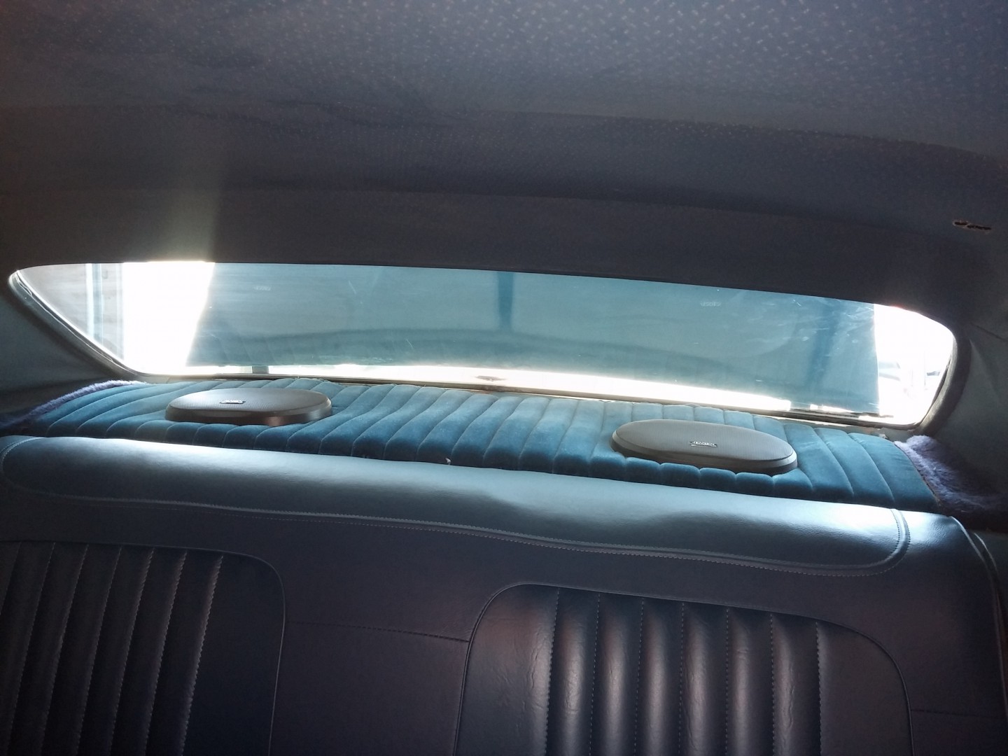

I don't want to steal your thread Bruce, but first of all I hope you are feeling better now. Nothing worse than neck or back problems. They can put a guy down for awhile!
I'm in the process of 'Stanitizing' the '71, and have already spent over my budget and have the dirty nails and sore muscles to show for it. Here's the 'short' list so far:
-Replaced the bad battery and starter with a GM style gear reduction starter the same as what Chris P. recommended on the vert
-Replaced front anti-sway bar and end links with a 1.25" setup
-Replaced all 4 cheapo KMart shocks that the previous owner installed along with 1" lowering springs that I had leftover from the vert resto
-Replaced the heater core and blower fan (heater core was disconnected by previous owner as it was leaking, fun job taking out the inner fender and most of the under dash to get to it.)
-Replaced the water pump due to my over tightening of the heater hose fitting when I replaced the heater core which cracked the pump casting...
-Rebuilt the Holley 670 cfm Street Avenger carb (1st time breaking down a Holley, and it turned out really good)
-Dropped the tank and replaced said fuel gauge sending unit
-Had the entire car polished/exterior detailed trying to make the paint a little shinier since the previous owner had it painted in acrylic enamel instead of base coat/clear coat (at least good enough until I may repaint it in the future... lol)
-Replaced the 80's tuck and roll upholstered package tray (best $20 I spent so far!)
-Got the factory AC running (required in hot Kansas...) by replacing the compressor (twice because of bad ones), evap, condenser, drier/filter, AC hoses, and converted all to R134A. That was where the budget was blown (pun intended), but it now blows low 40 degree air while tooling around town at 35 mph
-Installed new speakers and AM/FM/MP3 player sounds system
-Painted the grill black and polished the stainless trim around it
-Last night I finished the Jeep GJC steering box swap, so it drives MUCH better (drove it to work this a.m.)
-If time permits this weekend, I have a new air gap intake manifold on the shelf along with disty rebuild parts and plug wires that I want to put on the engine
-Oh, almost forgot I still need to install the satellite antenna for XM radio tunes
Luckily the interior has new upholstery, but they didn't replace the foam in the seats, so I'm going to have the front seat foam replaced in Nov. when we stop driving the car. The main reason for doing all this work other than I'm a glutton for punishment, is that the Chevelle club has a weekend Fall cruise in mid Oct. to Lake of the Ozarks, so I want it to be road worthy for the 2.5-3 hour drive down there.

The car has a lot of resto-muddifacation, bondo, long hair fiberglass, Great Stuff foam, and chunk-o-steel patches. i knew this when i bought the car, but seeing it ripped down to bare metal is a real dose of reality.
Also looks like the gas sending unit was at one time accessed with a chisel with out pilling the tank. then it was "fixed with RTV"
