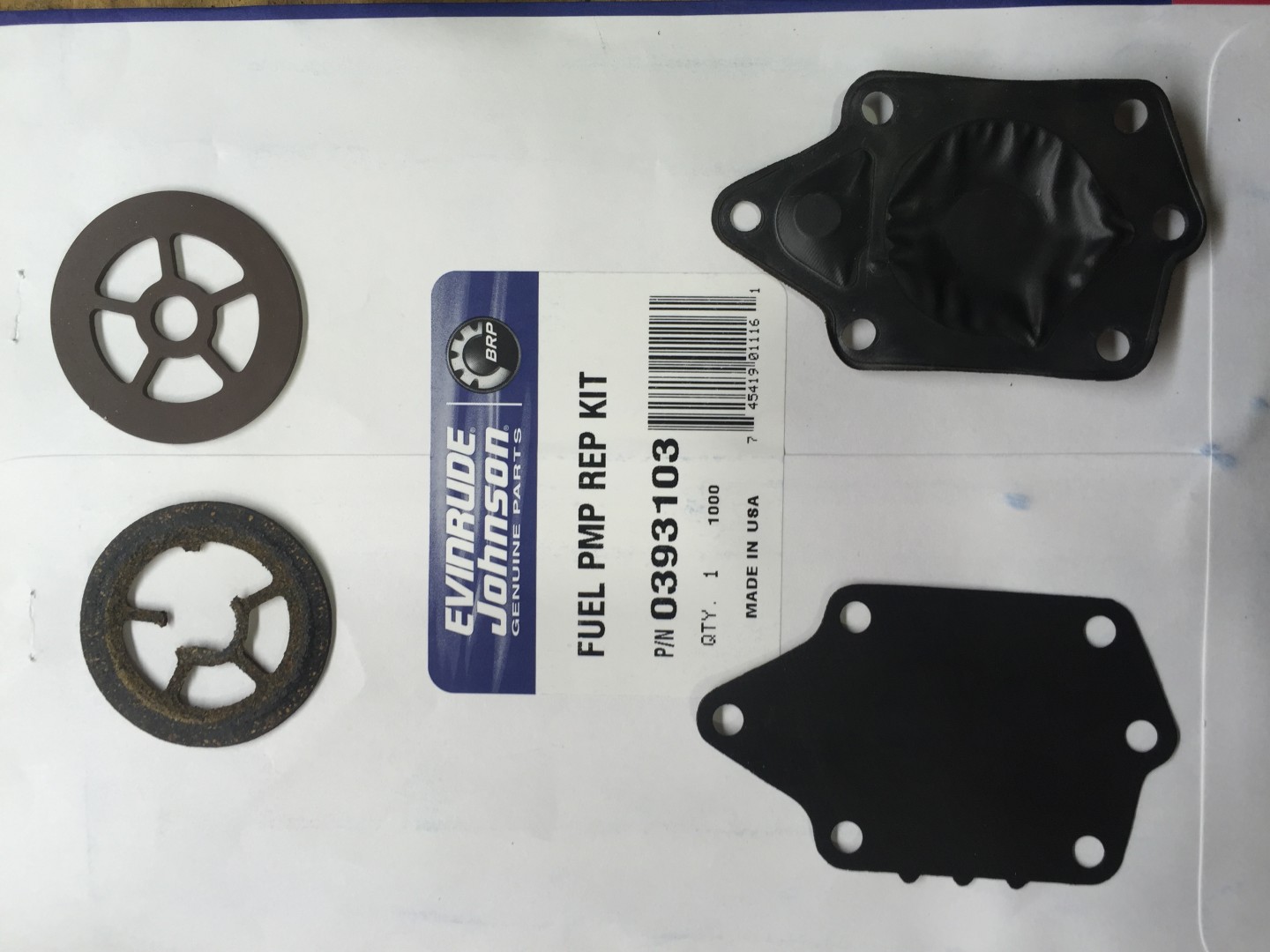

Finding parts for machines this age can be difficult. I got a carb kit which is readily available but no kit for the fuel pump. I have a different style pump in my toolbox that would work fine, but Mike and I are going to get together and do some searching for original parts to keep it era correct.

Mike has been doing some research on this old machine and found out parts are readily available for the fuel pump directly from the Evinrude dealer. I stopped and picked up a rebuild kit today and the parts look right, we are getting closer!
Carb has been rebuilt and fuel pump soon to be. Working on finding a gas tank and have a lead on one near home.
