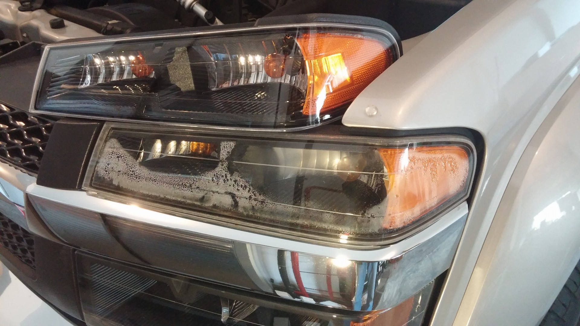

-Replaced the front park light lenses and lights since the seals were leaking and moisture was trapped in them. Found them for $20 per side through Rock Auto, and that included the pre-wired connectors and bulbs! Turned out the grill assembly came out pretty easy and 15 minutes later all was back together
