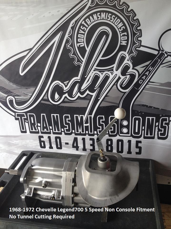

I'm thinking about upgrading to a 5 speed transmission to have overdrive in the Malibu. I have looked at a couple different models.
A Tremec TKO from American Powertrain. They shave material from the case and claim no tunnel mod is required in a 68 Chevelle. Or
A Legend LGT-700 From Bowler Performance Trans. Rated for over 700hp with reliable shifts up to 7500. Both of which is way more than I need BUT it directly bolts in, no tunnel mods needed.
I have done some reading online and most of what I see says that if you install a TKO in a 68 you will have to modify the tunnel. I spoke with American Powertrain today and they said it SHOULD fit with no tunnel mods. He said that the only problem they run into is when the body mounts are old it can create clearance issues.
Does anyone have any experience with either of these models?

The Legend LOOKS like a good alternative but I can't find much actual install or usage info on the web.

I asked about the LG-700 Legend and he said that is a direct bolt in, no tunnel mods. BUT... production is slow and they give no dates for availability.

Lately, I've had a lot of phone calls about the LGT700 5 speed. Mostly about the fitment into a 1968-1972 Chevelle. The LGT700 is the only 5 speed that will install without cutting the stock Chevelle tunnel. With the addition of the new smaller diameter "Can-Do" shifter, console cars are now included into that category. 2015 prices for this aircraft quality 5 speed rated at 700ftlbs with shift capabilities of 7500RPM start at $3995.00 #JodysTransmissions#LegendGearandTransmission
That is the Transmission I have had my eye on. No one has one in stock. I haven't called Jody's though, thanks.

When I was at SEMA I talked to the guys at American Powertrain about the LGT700. They Claim the LGT700 is no longer being made, could not compete with a big company like Tremec. Don`t know if that true, I still see them advertised.
I then talked to a Distributor for Tremec about installing the 6speed Magnum, he said if done right there is minimal tunnel work needed.

It has finally arrived! The LGT700.
I looked back to my original order date which was December 24 2016.....
This trans was built for someone else higher on the list that gave up waiting. Whoever that is I thank you! I have many pictures to add later.
I ordered the trans from Jody’s Transmission and he is great to work with. I got the call a couple weeks ago but did not want to post until I had it in my possession.

Test fit the trans and it does fit without modification as advertised. Woohoooo!!! I was so excited I forgot to get a picture.

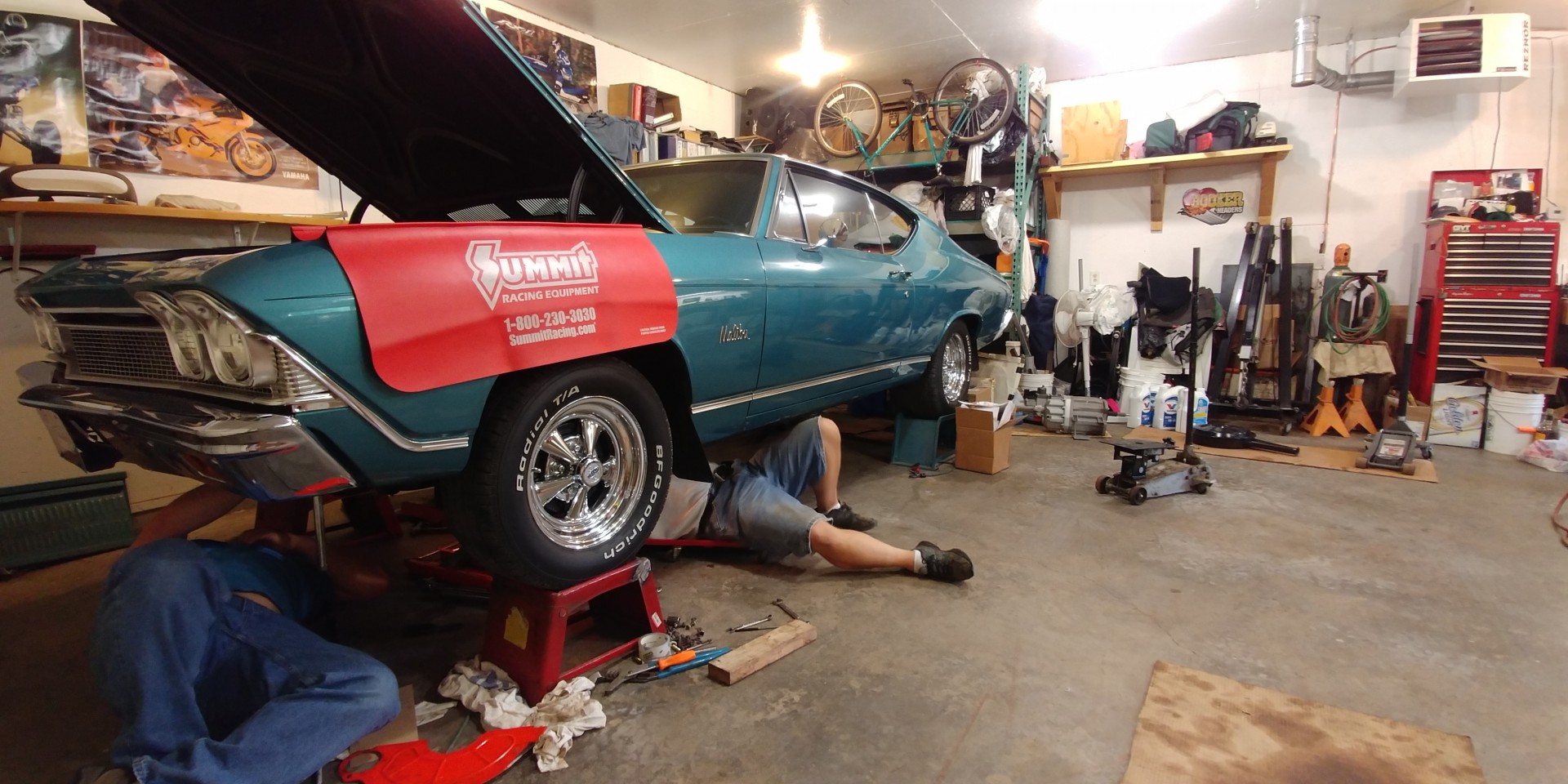

Measuring the bellhousing alignment has taken some time for me. I feel confident I have it correct now and ordered offset dowel pins today. Also stopped and ordered the driveshaft today, so now waiting for more parts. It will give me time to install the new starter I picked up yesterday.

Went to New Hampshire to visit my brother this week. I was back at it last night and got the old Bellhousing locator pins out. I have offset dowel pins to install and verify proper alignment before final assembly. Measuring took me a while, it is tough to do up inside the car!!
I plan to spend the weekend working in hopes to finish the project.
Jun 30, 2018
Spent the day today with help from Chris P. We got the car put together around 3:30. When I started it there was a bad sound somewhere we couldn’t pin down at first.
We learned the billet flywheel is a bit thinner at the mounting location so my flywheel bolts were carving a groove in the back of the block.... we had it apart before 5 to see the badness. Thankfully just a pretty line on the block so now I’m shopping for shorter bolts.
Never even got to let the clutch out yet!!!!

Adjusted the length of my flywheel bolts this morning and with the help of Chris P again we got everything put back together.
After some testing on jack stands it finally sits on the ground again.
I had to wait for the rain to stop but have about 20 miles on it and it works well.
70 mph= 2100rpm. You can’t even hear the motor running it is so smooth!

Here you go Chris S. A little pricey at 4 grand... but no cutting required and it handles up to 700 HP (If you are on Facebook, you can search for it too):
Lately, I've had a lot of phone calls about the LGT700 5 speed. Mostly about the fitment into a 1968-1972 Chevelle. The LGT700 is the only 5 speed that will install without cutting the stock Chevelle tunnel. With the addition of the new smaller diameter "Can-Do" shifter, console cars are now included into that category. 2015 prices for this aircraft quality 5 speed rated at 700ftlbs with shift capabilities of 7500RPM start at $3995.00 #JodysTransmissions #LegendGearandTransmission
