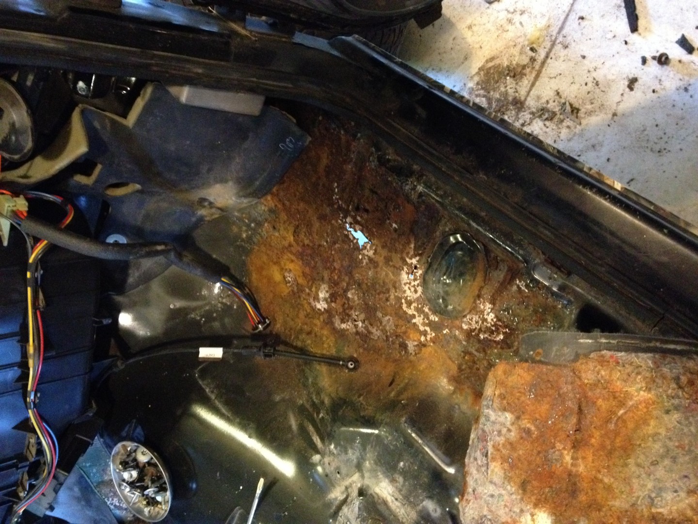

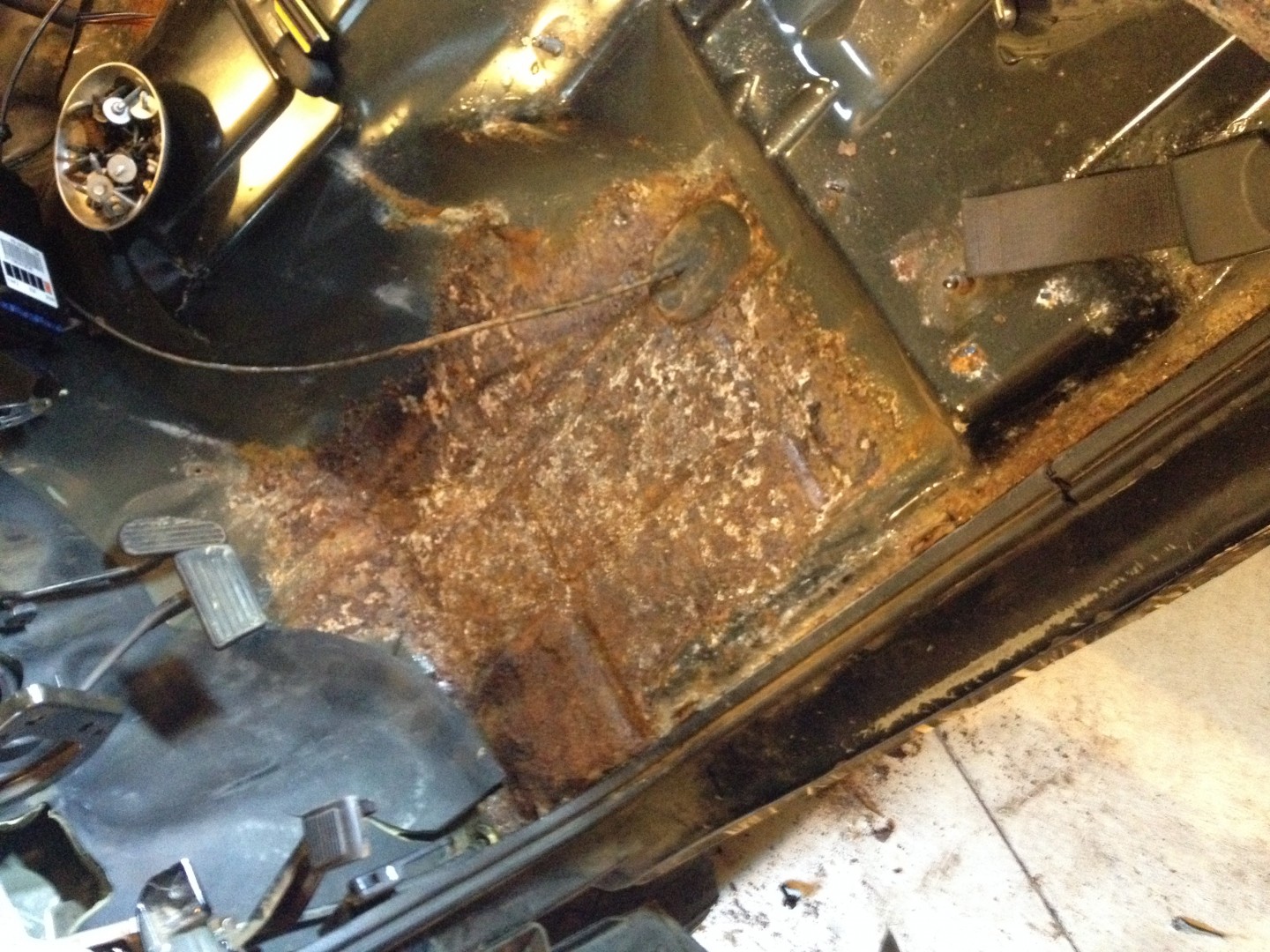

Well the project has gone on. I did end up pulling the dash and wiring harness. I decided that I just couldn't stand living with manual windows. I mean how are you supposed to roll down the passenger window while driving? It ended up being a blessing as I peeled back the carpet and got a good look at the floorboards. Turns out, that what you can't see from the bottom side, is visible from the top. RUST.
1. Open to recommendations on how to replace them. I could not find any aftermarket floorboards to replace them with so we are on our own. We were going to just cut them out and then throw in a flat piece of sheetmetal and shape to fit, but then we were worried about strength. Does it need dimples added, bracing, something for strength?

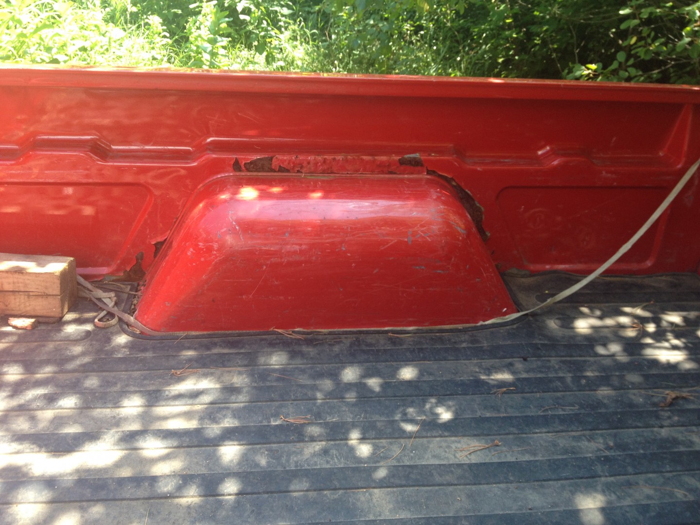

2. Got the bed off last night, and that is very solid, except for some of the cross members. There are some holes and we are looking for good ways to weld them up as well.
Take a look at the pics. I'll post some pics of my truck and the rust bucket that it is so you guys don't think I'm crazy for doing all this!

Confused... your buddy's "donor" cab is the one with the rust under the carpet?

Yea, from the bottom side, it looked just fine, hadn't gone all the way through yet. As far as we can tell the floorboards are the only signs of rust on the "donor" cab

OK, the available pans only go to '93, but looking at the pan in your truck, I would say they are close. I would consider buying the 93 pans for $150 and have the basic shape and reinforcing bead rolls to work with. It may take some "tweaking" to get them to fit right, but it seems they would be a lot less work than fabricating from scratch. GMC Paul's is in Indiana http://www.mcssl.com/SecureCart/ViewCart.aspx?mid=4B9C21F7-AC33-4308-AFCA-8EB5B6F2683E&sctoken=59dafc956ab74b81a8bd77c3dc5c8e90&bhjs=1&bhqs=1
The crossmembers on the bed can be reinforced with 18 gauge sheet easy enough.
