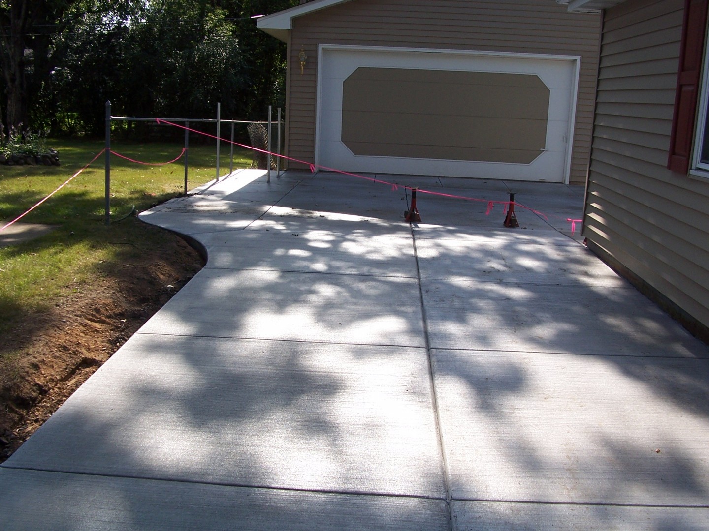

This is a project/job I've had kicking around for the last 15+ years. The floor in the shop has alway been a HUGE sore-point with me... with the surface failure, it's a total PITA to wash, sweep, use a creeper, anything. Now that the rest of it is finished off nicely, the floor keeps staring at me.

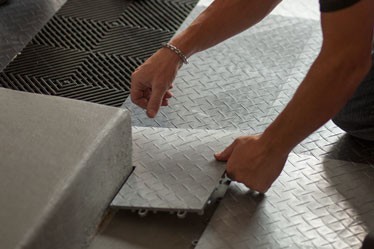

We un-boxed the flooring, and started to lay the tiles down. Working from the chalk lines and nudging the ever-building field square to them. After awhile enough were down it stayed put - then you can go crazy. Snapping down 40 sq.ft. in 10 minutes isn't even breaking a sweat - once you get the pattern down, and the "sex" of the tiles established it goes really fast.
All I have left to do is the special "cut-to-fit" pieces to go under the edges of the benches, and where it butts to the walls. I'm guessing this will take 3x longer than the entire field did!

Sheryl did do an awesome job! It was all I could do to check the layout sheet, grab 2 x 2 panels, and flop them down fast enough, she'd stomp 'em into place.
From opening the 1st box, to being at custom-cuts at the edges (including a beer/wine/yackety-yack session with the neighbors) was about 2-1/2 hours.
I was correct about the custom-cuts taking 3x the time of the field. I was out there tonight and finished 90% of the north & west wall - where I had to make notches out of full tiles to fit around the bench legs. Following the rule of "I cut it 3 times and it's still too short"... wait a minute - "Measure twice, cut once" - it took about 3-1/2 hours to lay down about 40 tiles.

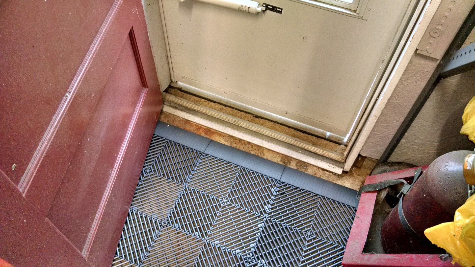

Since the floor is now about 1/2" higher I'll have to trim off the bottom of the ped door. Can't finish that corner until the door is cut.

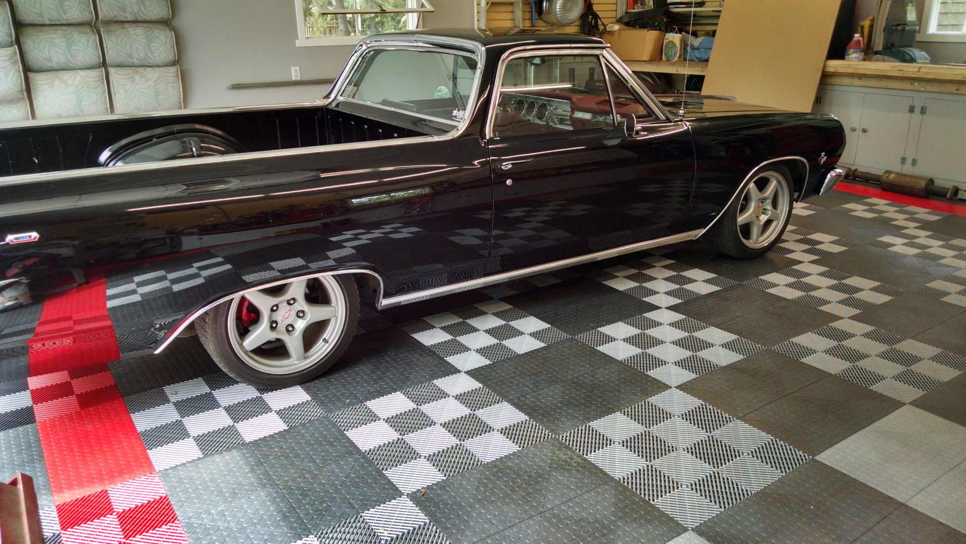

Brought "Blackie" home for the week... seems to like the new floor.
Did an experiment or two. One of the things I found during research of the floor system is that others were complaining about when they'd roll up the garage door, and in full sun exposure the tiles getting baked would buckle/heave. My garage faces east, so I opened the door about 8am and let it go. Even at 11:00 after 3 hours of blasting sun I had no issues. (Remember this is a combination of their premium RaceDeck and lesser-grade GarageDeck products). It just layed flat and stayed there.
Another problem was that the entire floor system would shift/slide. I think Jon mentioned this, his car used to hit so hard into reverse the whole floor system would slide an inch. I haven't seen any evidence of this happening in my install. (I could see if you came into the garage "hot" and had to stomp the brakes it might happen). My thought is because my concrete floor is so rough, and slightly uneven that the drain channel system on the tiles has a little "tooth" to grab on, and doesn't move... a brand-new smooth floor may have some issues.
I followed the install recommendations and maintained at least a 1/2" gap around any obstruction or obstacle, such as the walls, bench legs, garage door tracks, etc. I also staggered the starter/ramp tiles at the overhead door edge by 1/2 tile, creating a "T" intersection instead of a straight joint to joint. I don't know if it will help at all, and it wasted 2 ramp pieces, but we'll see.

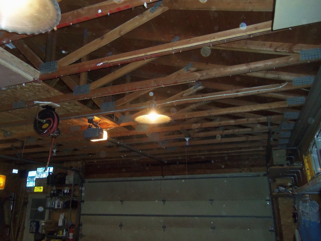

The "40 Watt" is not a purpose-built shop. It does multiple duties, and primarily is storage for the daily drivers. All winter long there was the in & out of the drivers, with the corresponding crap being trailed in... sand, salt, slush, drippage...

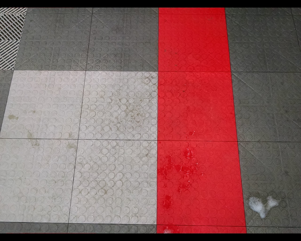

Today I did a spring cleaning. Total time about 2 hours. Step 1 was hitting the floor with the Shop-Vac, and sucking up the leaves/sand/crud off the floor. This still left a LOT of salt stains, and dried dirt puddles on the floor. Step 2 was a bucket of water & floor soap, and a rag-mop. (Actually two buckets of water - after 50% done, the water was more mud than water)
The floor looks 98% as nice as it did out of the boxes when we put it down. The only difference is the "sheen" of the plastic is gone (I'll attribute that to the chems and mold release off the plastic is now gone). NOTHING sticks to this stuff. All of the dirt, salt, and even the rust stains from the snowblower just wiped off. There was really no effort in cleaning it. Just mop/get it wet, let the "stuff" soften up, and mop it away.
Looks like it held up well over the little winter that we had.

Yes, the diagonals are what they call "full flow" tiles, and are open to the surface below. Anything smaller than a 10-32 screw will fall through, but nothing that a magnet or needle-nose won't save.
My concrete is no where near what you'd call level, or even pitched properly. There are many areas where water would pool in the field, and even run to the walls (not towards a door!). I corrected/minimized most of them with leveling compound, but water will still puddle in areas. Knowing this going in, is why we chose and assortment of solid and vented tiles.
The backside of all the tiles have notches for water to flow under. Naturally the water will eventually get to a low spot and sit. It evaporates pretty quickly with the vented tiles. The "crud" left behind can be sucked out with a shop vac. I am anticipating that every few years I'll have to pull up a section of floor at a time, and really suck up the crud.

What do you do if you need to jack up a car on these?
Sharp edged things like cheaper jackstands will dig in and make a dent/cut, and my floor jack will make a dent where the wheels were (but it "grows" out).

Just discovered the thread. Boy does it look great. I have to quit looking at the pictures or I might be in for a lot of work.
