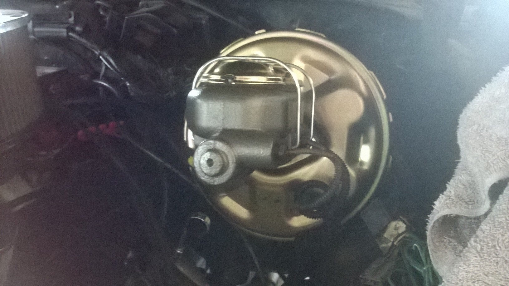

Update: Chris put in a new master cylinder for me. Mine leaked and one of the reservoirs was dry. I went over to assist with bleeding the breaks i.e. sitting on a milk crate pumping the pedal. I also brought along the wheels to throw on after the brakes were finished. Looks much better now! Brought my storage wheels and bench seat home. Anyone have an idea on what a nice recovered black bench for a 71 or 72 is worth? It's going in our classifieds and on Craigslist as soon as I figure that out!

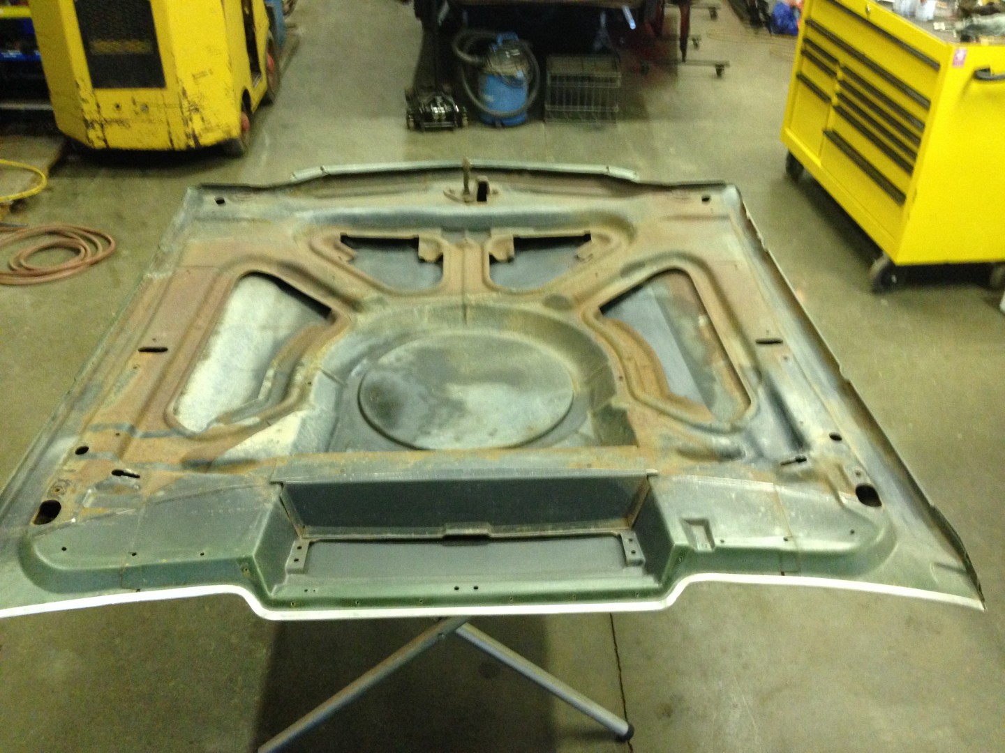

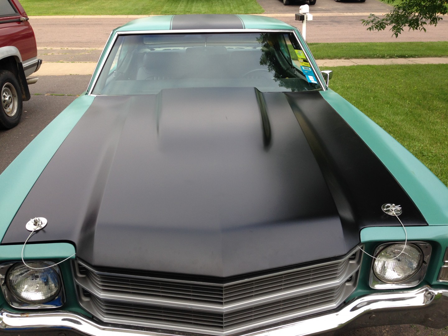

As Chris mentioned earlier in the thread I sold the hood that was on my car to his friend Chad. He is doing a 70 Chevelle SS and he needed a hood and that one was a 70 SS hood. I had an SS hood (in the back ground of first picture at start of thread) off the 72 El Camino I parted out a few years back. I wasn't planning on selling my hood until I had the car painted in the future. So now I need to put my other hood on the car but I didn't want to throw it on as it was. Luckily for me Mitch is a very willing and talented mentor with a well equipped shop! Mitch is responsible for the hood now being Hot Rod Black (satin). Thanks Mitch!!! Sorry the pictures were in order and all right side up on my computer and when I selected them for attachment. They take too long to load to mess with them to try and correct!

Brought the hood over to Chris' and we put it on the car. Then we drilled the holes to mount the hood pins. I think it turned out well. Then I drove it home! Then unloaded all the boxes out of the trunk and took Shannan for a short ride around town.
It does look really nice. Can't even see the bug tracks in it...

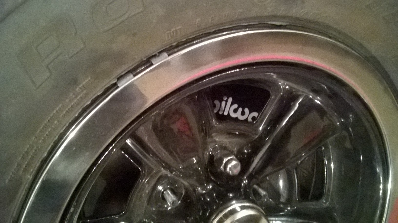

Finished accumulating the major parts for my disc brake conversion with help from Jamie, Chris P., Amazon and Jegs. Dropped the car and parts off at Pittstop Performance. Should be much more enjoyable and safer to drive once the brakes and sway bar are installed and since I'm not turning the wrenches myself I should get to put some miles on it yet this fall. 😃

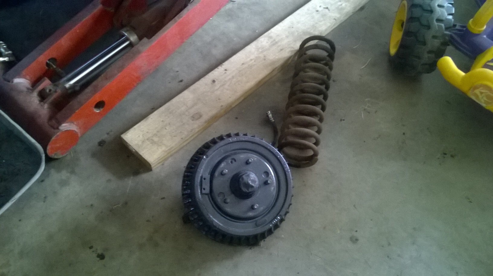

We are on to phase 2. Rebuild front suspension with poly bushings, new ball joints, and disc brake swap.

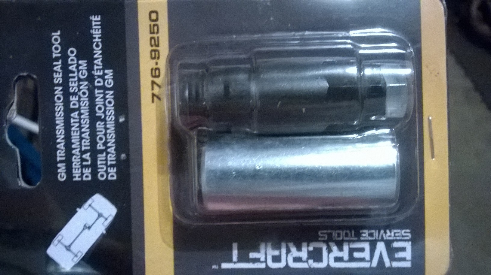

So I bought a new tool that I thought others might like to see or use. Mike's transmission was leaking and it looked like it was coming from the shift shaft seal. I have seen the videos of people trying to pick out with screwdrivers and such and spend probably hours trying to get it done. This tool was $8.00 bucks through napa and I had it out and back in in less then 5 minutes.

Yeah, I have a couple of those pesky leaks myself. For 8 bucks, I will just get one and have it on hand.

Anyone have the Readers Digest version of how it works?
Sep 13, 2015
It is real easy Kevin. The black colored piece is tapered and threaded on one end. Start that end into the seal, I gave it a couple taps with a hammer and then screwed it in with a wrench. It has a hex head on the other end. Once seated in it has a thread bolt that goes down the middle and pushes in the end of the shaft to pull it out of the transmission. The silver colored piece is for tapping he new seal back into the transmission.
When installing the new seal I started it and used a small pick to make sure it was all the way around the shaft and then tapped it the rest of the way in.
