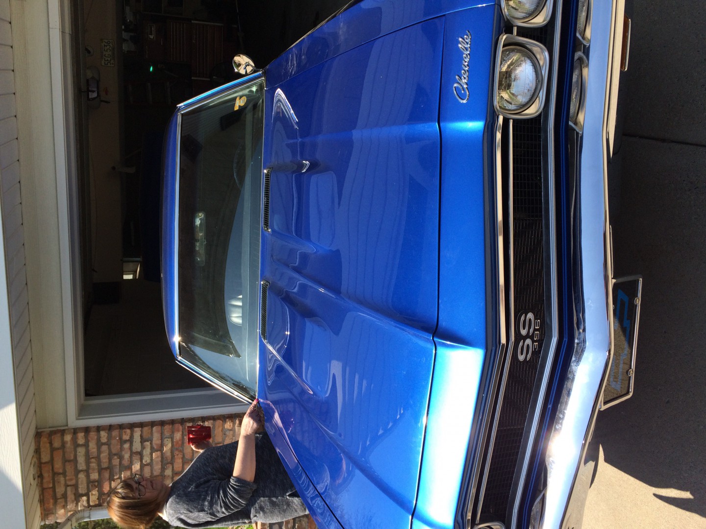

wondering if anyone has some advice. We have a 540 big block and we are trying put back the SS hood So we don't hav to have the cowl Hood on. Just looking for some advice if anyone has any tips.
Are you just wanting to make sure the stock hood with have clearance and still be able to close?

Wondering if we need to switch intakes to make the hood close
May 4, 2015
Which intake are you running there? Photo doesnt show much and I see both photos are now sideways for some reason. They were fine this morning. I believe the Edelbrock Performer RPM will fit but not sure if the Air Gap will fit, I also believe a Weiand Stealth will also fit under the stock hood but dont quote me on that. Most aftermarket intakes will need a drop base air cleaner.
