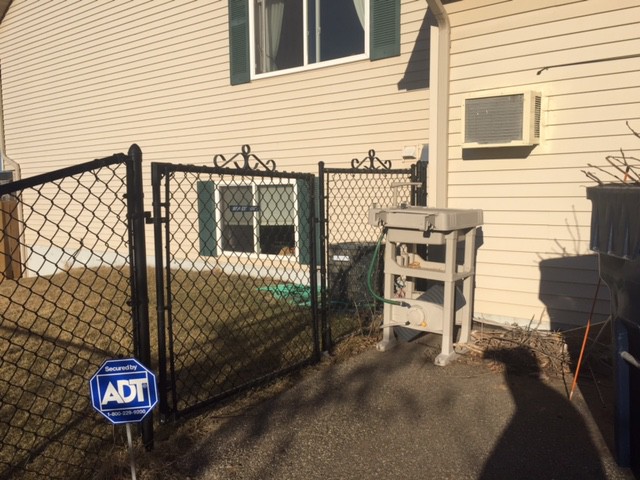

The shed is sitting on pavement next to the third stall going to gates into the backyard looking at the picture. Once the shed is gone should be able to drive right into the back yard it looks like.
Once again, you are right. I was at his place once and thought the shed was behind the house. I remembered there wasn't much room beside the building to the sidewalk, but it is the shed.

Correct the shed is leaving shortly. Then I will have a straight shot from my driveway past the third car garage. The original owners extended the driveway to create a parking pad there. I modified my gate so I now have an 8.5' opening. I can drive right down into my back area. I will be putting in some sort of a drive able pathway down.
