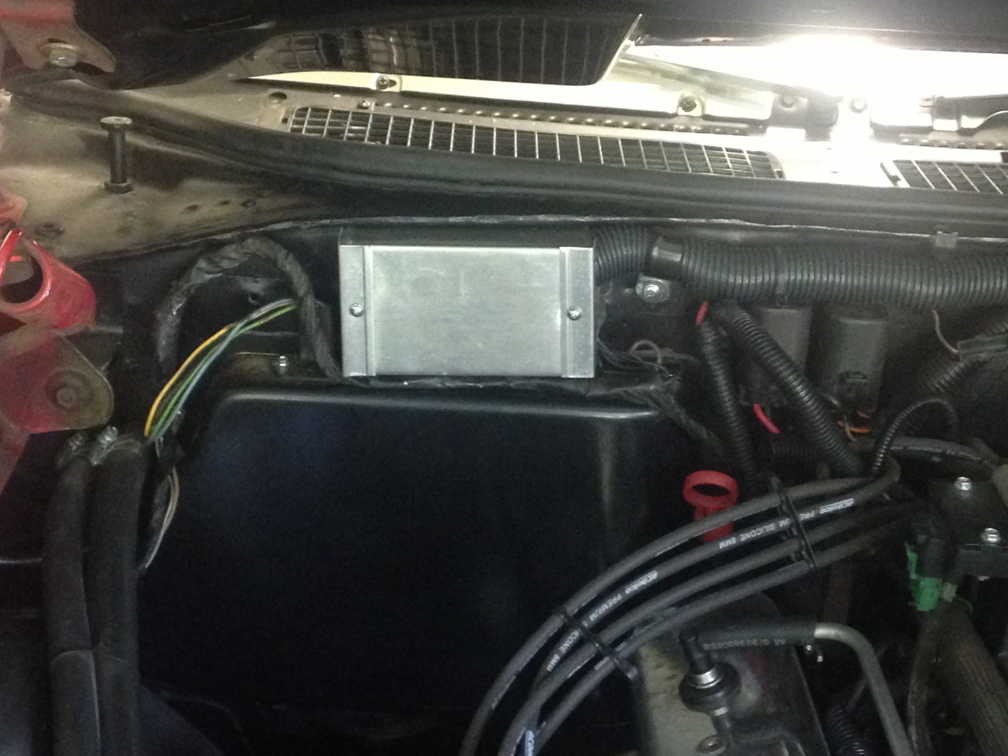

I don't have a picture of it handy, but it certainly saved some space and cleaned things up. I didn't hack out my harness yet, so it's just hidden under a "what is that thing?" cover I made.

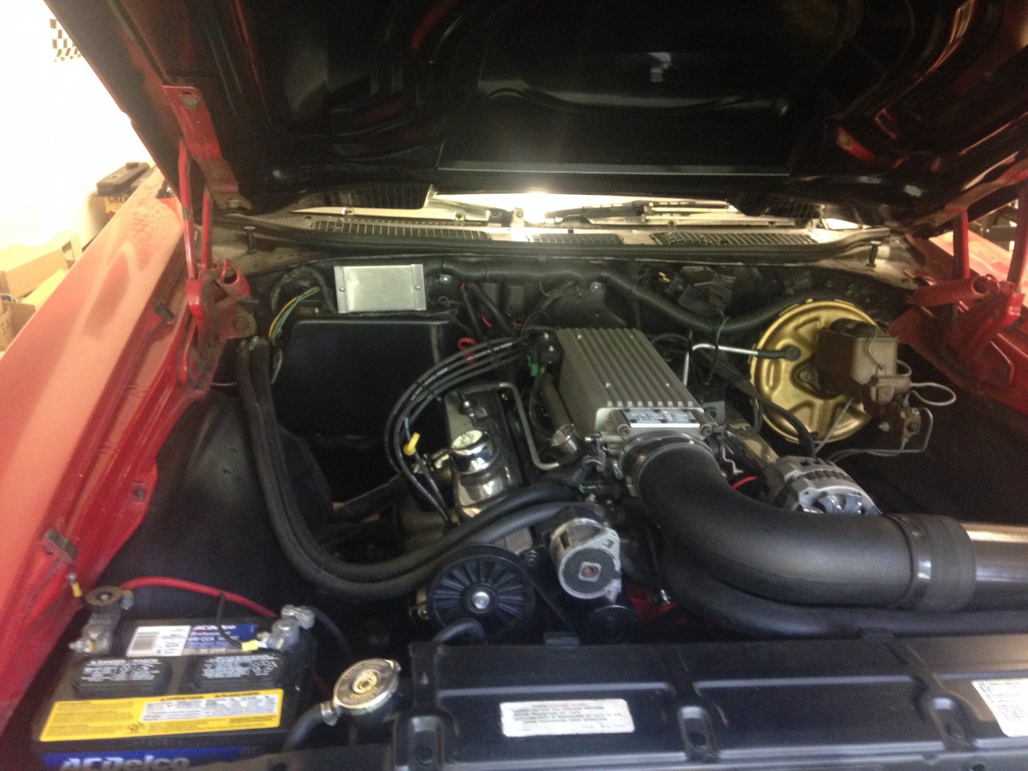

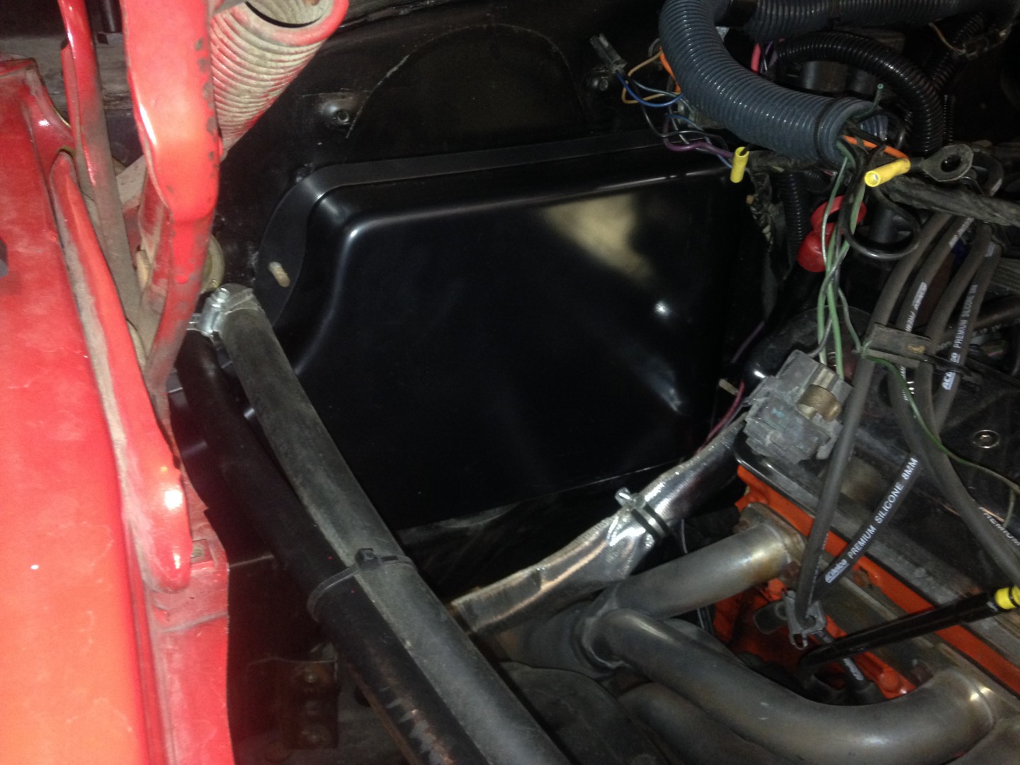

I did a quick write up in the May 2014 newsletter. Here's some pics that weren't included. The lip on the firewall hole was what the fan gerbil cage was rubbing on. You can also see the silver box that's hiding the wires for now.
That looks great Bryan, thank you. I have been wanting to do this since the rest of the hardware is now out. I move in to full car mode in 9 days which actually doesn't leave me a lot of time as I like to drive the car a few weeks before the first race ... especially since I will have a new engine!
