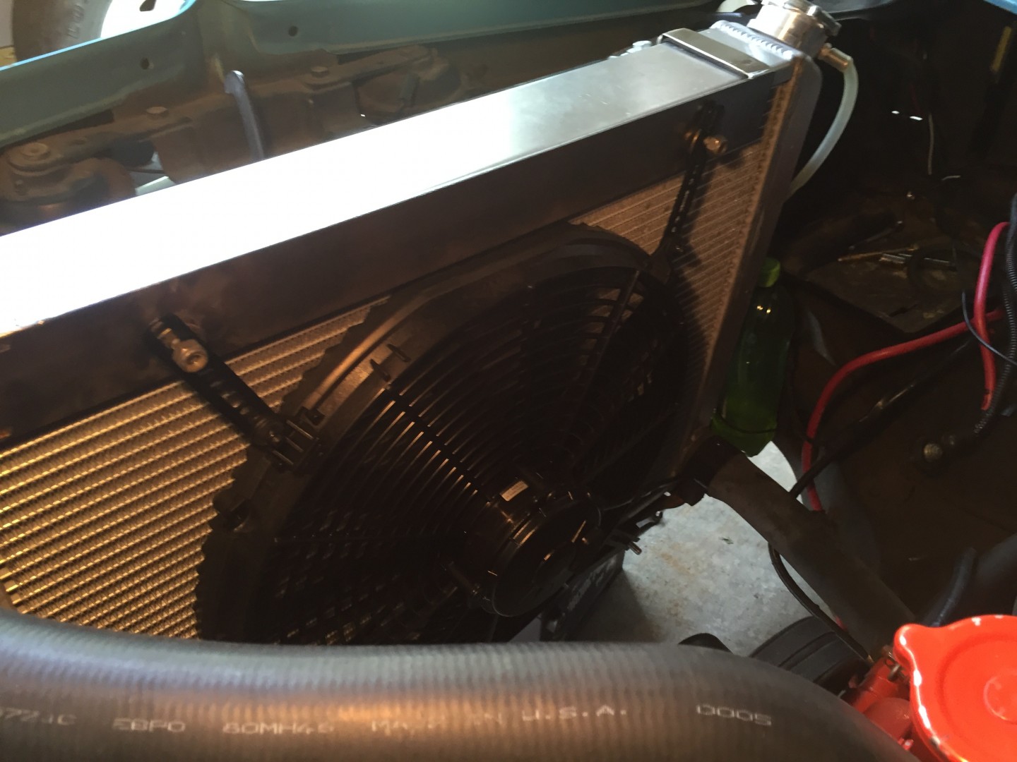

After more testing in the driveway I have found that I am not moving enough air through the radiator at idle.
I have decided to go electric. 16 inch Spal puller controlled by a Dakota Digital unit. Got the fan in yesterday, wiring this week.
