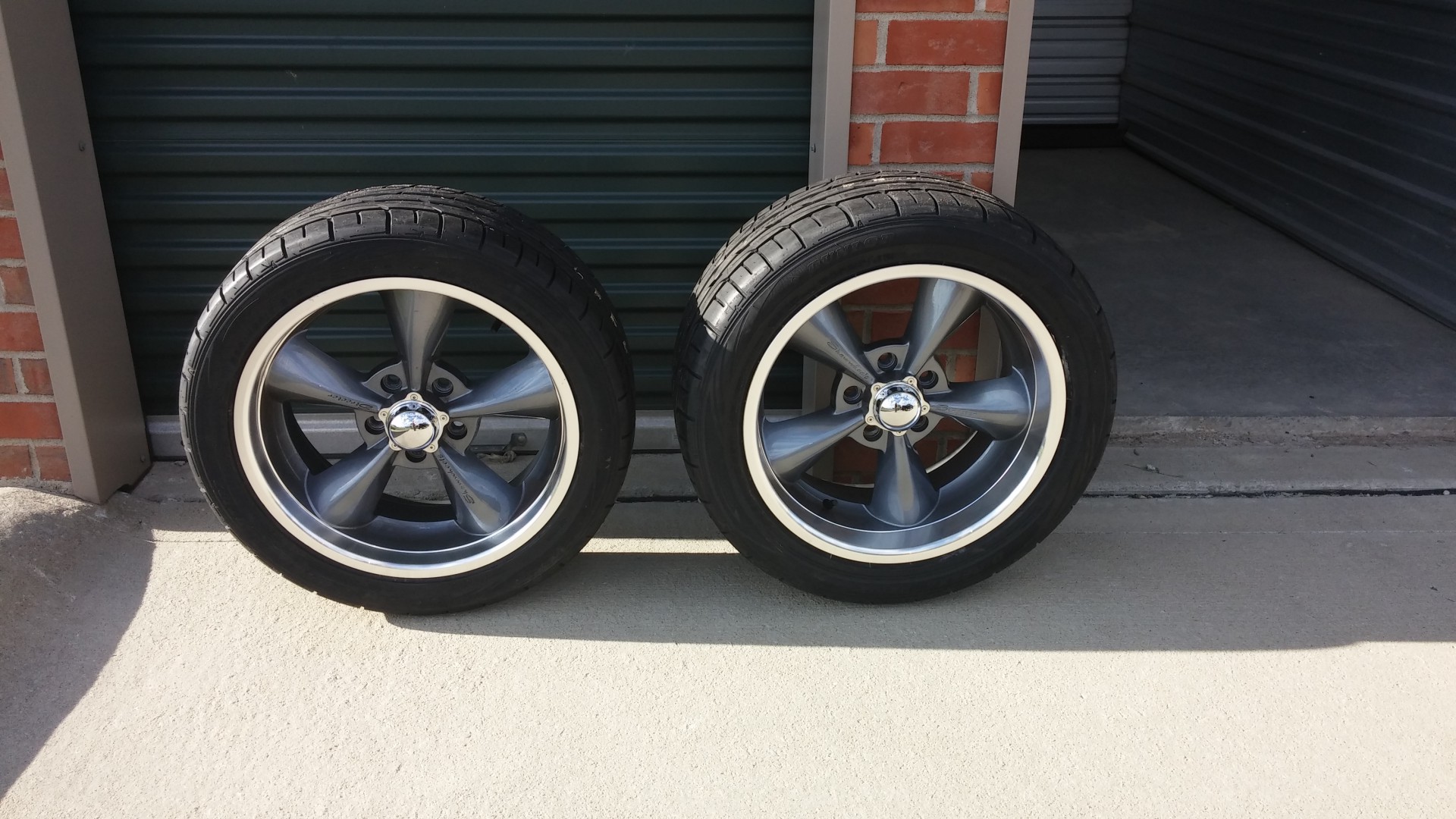

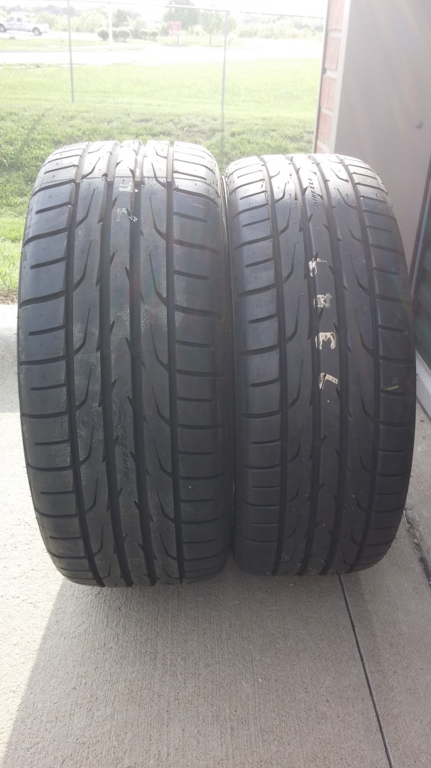

May 11, 2015
Update... I ended up going with Dunlop Direzza DZ102's. Got them installed on the rims today, but still need to put them on the vert to see how they work out. They were a a reasonably priced summer performance tire, plus I get a $20 per tire rebate since my father-in-law is a Goodyear Associate.
The fronts are 1" shorter than the rears, so I think it will give it a good rake, while filling out the rears better.
Front: 225/45R17
24 & 5/8" Tall
Rear: 245/45R17
25.5" Tall
Sorry for the giant size pics, but I don't know how to make them smaller since my phone camera is on 'normal' setting for the size...
Front: 225/45R17
24 & 5/8" Tall
Rear: 245/45R17
25.5" Tall
