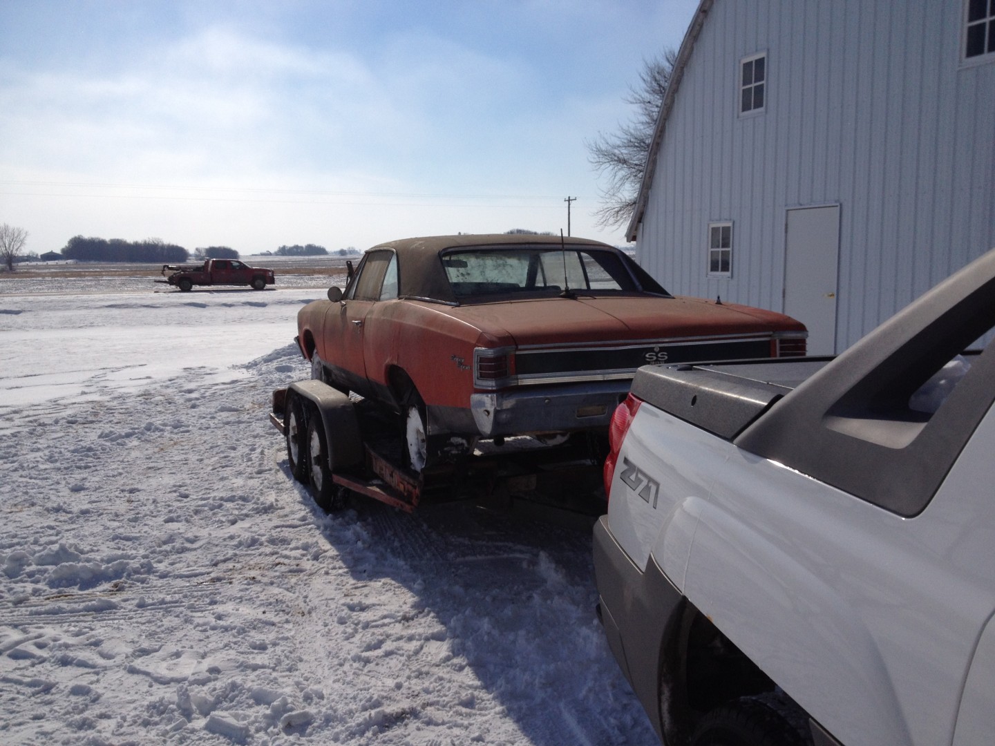

I have been looking on craigslist, ebay, chevelles.com forum and cant seem to find a 67. I have a correct dated 67 10 bolt (sorry John, non posi) and no clue the history of why a 10 bolt is on the car, but would it make any sense to rebuild this? (put in new axles, posi, gears, etc.)
Here is the only pic I could find. I bought the car last year after finding it in a shed about an hour south of Mankato, it sat in that shed for 25+ years (last tabs on the license plates were from 1987).

Awesome barn find, Bryan, it even has the hay on the hood. :: Jealous :: !

Found a few more pics: 2 from last year when I got the car (I believe it was about 18 degrees out). We had to call a wrecker to get the car on the car trailer. Next is the engine after the rebuild at the dyno.

That is such a cool car, including CB antenna. I often look at old cars like this and wonder, if it could talk what would it say, what story's would it tell about it's past. Or what it sees in the future. It must be happy to be out in the daylight again. Maybe something about being sideways in first gear and missing second...or something that went on in the back seat at the drive-in.
OK, I understand I'm overly sentimental about old cars and airplane's but if your a car guy and it's in your blood and your say 45 to 47 years old it all could have started in the back seat of the is car.

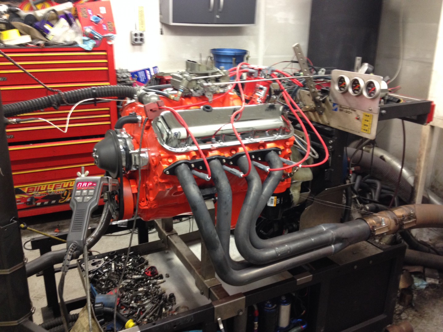

Thanks, I did get the Muncie fully rebuilt about a week ago from the local Aamco shop. All the old school local car guys said that the guy there was top notch so I went with him. I believe the current plan is to get it running and drive as is for awhile.... we'll see. I had TC Auto (local shop) do the rebuild, the engine was 325HP factory but after the rebuild it came in at 368HP with 434 ft. lbs. of torque.
Those are nice numbers for power without being crazy or temperamental...

Do you have the cam spec or grind number and who from. I need to pick a cam for my buddies 396 and this will give me a good starting point.
I went with the COMP Cams Xtreme Energy Cam and Lifter Kit CL11-238-3. I did have to bore it .60 over due to mice living in one cylinder and pitting it out.
