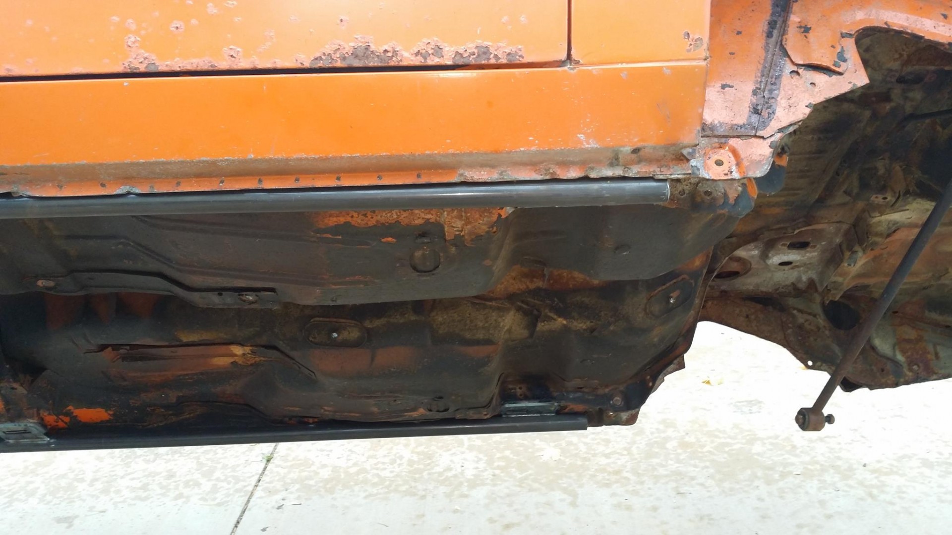

I am at that point that I need to figure out how to get the underside of the car cleaned to bare metal. Ive heard that blasting wont penetrate the factory undercoating very well and need to know how you guys have done yours and what works and what doesn't.
Scaler? Heat and scraper, chemicals, someone for hire?

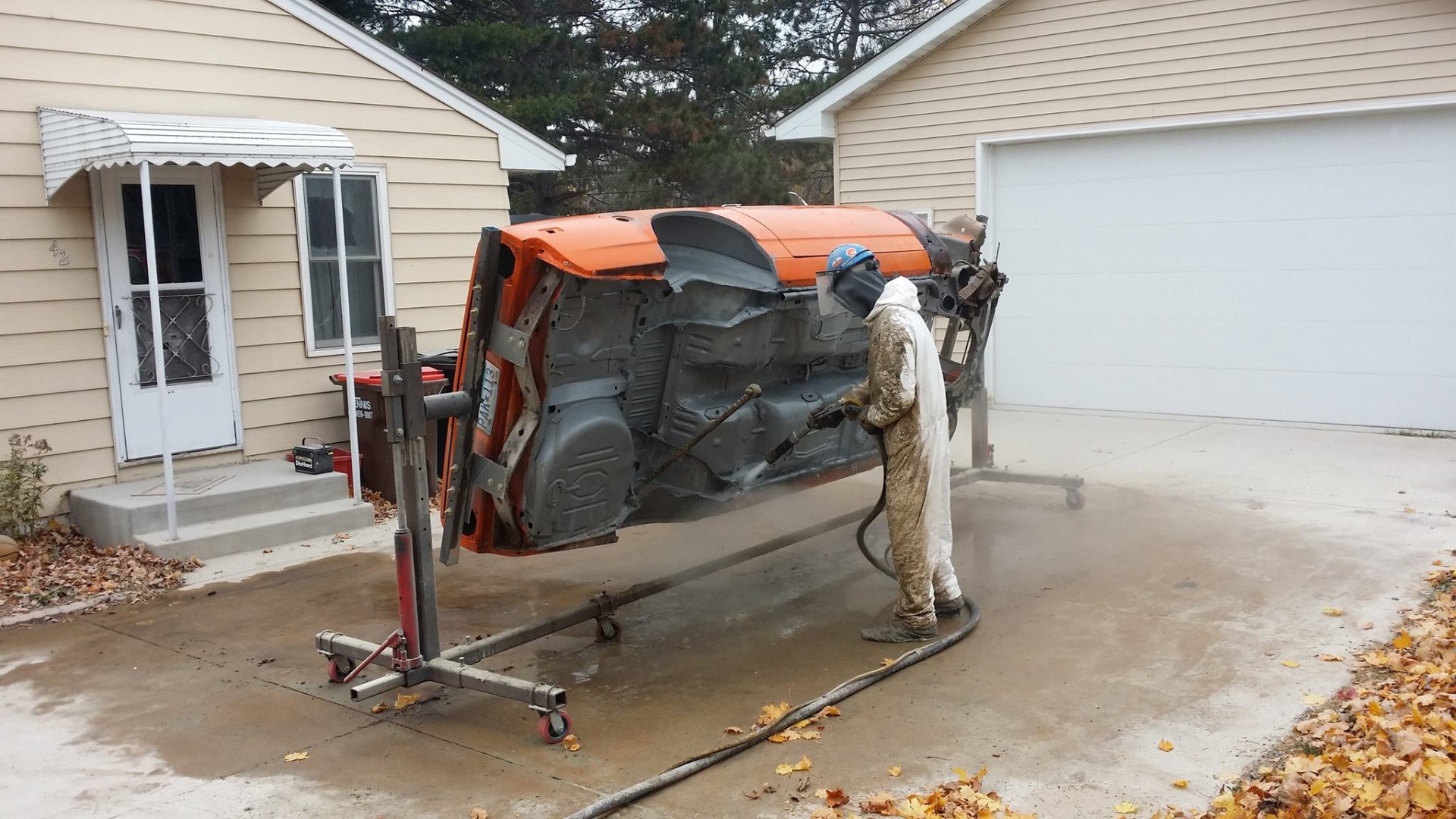

Had the blasting done today. They used a slurry system...
http://youtu.be/Ks_AYZRv7x4
Looks like the roto worked just fine and the blasting cleaned up the underside...
