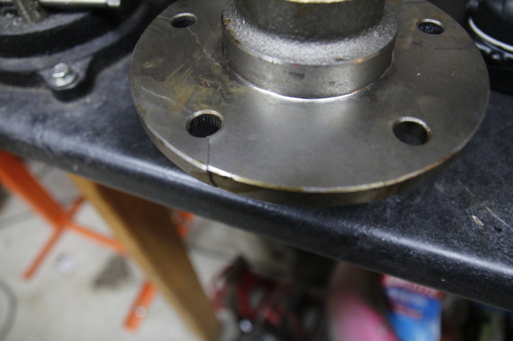

Gearlube... What method did you use to install the longer wheel studs? Press, vise/spacers/squeeze, or "stack-O-washers" & impact?

I went and got a 12 ton press and used it. I pressed the bolts out fine. Then I greased the bolts and pressed them in. I flipped the hub over and saw the cracks. No vendor bashing here at all. These are simple facts. I don't give a crap about the vendors side. Not blaming CPP. Just blaming Chinese crap. Yes I am bashing the 8 year old Chinese kid who made my part. I bought all my other components from CPP and never had an issue. I will continue to buy from them in the future. I decided not to call them on this because I know they will want me to send the parts back. These are not light. So it will cost me $30 to ship back to get $55 back. Not worth it to me.

I contacted CPP. I told him what happened. The guy was nice. He put me on hold and came back and stated this would not be covered under their warranty and I am most likely out of luck. We went back and forth some. He suggested He can escalate to MGMGT for a escalated decision. I emailed him my pics. They are below for your reference also. So I guess we shall see. He didn't seem to show any interest if it was a safety or compromised parts issues by the way.
Randy,
I also purchased among many of your other products the C5 disc rotor/caliper conversion. I had an older set of small disks that I wanted to replace. The standard stud in the drum hub including yours is a 7/16 20 1.5” long stud. This will not work and be long enough through your rotors to really fit any wheel. So I knew I had to press out the old one and press in the new 1 ¾” studs. When I press them in with a proper 12 ton unit and arbor plates, I flipped it over and was shocked to see the metal cracked all the way through! I pressed them back out to see if they could be repaired. The cracks are all the way through and they are useless. I have pressed many, many studs including ones for my oem rear axles, and never have I seen metal like this crack. I talked to some friends who work in a welding shop and they stated the metal should not have cracked like that with a stud using arbor plates and it was a cheap metal containing fillers. This was an opinion only. I would hope CPP stand behind their products quality. I have bought many parts through CPP and this has me very concerned. I would appreciate a refund and a return shipping label.
Below on the top was the original 1.5" 7/16 20 stud with a .742 knarl.
Below was the new stud 1.75" 7/16 20 stud with a .742 knarl
-- Edited by gearlube on Thursday 28th of August 2014 01:02:23 PM
-- Edited by gearlube on Thursday 28th of August 2014 01:05:56 PM

I got a response from tech.
""‘This damage is not covered under warranty. It doesn’t sound like the customer used the proper tooling to press the studs out, he may have used arbor plates and a press but you have to support the area around the stud as we do here, the arbor plates allowed the iron to bend and crack as he did not support behind the stud. Any time a part is modified from its original state it voids the warranty (as in pressing out the studs). We have forged aluminum hubs which are meant for disc brakes with longer studs in stock which could have been purchased.’ ""
I am not going to argue with them. I used the same method to press out and new studs into my rear OEM axles which are 45 years old. Then the Drum Hubs I got from my friend Jessie, I pressed the old stud out and the "SAME" stud in using the same arbor plates supporting the hub and no cracks. Those are 48 years old. I don't blame CPP and will buy from them again. I as a consumer have a choice to spend more money on more expensive or cheaper stuff. However I bought their C5 kit which states that it can be used over your drum stock hubs and studs. This is just simply not true. My wheels also have a shallow hole, but still needed the longer stud.
As always we educate ourselves and live and learn. We all have come across bad parts here and there. While I am disappointed in their decision I understand it.

Looking at your pics (especially #2) it would appear that the iron is just brittle - some impurities or a lower grade formula. I'm no metallurgist, but the hub/rotor should be "soft" enough to conform/meld into the knurls of the (much) harder studs. Who knows... maybe the mfg heats the hubs before pressing in the studs - that bit of expansion would allow the stud in (without cracking the casting), and when it cools there's no moving it.

originals I believe are forgings. These are probably cast.

Yep, these are sand cast. Take a look at the top non-machined area of the hub in the pic where the wheel bearing goes. The bumpiness on the outside is from the sand casting process.
Those cracks at the stud holes do look pressure induced since the material is deformed around the holes. Hate to say it, but I agree with CPP's assessment and root cause of the damage.
Tom, did you measure the O.D. of the knurls before installing the new ones? Were they the same diameter? If not, the combination of the oversized knurls and too much pressure could have caused the cracks IMO. Not all wheel studs are created equal, they can have different size O.D.'s.

Stan they are the same size knarls. .472. I used a digital measure caliper to check. It is what it is.
