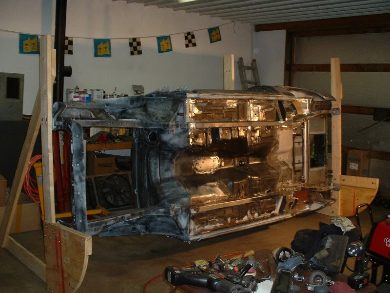

That would be the "dashboard" version! Made out of that wierd cellulose-based material (wood)...

I like the wooden rollover stand looks easy to build and there’s room for improvement. Make it roll both ways, install wheels, stiffen it for transport. Make it adaptable to a four post lift to remove the body from the stand and install it back on the frame. When the cars done you can toss it on the bonfire and roast brats and burgers.

They can work for that but plan on a lot of time and material to make them stable enough for a body.
