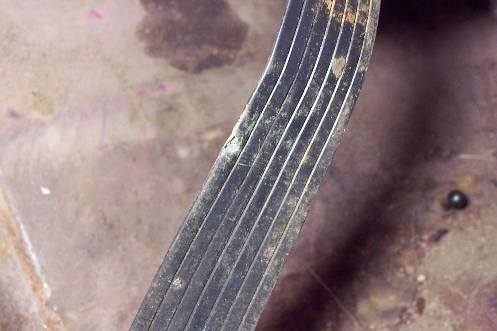

this is a pic of how mine was, it's my actual pic. We have a blocker program at work, so I can't see it, but this is the pic address. I found it on google searching the words: Vortec bypass hose

If it's your tail & brake lights my 1st, 2nd, and 3rd guess's would be:
1 - Check where the flat ribbon cable going under the carpet/aft plugs into the connector at/near the fusebox. (mine has a broken lock tab and occasionally wiggles loose)
2 - Check where the same ribbon cable transitions to the lighting harness, inside the driver's side rear bed access panel (just behind the lamp assembly).
3 - Examine the condition of the ribbon cable under the carpet. It goes from the fusebox area, through the footwell, into the base of the "B" pillar, and inside the 1/4 panel to the driver's lamp assembly. (Mine had a screw ran through it, and it corroded)

That ribbon cable is a problem on 64-67 cars when they get to this age. I recommend going directly to the connection under the dash, if thats where it is on 65 and using a properly grounded test light, check your lights there first.
So the taillights ended up being a blown fuse.....but why did the fuse blow in the fist place.......the ribbon looks good

Now for the bad. I have no taillights again......Was out in town, stopped at wally world and came out only to realize I have no taillights. I guess it pays to have a brother-in-law be a cop in your hometown since I was able to get him to follow me home to protect my baby. I guess its time to start going through tomorrow and figure out just what the heck is going on. Since CarCraft, it hadn't blown a fuse, but I guess tonight was the night. Blinkers work, but no brake or taillights....
I'm seriously thinking you have a grounding issue, probably with your rear lamp housings on the 1/4's.
- Remove the 2 screws from each lens, and carefully remove them (if the diffusers are still in there be careful, they'll fall out)
- Remove the 4) 1/4-20 bolts holding the chrome bezels in the fenders, and remove the housings.
- Run a 1/4-20 tap through the mounting holes, and sand off the rust where the bezels touch the weld-nuts you just tapped.
- Put a smear of die-electric grease or vaseline on the bare metal you just created.
- Reassemble ** but trap a 1/4" star lockwasher ** on one hole (each side) between the bezel and body. (this will bite into the metal and give conductivity)
- See what your get.
Doing this will at least now eliminate the possibility of flakey grounds on your rear signal lamps, and it will only take about an hour.
