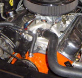

Chris, do you have a picture of how you hooked up you bypass?

This is a picture from Bryans chevelle as it is easier to see on his than mine. But you can see a little 3/8 hose coming out the front of the intake and than T's in the heater hose just behind the alternator.

I chased that with my camaro when I first built it. I did have to run a bypass from the fitting on the intake under the thermostat to one of the heater hoses to get the stat to open correctly.
That bypass hose plays a large roll in proper thermostat operation and removing air pockets. It is designed to circulate water within the block during warm up to prevent hot spots prior to the thermostat opening.

Put in the bypass as suggested. Temps are back where I would expect them to be. Did some adjustments for the shift points, seeing improvements, but still cannot get to shift into Overdrive? I plan on calling the transmission builder tomorrow and see what he says. 1-2 - 2000 rpm. 2-3 - 3200 rpm. Muche smoother shifts anyway.
