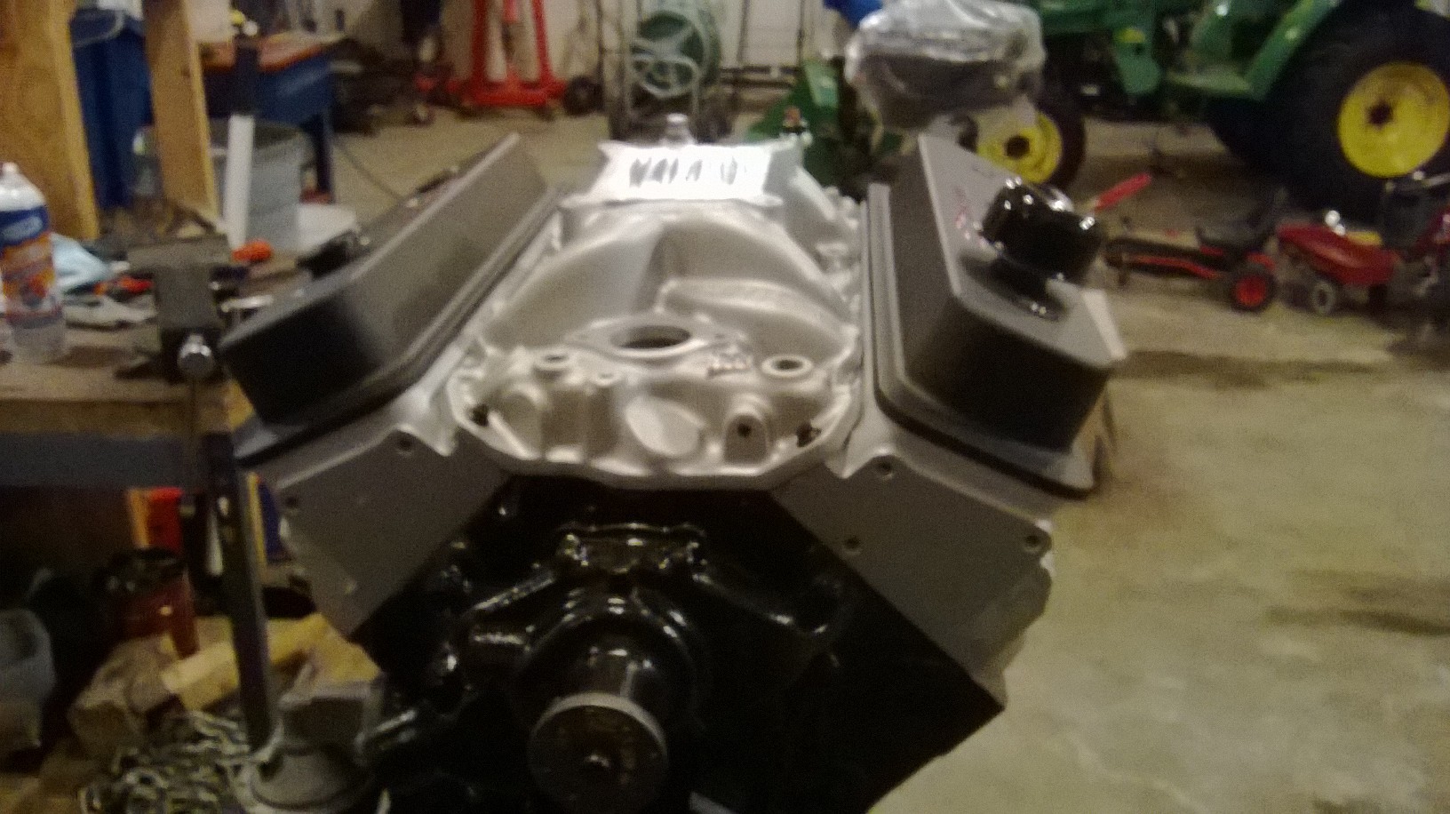

So I figured I would post a few pics of a motor I am building for a friend of Mike S (oscar). Its a 327 going into a 1966 chevy II. So some specs are motor is 30 over with balanced rotating assembly. Block was 0 decked, rehoned, and crank mains line honed. Heads are factory GM aluminum corvette L98 with just a good valve job and valve spring upgrade. Compression comes in about 10:1, camshaft is an Erson 220/226 with 480/480 lift and a 108 lobe seperation. Is going to have a very lopey idle but should make some real nice torque for a small displacement engine. He is going to dyno it so I will try and get the numbers and post them. If you look close in the background on one of the pictures their is another engine in a bag that will be going into somebody chevelle in the club.

Is the engine in the bag going to be painted a matching Blue ??..

Blue is a nice color.
