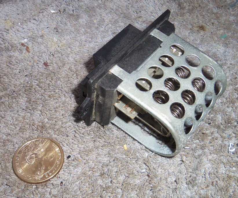

Had another addition to my "if I ever meet the knucklehead engineer that designed this I'll...." file. My daughter's car "Sally" had lousy heat, and only Hi-speed on the blower. The blower motor problem was easy - a new resistor pack and all 4 speeds are there. The heater core is another story!
