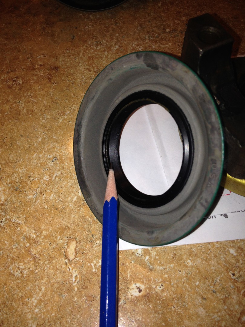

Another question I have is in reference to packing the area between the two seals with high pressure lithium based grease. Not sure what area they are referring to, is it the area indicated in the photo.

Yes, it is proper to pack/fill the recess between the seal lips with grease. One, to provide lube and prevent ripping/tearing of the seal lip on install, and two, to provide a buffer from the gear lube (which will eventually dissolve the grease) until the seal beds in on the new surface.
