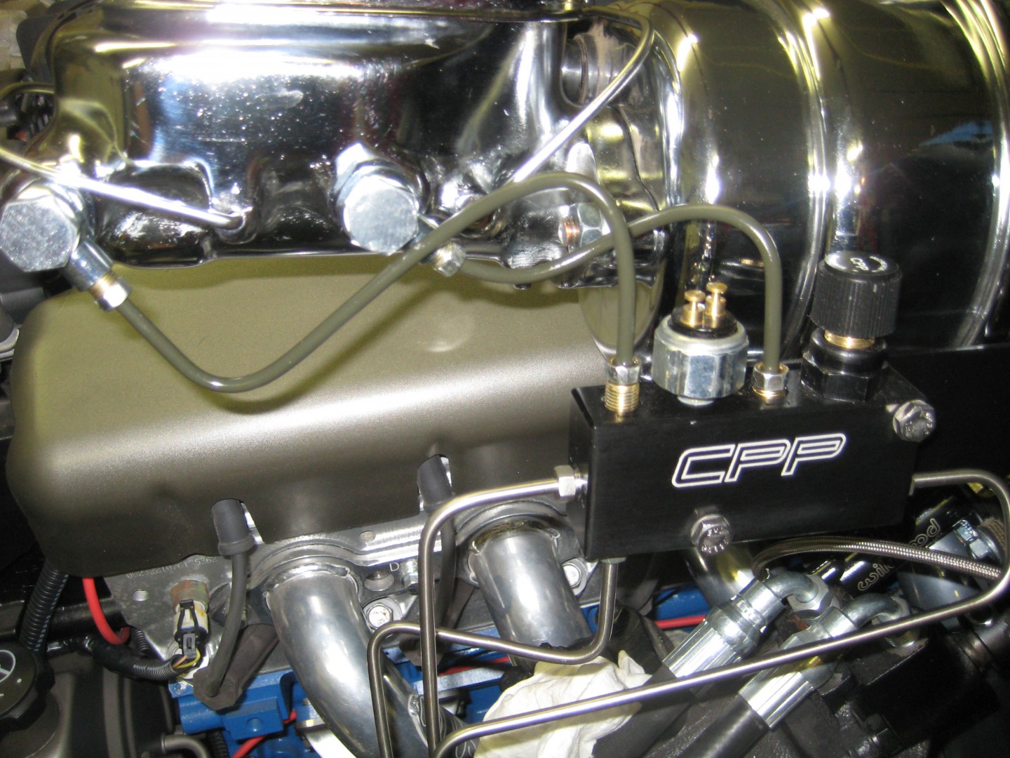

I am looking for suggestions with a problem I am having bleeding the brakes on my 57. The fronts have bled with no problems, but the back is not bleeding. I have the adjustable proportioning valve and 4 wheel disc brakes. I saw on one kit they switched the feed lines from the master cylinder to the opposite on the prop block. I have them hooked normal currently. Where should I have the adjustment set while bleeding? I have tried it out and in. I have tried with a hand bleeder and with my wifes help pushing the brake pedal. I have the e-brake adjusted close like it needs to be on the cadillac calipers. Any Ideas would be welcomed????????????

The Pedal has a firmer feel, but still goes to floor, I did adjust and re drill the hole in the brake for the proper ratio. The rod is in the starting position all the way back. I can get at it under the dash to make those kind of adjustments and see the back of the booster. I run silicone fluid in my rebuild cars. Not as hard on painted stuff. I will try messing with the proportioning valve and maybe switch that out if there is lack of fluid on exit side . I keep thinking thats where I need to focus.

Kind of funny this came up I just bought this brake pressure gauge kit a week or so ago.
I would also check all the lines you flared to make sure some flashing is not stuck in the line blocking the fluid.
Nice looking setup you have there.

I am still having issues with this brake system. I bought A new master cylinder to try that, but did not help. I have fluid at the calipers when I bleed the system. I have the cadillac rear calipers. I have the e brake I think adjusted correctly? The pedal still goes to floor. I can hear a what sounds to be a vibrating valve noise coming either from the master cylinder or prop valve. Should i have a residual valve??? I have never had a system give me this much grief. Anybody have a pressure bleeder???? There is no electricity involved in my old school system. Any ideas or if someone has some time to play give me a call

If the prop valve doesn't have any residuals built in, you may need one for at least the rears to prevent the fluid from back flowing out of the caliper.
