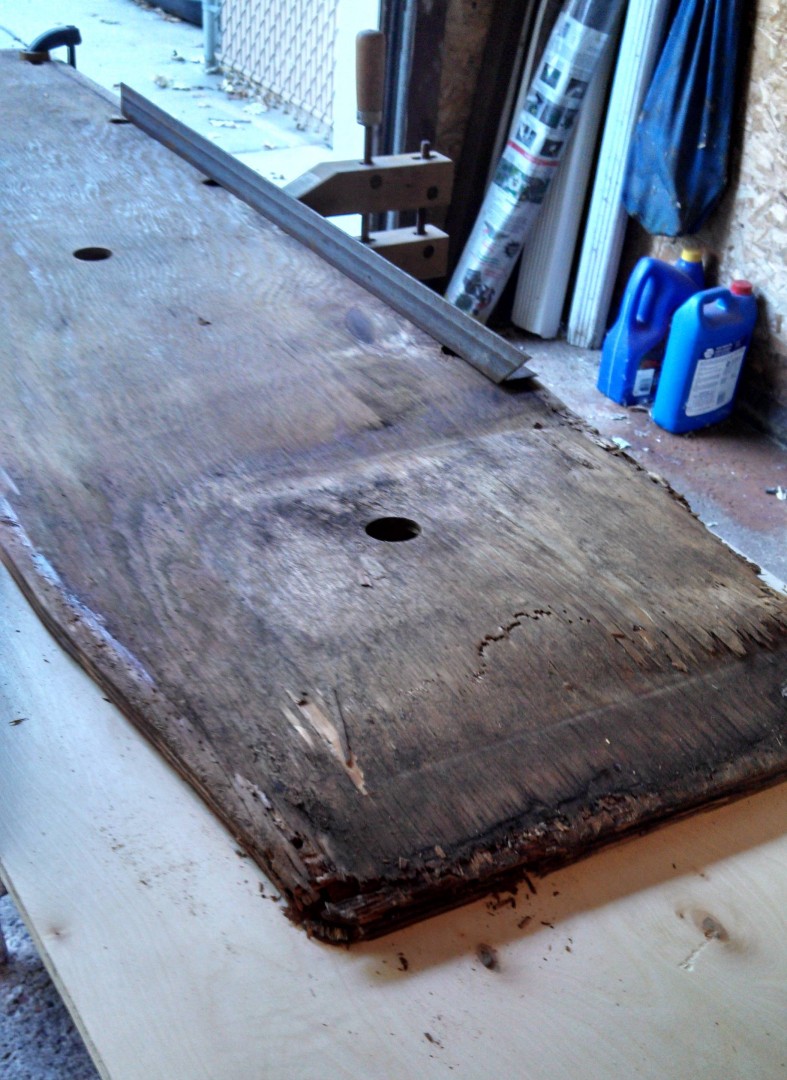

Having to re-do the seat base was a blessing in disguise. The biggest PITA with working on a boat is access to the engine. There is flat NO ROOM!! You are leaning over the seats/bulkhead, crap is in your way, friggindesignersneverthoughtabouthavingtoFIXanythingputcrapinyourway, etc... So I had to remove the plastic-molded seat base/cooler assembly & bulkhead anyway to replace the plywood base - which gave me un-incumbered access to the engine.
There was enough left of the original seat base (after removing 246,987 staples holding the upholstery on) to use it as a template. So, a few hours later a sheet of 3/4" plywood was carved into a new base. Got rid of some leftover primer/sealer, and re-upholstered the new wood... Then, I looked at the top lid/sun-deck... . Yup.. It was failing too. Oh well, I have a 1/2 sheet of plywood anyway. There was only 358,876 staples holding this upholstery on, so why not!

Yup, my basic carpentry skills & tool kit have been getting a workout. Then regurgitating the upholstery stuff I did doing Car-Fi 25 years ago! What's stupid is that Glastron didn't use P.T., treated, or even primed/painted plywood!! Just raw cheap-azz 5-ply junk.
I popped for 7-ply birch veneer, and sealed, primed and painted it. It should last longer than the boat.
