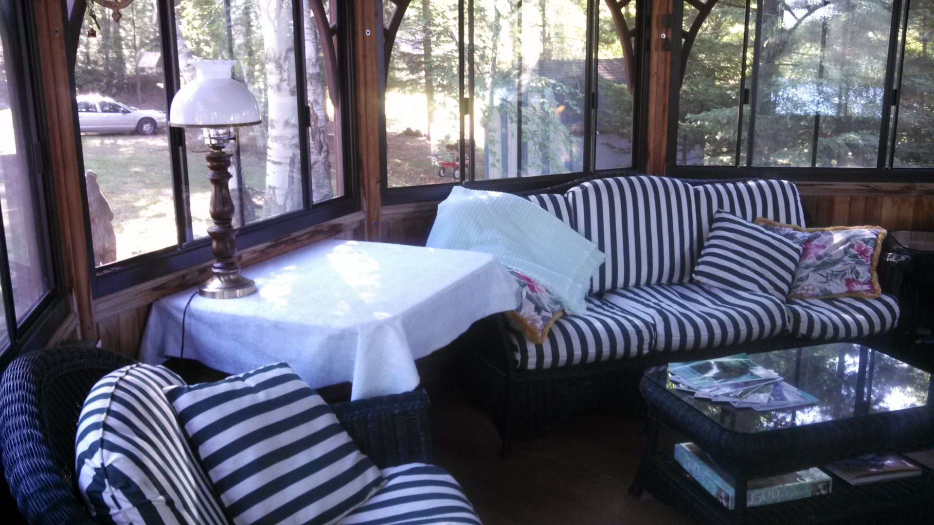

And of course there was "project creep". While the furniture was out, it got a thorough wash-down & cleaning. The window frames/tracks got scrubbed out, 2 screens were repaired/replaced, and the coach lamps got reconditioned.
