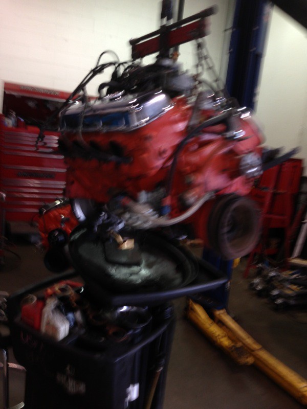

As some of you know the Engine in Biskwik is for my B/Block Elky 396 360hp/ holly carb. It was always intended to be temporary. Found a 41000 mile 454 motor out of a motor home. Unleaded fuel/peanut port/low compression.
Going in this week. Hope it still runs after I cleaned and painted it!
Will post more pictures as it progresses.

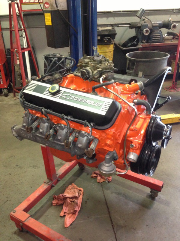

Congrats on the "new" engine. Hopefully, you will put the chrome valve covers on it to look era correct ??
If you plan to leave the trans hanging there and stab that shaft with the engine on a sling, good luck with that. That never works for me. I always pull the trans with the engine and mate them up on the floor.

I agree with your concern. Should be interesting to see how it works out.

Todays Update! Lining up the tranny (twice) was not the problem. Too long of flywheel bolts was. Different flywheel for 454 and flange may be thinner, bolts stuck out too far and hit block. Fortunately had some shorter ones in stock. Sorry Mitch, those are the valve covers I searched all over for just to use in this application. If I want bling I do have a chrome cover for the air cleaner. After all it is a plain Jane Biscayne! Karl
