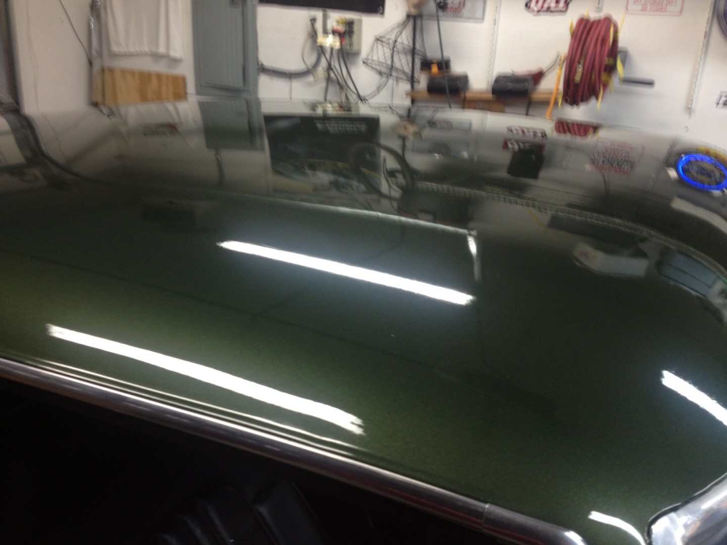

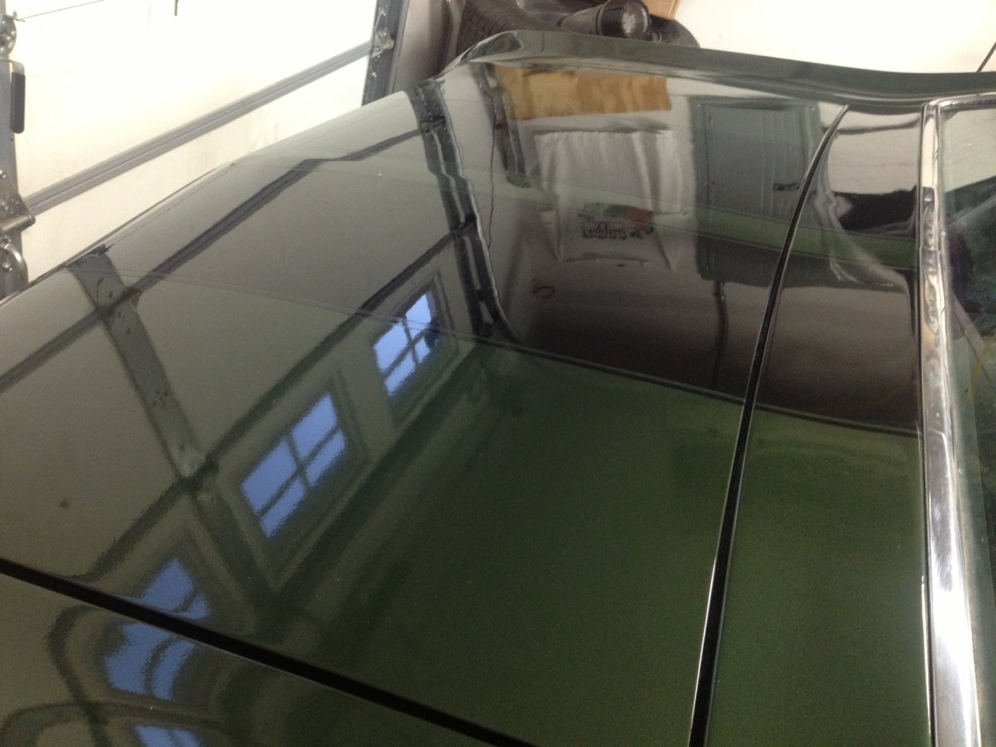

Last night I did a 3 step wet sand process starting with 1500 grit, then 2000, then 3000 grit. Pics below. Will be buffing out the paint tonight. Then tomorrow starting on the detail work in the engine compartment. But at least it is running and I have to say it is the quickest car I have ever driven. Will snap your neck and I didn't even hop on it, but for what I did, its all there. Not going to make it to Car Craft with it. Not enough miles on it and also I don't want to send anything un-finished. I have a vision for this thing and I am getting close.

I finished the exterior which consisted of a 3 step wet sanding from 1200,1500,3000 grit to buffer cutting, polishing and sealing. I will wax it tomorrow after the sealant sets in. I thought it came out pretty well considering the paint job is kind of crappy but it will save me from having to paint for a while....
