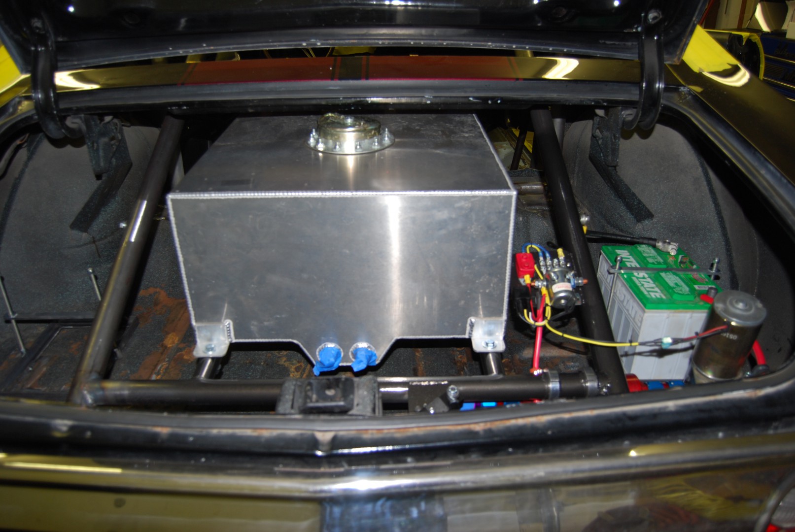

It is the 72 Chevelle. I wish they made a red and black spatter but I could not find it. The cage part I am painting "Hamered balck" from Rustolium. It appears the trunk is Aqua-Black now. The pic attatched is not the best but I hope it gives a good idea of the color.

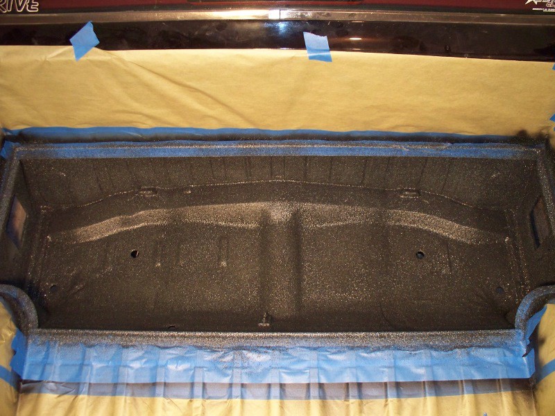

Here’s the 65 Buick color.
