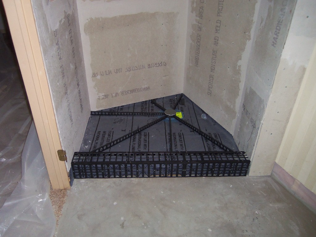

Last weekend I blew out the pre-fab shower enclosure, ripped out the walls, and chiseled off the old floor tile.
This weekend I've reframed the shower wall, installed curbing, set a new drain assembly, and just poured leveling compound for the proposed tiled shower enclosure.

Man, that stuff is neat! Hard as (duh) concrete and dead-smack level from corners to corners.
Believe it or not, there's 5 GALLONS/50 lb sack of "stuff" in that space (about 4' x 5').
What's totally stupid was the level of the original concrete floor!
In that +/- 20 sq.ft. area, it varies in slope (from level at the drain) between 1/8" to nearly 3/4", gauging from what is left exposed on the 2x4 sill plates. The new drain was set/glued in place (level) where one spot of the rim contacted the existing floor. (I'll assume that about 1/2 gallon poured down and filled the hole I had to carve out for the new drain assembly but GEEESZZZZZ!)
I think my basement floor was poured & floated on a Monday or a Friday!

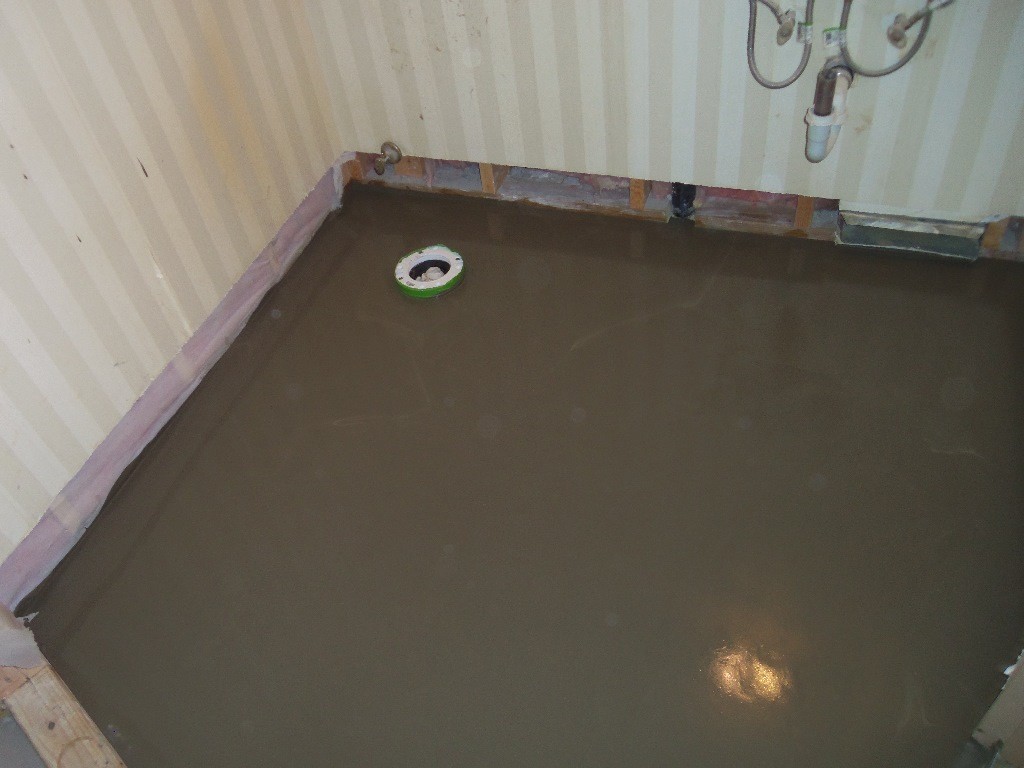

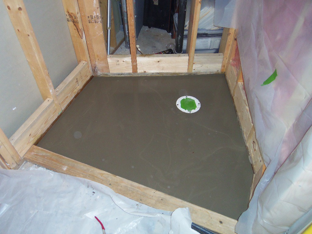

Well, the "pre-pitch" is down, and now imbedded with 60lbs of "sand mix". Sheryl is "Paper Tiger-ing" and DIF'ing the walls (old wallpaper). Looks like tomorrow will be laying the vinyl membrane and then "Quick Pitch" for the final shower floor.

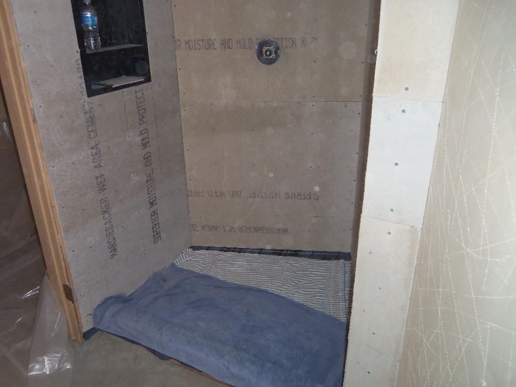

Update: Started around 8:00, and have accomplished... building the curb, installing the shower pan, the drain fitting, temp'd in the shower caddy insert, and moisture barrier. Time for a sammich, and then lug the cement board out of the car and downstairs... ugh.
If I see another sheet of DuraRock/Hardieboard it'll be too soon. Great stuff, but a PAIN to work with - hard to cut, heavy, needs "special" screws (at $8 a box of 150). But, the shower stall is rocked.
Next, pour the final floor and mud/tape the seams.

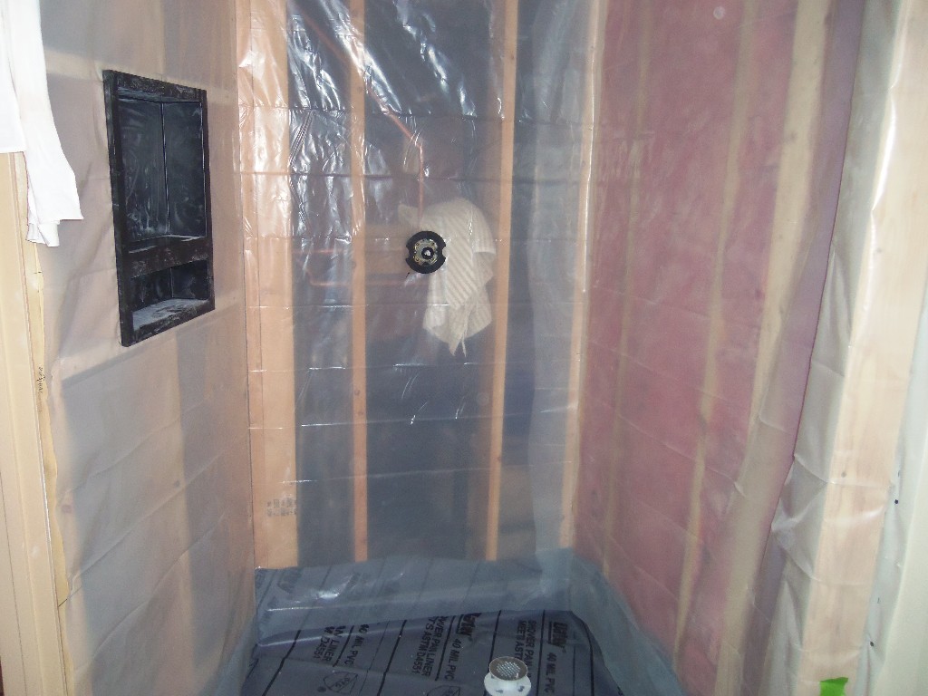

Got done an hour early today, and got started on the final phases of the rough-in. The joints are taped and mudded, the final "Pitch Sticks", and curb forms are built, and the drain weep-hole protector is installed.
After dinner it'll be mud time again, and pour/screed the final floor!
Looks like it will be nice but a LOT more work than a ready panel stall. You're far more ambitious than me.
Apr 10, 2013
That's what was in there before, a "neo-angle" pre-form pan, walls, and glass. Since the room is a funny shape, there was this wasted, wedge-shaped corner with it. Now basically the entire end of the room (from the doorframe, south) is all shower.
It's framed for a standard 48" wide glass shower door insert, but we are considering a custom frameless glass wall & door. ($$$$)
(Had a great surprise when I got home today. Sheryl was stuck on a multi-hour conference call (which she had to attend/listen in on but not contribute to). So the wireless headset went on, and she got all the wallpaper stripped off!! )
I've never done a "poured" shower pan before but thanks to YouTube, I was able to watch about 10 videos about it and convince myself "I can do that...". I've done all the tile-work in other remodels around here (I actually like it ), so that isn't an issue.

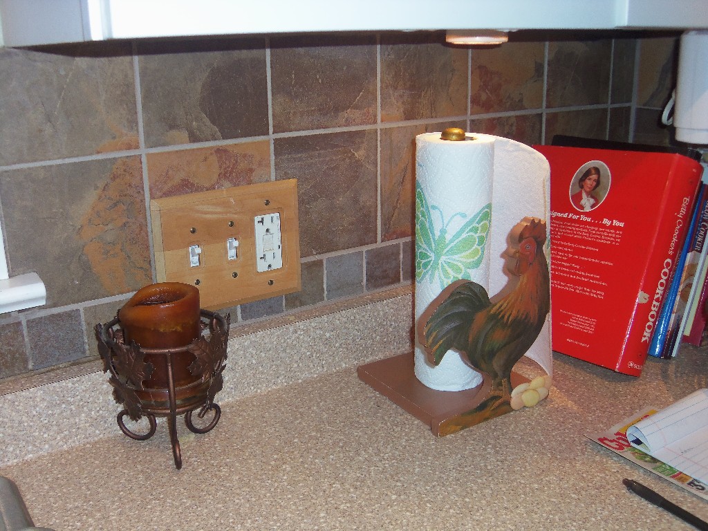

(Kitchen backsplashes are a bytch... tight quarters and all the work is vertical. Setting isn't bad, but grouting is a pain in the back).

No, I haven't been slacking off.. just a few things (like the April Club Meeting...) took some time. Started this AM with the wall on the left, then after a sammich got to the wall with the shower valve. (waiting for the mud to "set", then I can move the left ledger to the upper 1/2 of the valve wall)
(another "cheat"... use the little plastic spacers!)

Nice kitchen tile. I wanted to do that a few years ago but got Vetoed. Probably saved me a bunch of headaches.

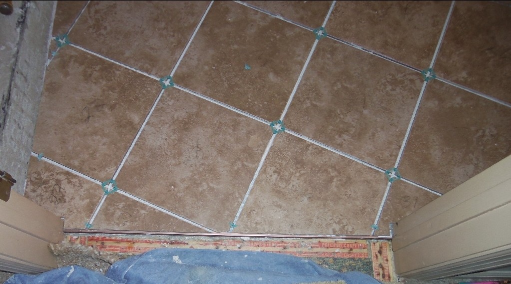

Got started on the floor this morning, then went out to "Mom Seitz's" and met Dave. Spent several hours disassembling the boat lift and loading on a trailer, then back home for more floor.
Got everything cut and "dry fit". Tomorrow morning I'll pull it all off, thinset, and stick! Then since I can't walk on it for 24 hrs, I get to do yardwork!!

These pics don't appear to be too much different than the previous one, but the tile is now stuck to the floor. I gotta tell you... invest the time and do a "dry-fit" on a room/job with wierd angles, or if you're doing a diagonal/diamond pattern. Then make yourself a map of the floor, and number the tiles & map. When you set them, it's just a paint-by-numbers gig then - they go back exactly as placed.
The spacer gizmos I'm using are totally cool! One side is 1/8", the other 1/4". Made of reasonably rigid plastic, they just push in place and maintain the grout gap with no fuss.

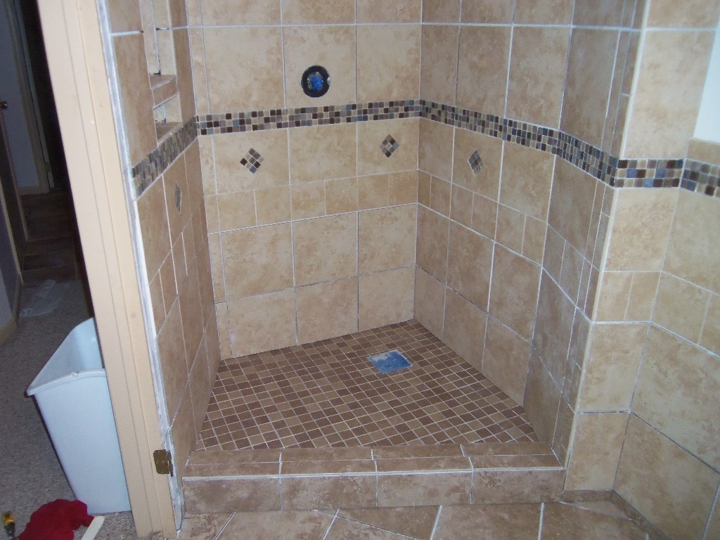

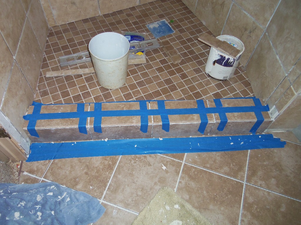

Did the shower curb last night, and then the bottom course of 1-3/4 walls tonight. If things stay on track, I should be ready for grouting this weekend

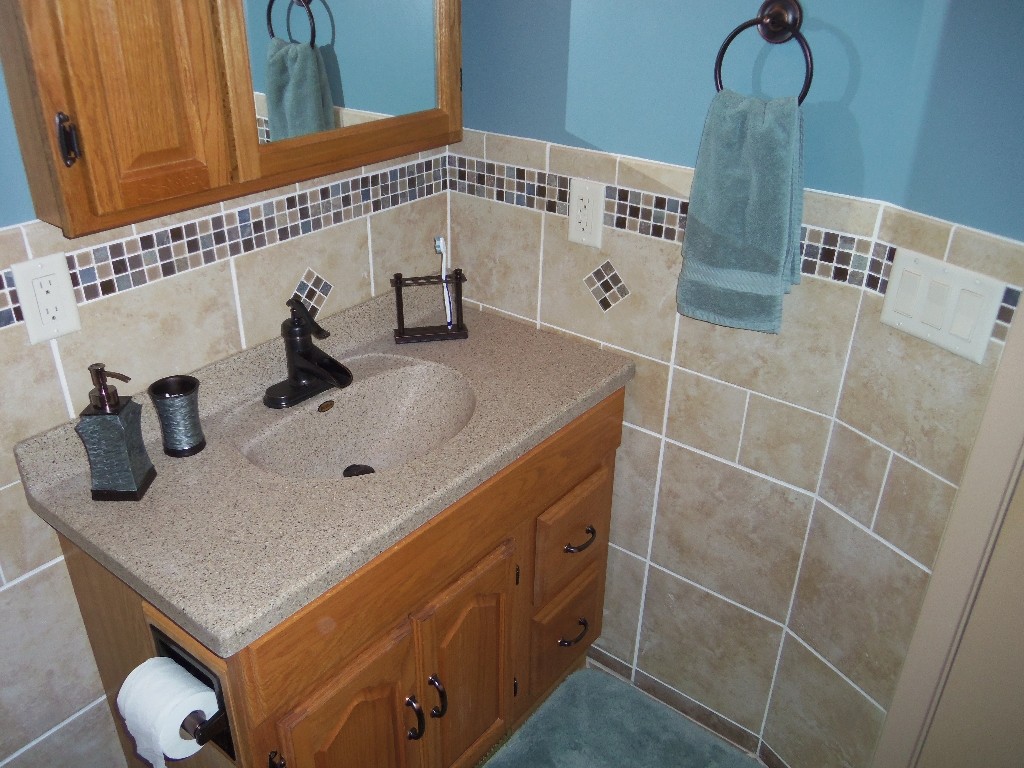

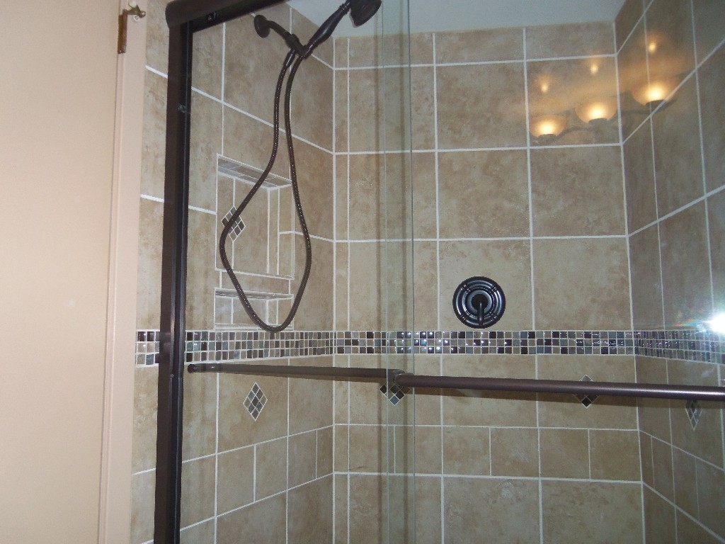

Well, a 12-hour marathon session yesterday... and the walls are grouted! The seam at the top of the shower stall, door casings, and the stall to wall will be done in sanded color-matched caulk (expansion/contraction issues). Sheryl has procured the replacement outlets, switches, cover plates, and paint... target is to have (at least) another functional head by the weekend...
The King has a throne! (not a "Furguson", but a Kohler that has some serious "baaaawhooosh" )
Would've had the vanity top & fixture(s) installed, but the top was cracked (in the box) when we got it home. Sheryl's going to get another tonight, and I'll be installing the shower doors this afternoon, then tonight the vanity top.
(The wall color is keyed off of the stone segments in the mosiac. It's that estrogen thing about "coordination" and "accessorizing" that testosterone overrides. I see in 8 colors and "peach" is a fruit - Sheryl has the "eye" for this stuff - she envisions, I build.)
The cabinetry is the old stuff from the original bathroom. It is good quality stuff, and well made - and it ties in with the new color scheme - so we saved it. I've got a bag of new knobs, pulls, and hardware in "oiled bronze" that will match the new shower & faucet fixtures.

I LIKE the Blue paint !! The Oiled Bronze shower fixtures go well with the Sahara Sand tile color....

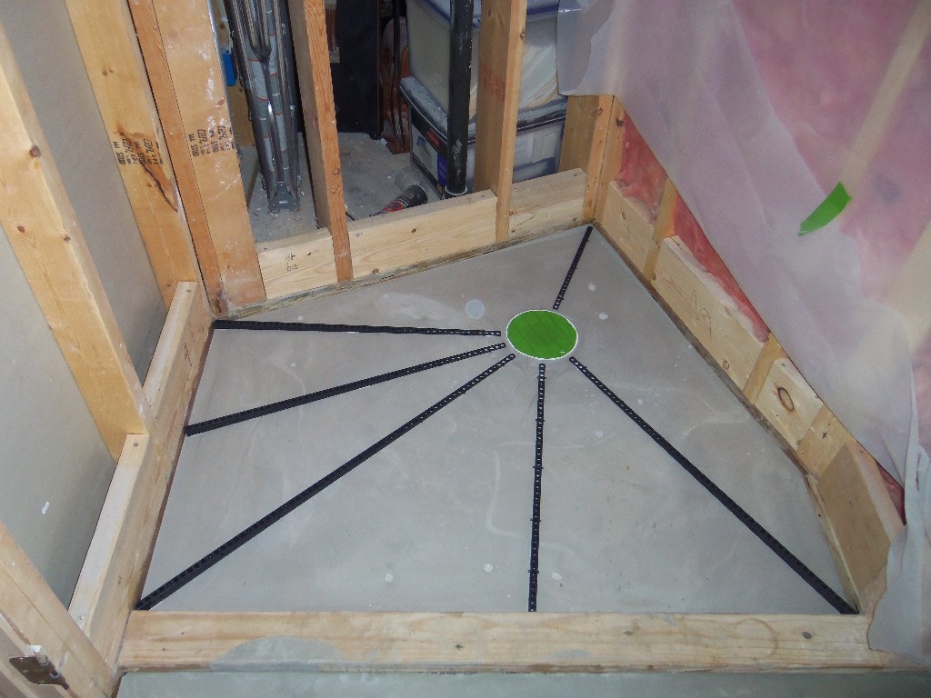

Mud's down.
Those pitch sticks & curb formers are the only way to go!

It's getting close... 90% of the walls are done, and I'll be working on the floor layout & setting today. Once the floor is done & set, I can do the last course of wall tile down to meet it.
Sheryl's got the commode, vanity top, wall paint, fixtures, and even the towels either "in hand" or on order!
Hurry up.....Buick show and swap at the Fairgrounds on Sunday !!
Cut & stuck the LAST PIECE of tile this morning!!
That "niche" for shampoo & soap is a beeyatch... 18 pieces of tile in each compartment!
Grout tomorrow!!
Tonight... the floors!
Getting really close now!!
-- Edited by John D on Tuesday 14th of May 2013 03:51:42 PM

The shower doors are in but edges/seams not caulked. I'll do that tomorrow after the sole plate has fully set.
IT'S DONE!!
Sealed, Caulked, Towel Bars/Hooks, Accessories... Done!
(Now I get to clean up the rest of the basement... and then try out the shower to clean me up!)
