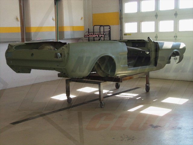

I know.....it's a Mustang and one that should've been parted out and crushed BUT the owner wanted it brought back from the cliff.

Looking great! Are you going to finish everything, or just the metal work?
Jan 29, 2013
The owner drove the car to the shop 9 years ago. Once the metal work is complete, we will see if he wants to take it to a paint shop before I put the engine/trans and interior back in. I'm assembling the front suspension this week.
