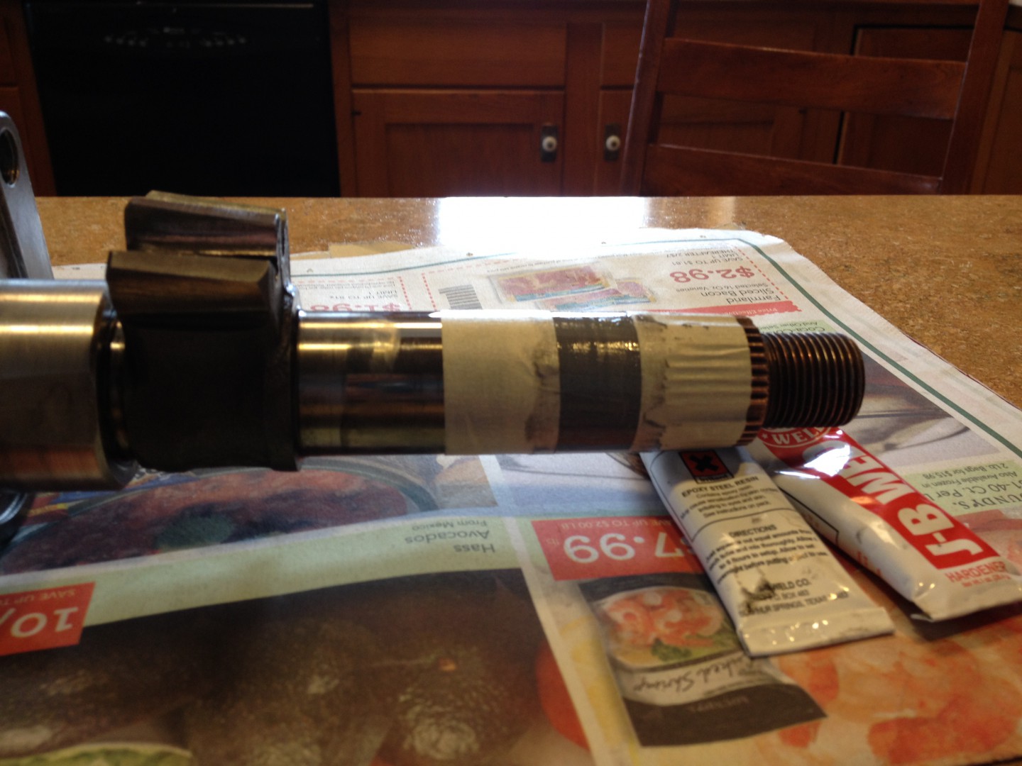

I wonder if this is going to work? It had been leaking due to rust and croosion. I cleaned and cleaned, applied with a razor blade, will sand with various grits of sandpaper. If it sticks it should work. You can buy new shafts; but they are very expensive or find an old 66 or later PS gear with a good shaft. But I thought I would give this a shot.
I guess you could by a sleeve and install it after setting the shaft in the gear; but then you wouldn't be able to take the gear out again without messing up the bearing.
JB should stick, and as it's not a load bearing surface, should hold up as a sealing surface. The only trick is get it back to round/concentric. Can you get it chucked in a lathe and "spin" sand/polish/machine the new surface? (the OEM center holes should still be there).

I was just thinking about sanding by hand. A lathe would be a lot better, maybe I can find someone here in Lake City for that. I am pretty sure one of the local machine shops has one. The center at the bottom is there; but would you have to take the threaded post out of the top?

Jim, You might try a farm implement dealer with a shop. We’ve used them on the farm to repair worn shafts on our combine and tractors. Usually less expensive and faster than waiting for the wrong part to arrive.
