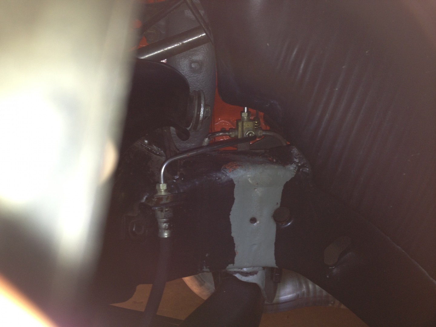

Looks like I need to replace or repair master cylinder??
Nov 27, 2012
The seals are leaking internally. If it is the original and you want to retain it, you can send it out for a sleeve and rebuild. Otherwise, you can get a rebuild kit, but many times the bore is pitted and will still leak afterward. New ones are available that look just like original. Try http://www.inlinetube.com for a new one.

Looks like the brake fluid eaten away some paint. Not positive; but think it is comming from the master clinder and then drips down onto the frame. I don't think the fitting is leaking. Is there a repair for the master cylinder or do I have to buy a new one?
Has anyone else experienced this problem? Is there a paint that is resistant to brake fluid?

I suppose you don't know how pitted the bore is untill it is disassembled. It looks like the place Chris mentioned can re-sleeve the bore. Besides Inline Tube, the Right Stuff also carries repoduction MC.
