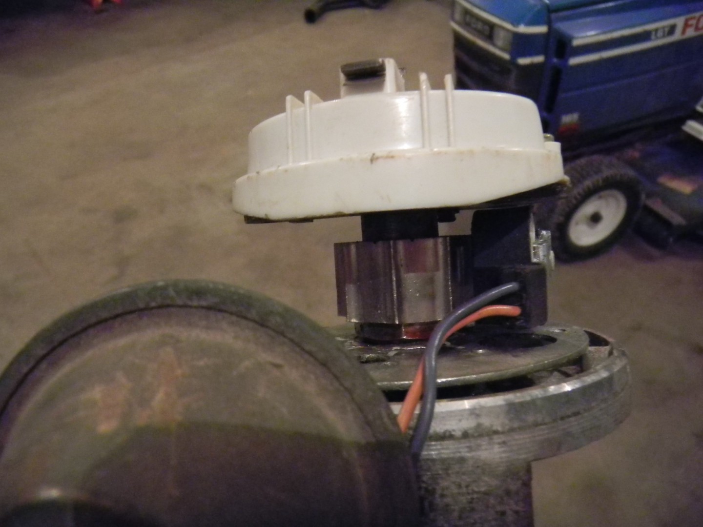

So I got some time to work on this while I was off last week. I got to working on it and forgot to take pictures. But here are a few of it so far. Everything is more or less mocked up I just need to take it back apart and clean up things better.
Bringing this back from the dead. I killed the pertronix conversion in the 55 yesterday. So I decided to see if this conversion was actually going to work or not. I dropped it in the but no spark hmmm. Pulled it back out and started doing some bench testing and determined the used ignition module was not working. Grabbed a spare HEI I had on the shelf (thanks to kevin) swapped on a different module and oh baby we had spark. Dropped It back in the car fired right up adjusted the timing and took it for a drive. Now I have to decide to convert his distributor or get a pertronix II for it.
