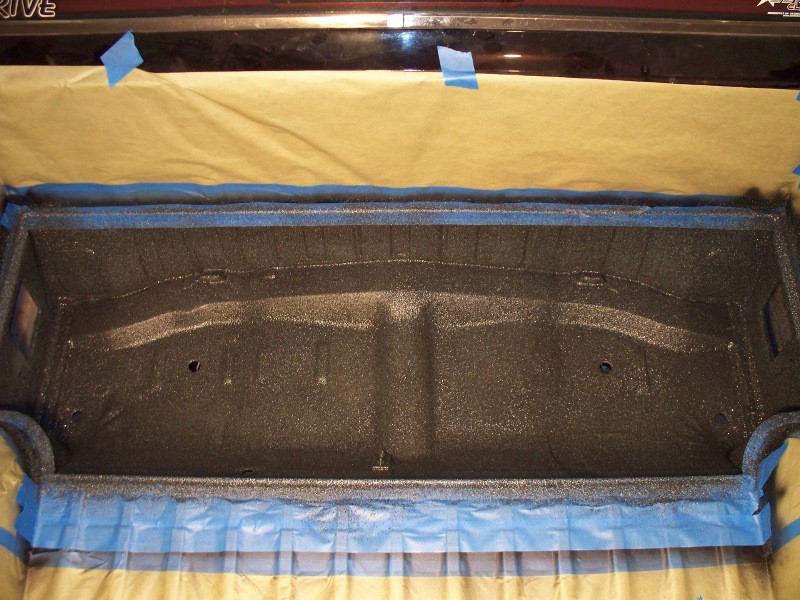

Some more on the rattle-can splatter paint... (NAPA has it, btw)
It comes out of the can like a firehose! Waste a bit (on your test panel) to get the feel for the spray & can.
Do a very good job masking off what you don't want splattered! (see pics - to get nice light coats & no runs, I had to be about 14" from the panel, and "modulate" the spray button. It goes everywhere!)
It takes 4x plus the time listed on the can to fully dry!
