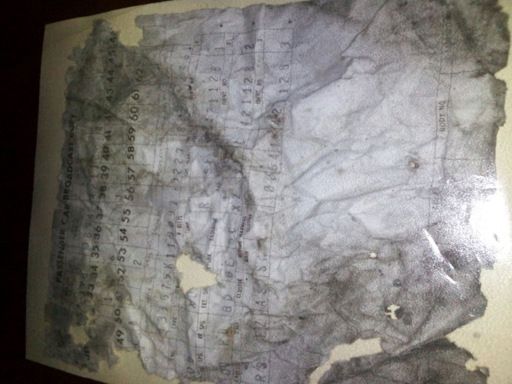

Nice find on the broadcast sheet. They didn't have build sheets in 65, just broadcast sheets stuffed here and there.
