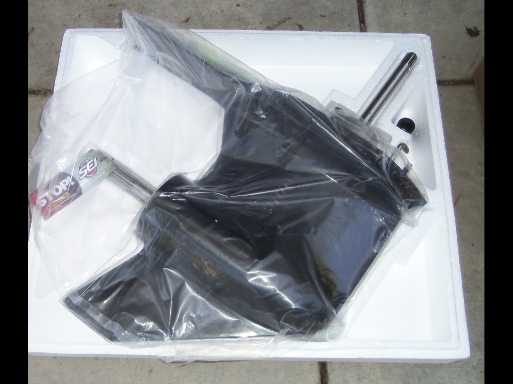

I had two boxes waiting on the steps for me today!
This really is a simple job - anyone with some basic mechanical aptitude, basic tools, and the smarts to watch how it comes apart can do it.
6 bolts (two are hidden, 1 under the trim tab fin, the other under the anode plate) and the lower unit basically falls off!! (Ok, it took a thump with a rubber mallet and a light tug...)
If you don't count the time it took (being my anal-retentive self) cleaning bolts, chasing threads, blasting the anode plate & trim tab, and "dry fitting" it twice... total time was 1-1/2 hours, and I've never done this before!
Pumped 36 oz. of gear lube into it, hooked on the "fake a lake" muffs, and vroom - fired right up. I let it run about 30 minutes in forward, then another 15 in reverse. No noises, heat, or leaks!
The mfg. wants 5 hours of "slow-time" (under 3500 rpm) with at least 10 forward/reverse gear changes, then another 10 hours at no more than 75% power, then 5 more with some full-power holeshots then back off to 75%. After these 20 hours change the gear lube again, and it's good to go.
