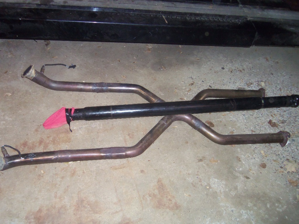

Probably glad you put those flanges in the exhaust now. I'd be cutting mine at that point...

I've got to give credit to Derek for the "rear flange" idea. I've already utilized the convenience twice - to drop it for the 02 sensors, and now! Anyone running an "X" or "H" pipe setup should do this... you may never need it, but WOW it really makes things easy (and inexpensive) if you do!

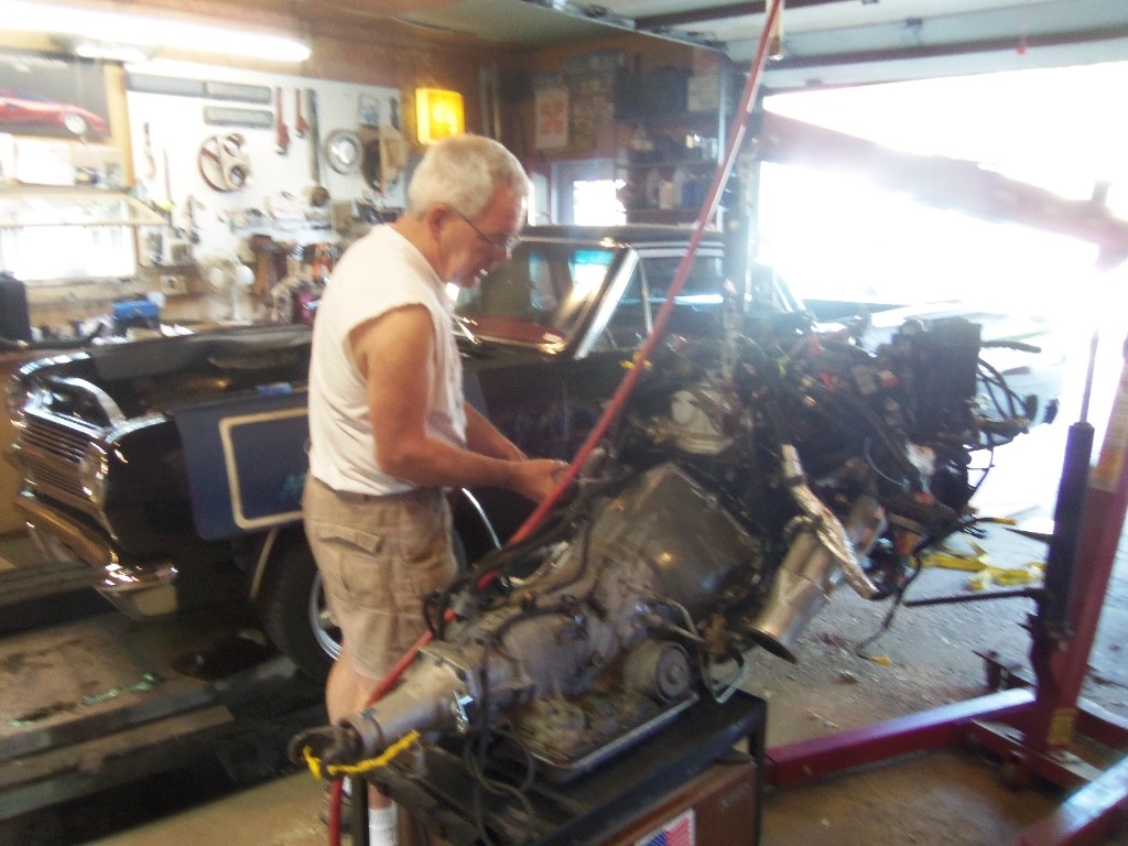

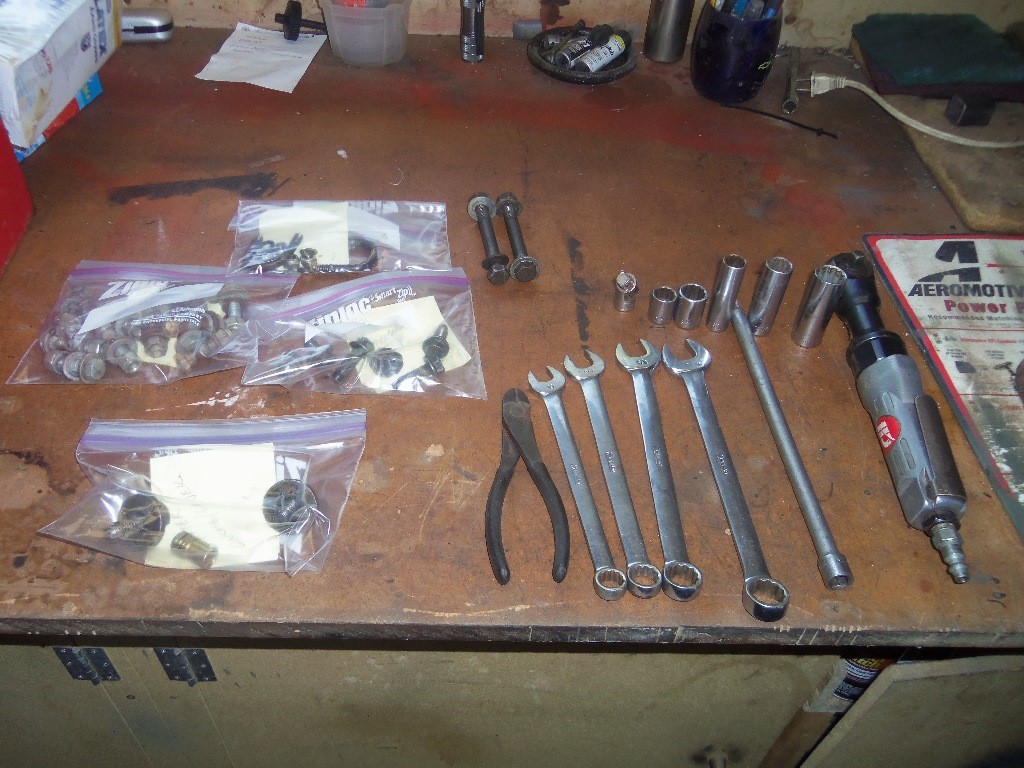

Got some "quality time" in the shop this afternoon/evening... started around 4pm and just came in.
4 things left to do, and it can be pulled:
Unplug the electrical connectors in the car (too dirty for interior work tonight) and dismount the bulkhead connector
Remove the coil from the driver's cyl. head (front)
Remove the hood
Attach the lifting slings
I am so glad I spent the time "imagineering" this thing on the initial build. Stuff just unclipped, unplugged & unbolted at the major attachment points, and it will come out of the car as a "power unit". (All of the accessories "crap" will have to come off the engine eventually, but it's a whole lot easier when it's bolted to a stand!)
Everything's tied off and capped/plugged, so other than some coolant (I couldn't get the friggin knock sensors/block drain plugs out) the engine's dry.
I've got the pan plug out, and it's draining now. I'm gonna confiscate a pair of pantyhose from one of the women around here, stretch it over a funnel with a bunch of magnets taped to it, and see what sticks...
A shout out to Dashboard - he came over this afternoon/evening and gave me a hand pulling the engine. Everything went smoothly, no damage and no forgotten bolts/clips/wires/etc.

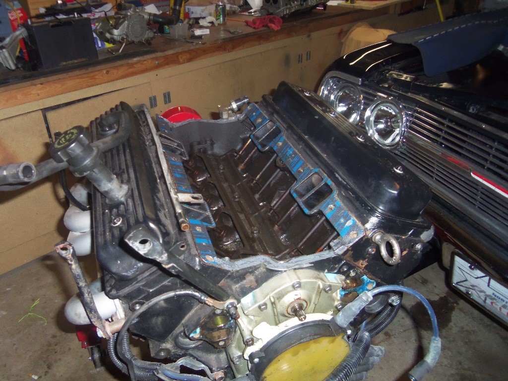

Separated the trans from the engine and got it on the stand. Now the fun starts. Pulled the pan and found out the source of the noise.

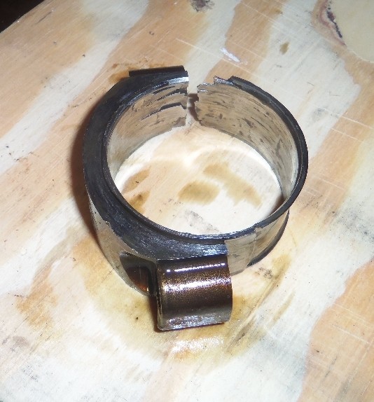

It would appear that a crank/rod/piston kit is in my near future. I've spun a rod bearing or two... #8 let go, and as collateral damage took out #7.
So now the real fun begins. Clean the garage, and start the tear-down. Mic the cylinders and order a kit.

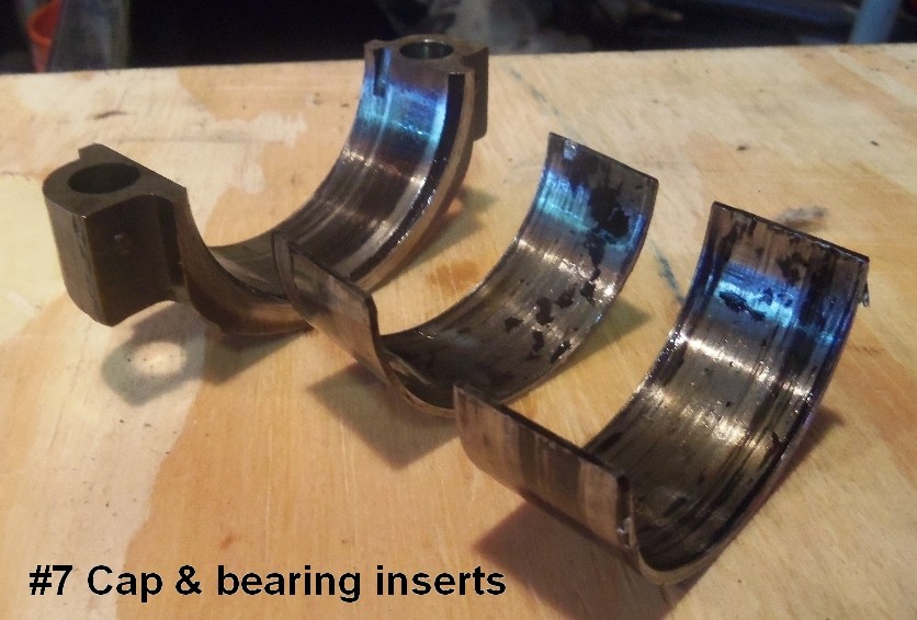

As suspected the carnage traveled forward from the 7/8 journal to the #4 main journal... it spun a main too (a line bore/hone was NOT in the picture for this rebuild).
Once I popped the intake off and saw "sparklies" in the lifter valley I knew things were not good. Further disassembly revealed damage in gradients as you go forward in the oiling system.

I know #7/8 journal is toast, and the two rods - so at a minimum I'll be doing a crank and two rods. This is a minimum budget project guys...
I gotta say, that was the strangest knock for a spun bearing that I've ever heard !!!! I never guessed it was that bad, especially with oil pressure....
Stan and Enganeer said they would cover me. Thanks guys.
Looking at the pics, it was just on the verge of the nasty "steel on steel" hammering sound, and catastrophic failure. There was still enough bearing shell left to maintain an oil passageway to the next journal, and being the 2nd in line from the pump it had plenty of volume available. I'll bet there will be some signs of oil starvation as I go forward on the crank.
Anyone need a boat anchor?? I've got a really heavy one, cheap!!

I've got a lot of work to do before "stab it in day". The shop's a MESS, and I've got all the prep work to do mating the gearbox to the engine, then doing a mini-detail on the engine compartment, and getting stuff ready. I'll put a shout out when I'm ready..
Either you work short days or you have more ambition than 3 people......
After doing field service & installations for 20+ years, and fixing other people F'ups, I was determined to engineer this build with serviceability in mind. The nice thing about it is you don't remove anything from the engine to pull it... just disconnect plugs & fittings and remove everything as a unit. Plus the fact I built the thing, and know every bolt & nut (by size) on it speeds things up.
Examples:
Airbox & Computer - 2 bolts, 1 screw, 1 clamp, 5 connectors, lift it out.
Radiator & Fans - 4 bolts, 1 connector, 2 clamps, 2 fittings & it's out.
Entire Engine bay wiring harness - 3 plugs in the car, 2 screws and the harness is disconnected from the "car", battery cables from the battery posts, 2 ground wires to the body & it comes out with the engine.
Fuel System - 2 "quick connects" at the manifold... done.
Fluids - 2 fittings each for steering (at box), trans (at radiator), and oil (at rad support). Hoses/lines/pumps stay on the engine assembly.
I ran out of "stuff" to reconnect tonight, so the topside must be done. Tomorrow will be under-car stuff - converter to flywheel, inspection cover, mount bolts, driveshaft, e-brake cable, and exhaust.
Should be able to fill it with fluids and fire it tomorrow afternoon or Sunday AM.
IT'S ALIVE!!!
A shout out to "Dashboard" who came over and spent a good part of his saturday reminding himself why he bought a lift!!
Got all the underside "stuff" bolted on, filled fluids, and fired it up!
After spending about 4 hours cleaning up the shop & hosing down the floor, I cleaned myself up and put about 50 miles on it tonight. I am one happy camper. The engine runs great, and the new transmission is perfect. I'll do more ever widening circles tomorrow then sign-off on the job.
