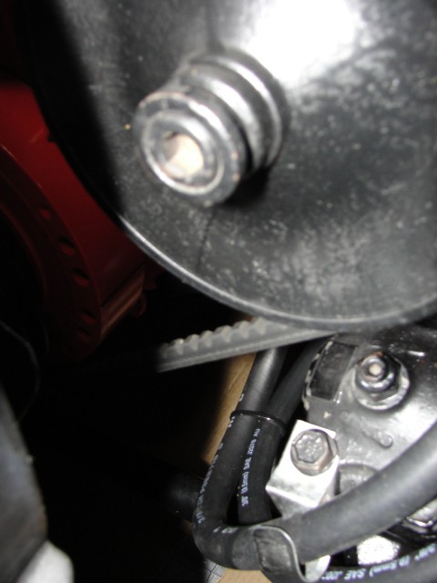

I haved to change my power steering pump on my '69. Current pump and bracket appear to be maybe be out of a 70-72 car. Unfortunately I am out of state on family matters and can't post pics right now. To the problem: I thought the end of the power steering shaft holding the pulley on had a nut on the end. My pulley looks to taper and extend out from the center and has an allen screw, probably 7/16" in the end. Has anyone changed a set up like this that could advise how the pulley is secured to the shaft and how do I remove it? Thanks. Jon

Chris, I think he should be able to remove the pump and pulley as a unit then remove the pulley.

If it does not have the nut holding the pulley then it most likely is a press fit. There is a tool for pulling and installing the pulley. I would bet you could borrow it from Orielly's but if not I have the tool and you are welcome to borrow it.
When you get home look closer inside the end of the shaft there should be threads in there for using the tool.

I’m posting these for Jon, pix’s of his power steering pump pulley setup.
Yep that is the press on style will need the tool to remove and install it.

I have the tool as well but the fan and shroud would have to come off to get the tool on. It looks pretty close in the photos and may interfere.

Thanks Kevin for posting and all for the help. When I get home I will pull the assembly so the pulley can be worked on out of he car. I will try Orielly's first and if not then I will be making a phone call for a loan, thanks. Jon

I also have a puller if you need one and I'm not to far from you. Let me know if I can help.

You can do that but you have to unbolt the bracketry off the engine and remove the pump and brackets as an assembly. However, 69 had a few things that were one year only on the bracketry so im not sure but often times, the bolts that actually hold on the pump itself, are obstructed by the pulley.
I find it easier when working with the pulley removal tool. To just have the pump secured on the engine. Otherwise it has to be secured in something like a vice.
