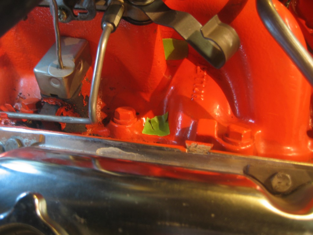

Take a look at the photos. One shows oil. Other shows where I wiped up similar pools of oil.
I think it is oil from the MO I add to the gas or from the blue stabelizer that I added for winter storage.
I think it is leaking and the gas evaporates and the oil remains. Looks like I m should try a new manifold gasket and maybe a gasket on the accelorator pump and maybe a thin gasket between the Stainless Steel baffel and the base of the trottle plate.
What about adding a thin layer of the high temp RTV to help seal things up?
Your floats were not sealing 100% and slowly leaking over time. If you run it, check the next day or so by pulling off the carb and seeing if there is gas on the manifold / carb gasket. My eddy was doing this.

Well I went out to look at the carb/ intake and there again was the oil/gas in three 4 spots on the intake. Gasket between the throttle plate and baffle looked wet, so I took the carb off. Gasket all wet along with the SS baffle being wet.

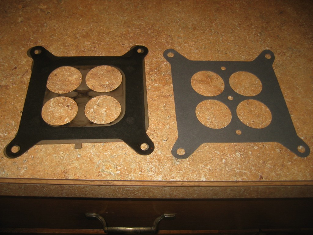

So I guess that would mean fuel running into the main body and working its way on the the SS baffle and to the outside. Think I have the wrong gasket between the throttle plate and SS baffle, so not sure if that would allow gas to collect on the baffle and work its way to the outer edges of the gasket and then leak to the outside. I had a gasket for I think its called something like squarte port., as it has a large square cut out of the center. Think the gasket is suppose to have 4 holes to match the bottom of the throttle plate. Maybe this is the problem?

Here is a photo of the gaskets. Also after an hour of being submurged in gas the float have not taken on any gas.
